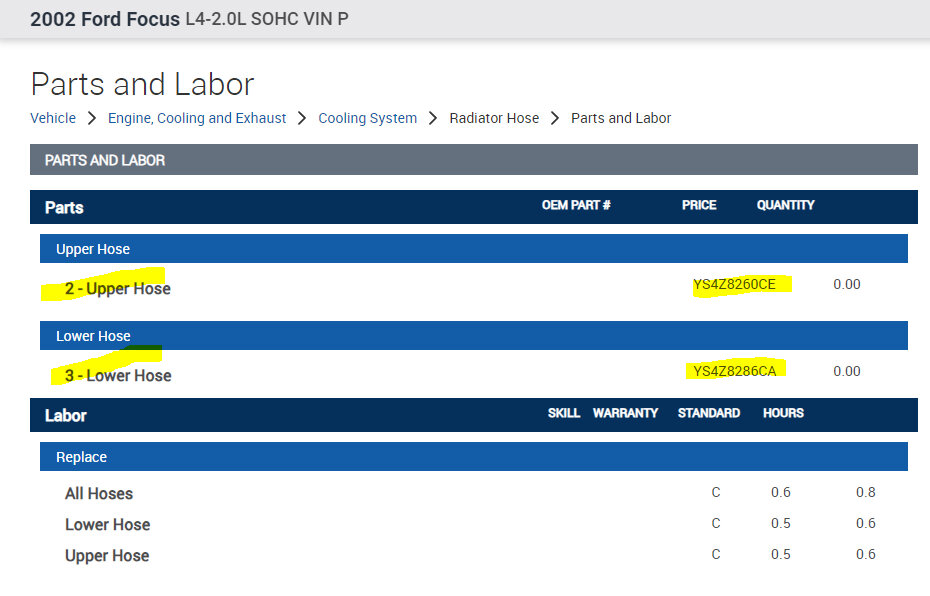

Could this be the part number YS4Z-8260-CE, but the bore is large. Do I need two for the 2 openings. I also have the premonition to change the lower radiator hose as the pipe is compressed. I want to skp as the OEM is very costly but don't know if the skp can fit in very well. I am trying to find a link to chat customer service in rockauto. Com but can't get it. Thanks, I appreciate your efforts.

Lower radiator hose.

The lower hose does look like it needs to be replaced. I attached the OEM part numbers for the upper and lower radiator hoses below. As far as the hoses from the reservoir are concerned, there is no listing for them in my manual. However, that really isn't a specific hose. You should be able to remove them and have a parts store match what you need.

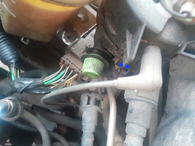

MAMIRORO SMITH
  • 83 POSTS

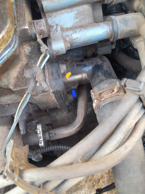

Good day sir! I just discovered that one of the pipes of the thermostat housing has not been there. I have now known the source of my confusion about the hoses LOL. In the end, the car must still drive if someone has damaged it. I don't know the choice to make between Dorman, Motorad and SKP for the thermostat housing unit with the sensor. Does cleaning agent like liquid molly work? In the attached image is another metal pipe identified with yellow. Where does it lead to? I can't find the brake level sensor cap. Can the car work well without it or will it affect the electrical circuit? Can I still apply the same discount code because I have made an order of the lower radiator hose and pipe already. Thank you very much for being amazingly supportive. God bless you richly.

3M5Z-8K012-BA is this the right part number from the expansion tank to the thermostat housing.
Saturday, December 2nd, 2023 AT 8:00 AM
  • 109,896 POSTS
I believe that the pipe runs to the heater core. Do you know if the heater worked before now?
As far as the parts are concerned, I have always had luck with Dorman parts.

MAMIRORO SMITH
  • 83 POSTS

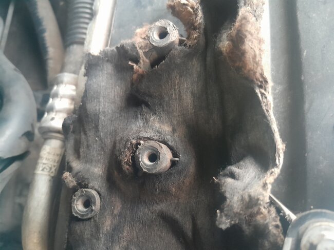

Greetings boss, I just observed now that the EVAP hose is broken close to its attachment. Where does the EVAP pipe lead to? Can the car function without it? Kindly help me identify the hoses and pipes that go into those places identified. Does anything supposed to be on firewall that was removed without those pipes looking agape. Thanks for all that you have been doing and God bless you.

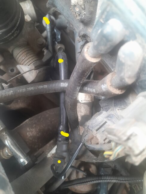

What name or part number can I use to search for the hose/pipe from the vapor canister even if it has been discontinued? Thanks
Sunday, December 17th, 2023 AT 9:32 AM
MAMIRORO SMITH
  • 83 POSTS
What's the function of this hose/pipe and it connects to where please? Your response is very much appreciated. Thanks, and God bless you.

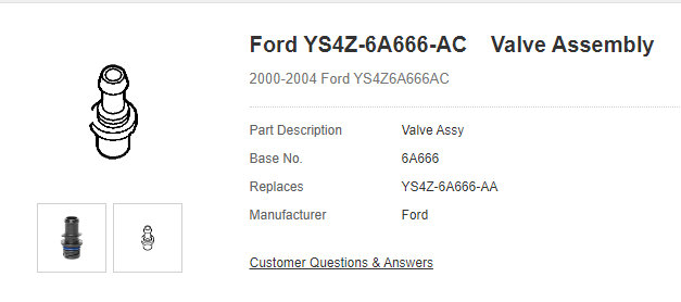

  • 109,896 POSTS
I need you to check something for me. I reviewed different vacuum / evap schematics and there are two different ones. I need to know the 8th digit of the VIN number. It should be either a 3 or a P.

It is a P. The full VIN is 1fafp33p32w318992. Thank you for the assistance. I really do appreciate.

  • 109,896 POSTS
I believe that it is the PCV valve hose. If you follow it, does it go to the valve cover and connect to the PCV valve? See pic below. If it does, the opposite side should be to either the air inlet tube or throttle body.

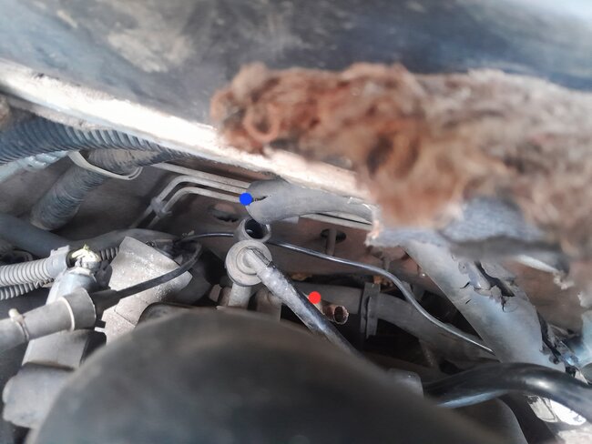

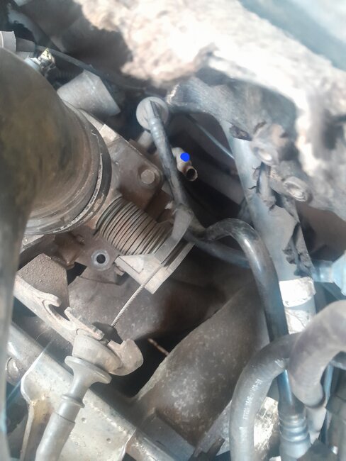

MAMIRORO SMITH
  • 83 POSTS
I can identify where the PCV hose which I highlighted with blue. There's another opening I highlighted with red. Which hose goes into it?
Tuesday, December 19th, 2023 AT 9:07 AM
  • 109,896 POSTS
I'm sorry, but I don't have access to the part numbers. It may be due to the model year. As far as the hose, can you tell me where it leads on either end?
