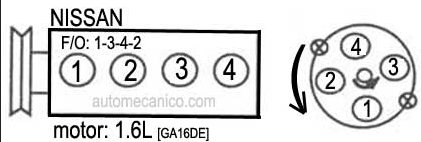

Is there a mark on the harmonic/crankshaft pulley which is for TDC? I know the timing is not adjustable and is controlled by the PCM. However, the rotor shouldn't be pointing toward the number 4 spark plug wire. It sounds like the distributor is 180 degrees off.

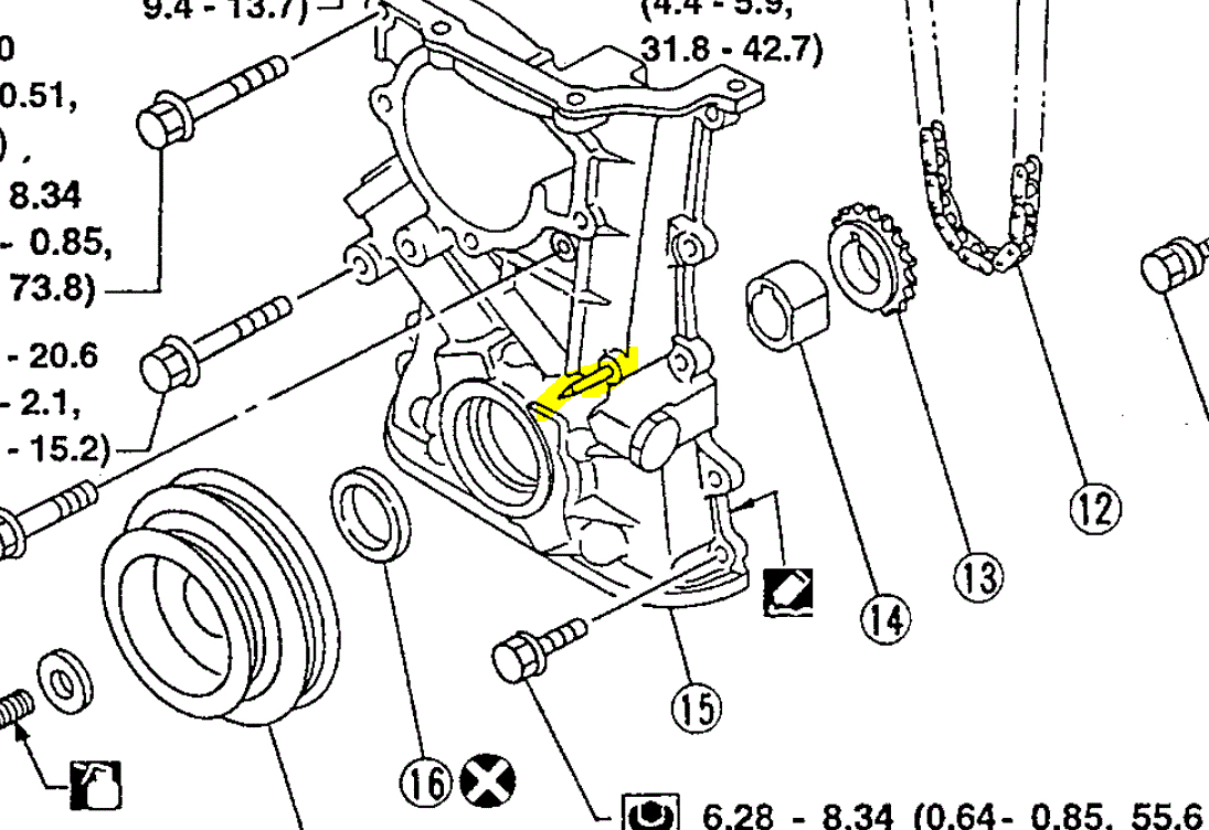

Take a look at pic 1 below. I highlighted the pin to indicate TDC. There should be a mark on the crank pulley. Check that.

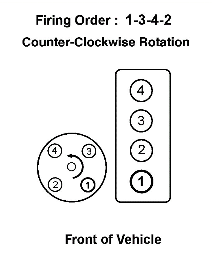

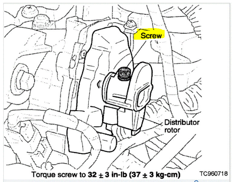

Also, pic 2 shows the firing order. Cylinder 1 spark plug wire is on the opposite side of cylinder 4. Please confirm it is pointing toward cylinder 1 spark plug. Also, make sure the rotor is tight. (Pic 3).

10-4. Yes, I confirmed the pointer was pointing to the second mark (from the left) on the pulley (indicating 0 TDC). However, the cylinder order picture you provided is incorrect, I am loading the correct picture for my engine (GA16DE). Sorry I forgot to provide that on the original question.
