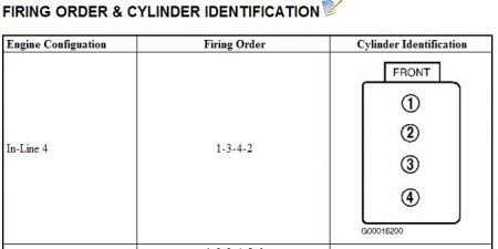

Firing order
WALT4523
  • 2006 NISSAN SENTRA
  • 4 CYL
  • FWD
  • 86,000 MILES
What is the firing order?
Friday, November 13th, 2009 AT 10:21 AM

BLUELIGHTNIN6
  • 16,542 POSTS
https://www.2carpros.com/forum/automotive_pictures/261618_Noname_1231.jpg
+1

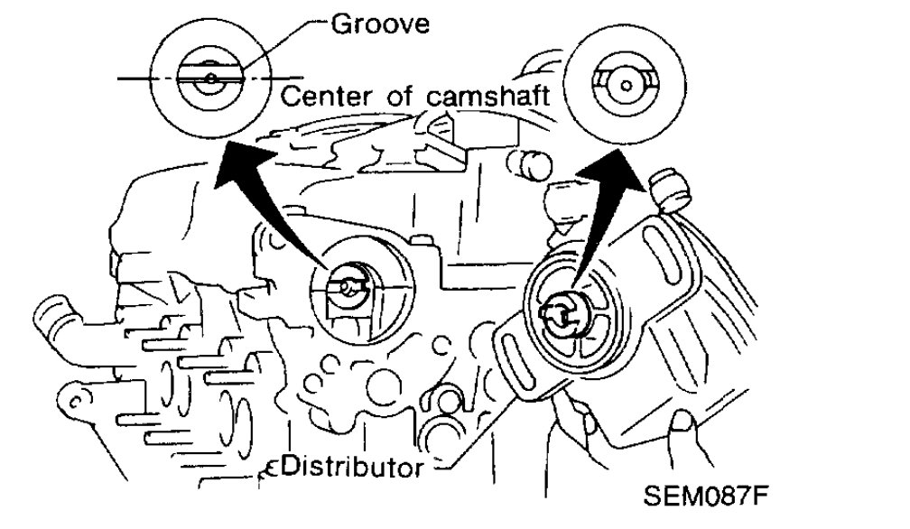

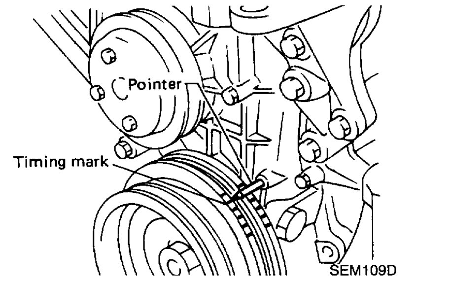

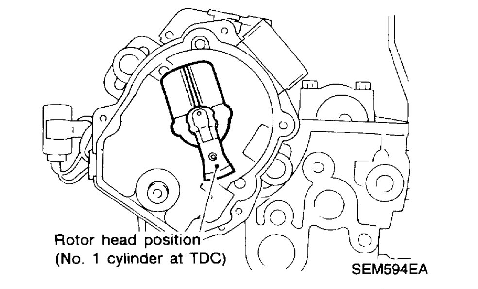

I had my distributor replaced and I'm not sure of the firing order of the wires. It is turning over but not starting. I think the problem may be the placement of the spark plug wires or the timing being off? Can anyone help me with a diagram of the firing order or can you tell me how to set the timing without a timing light, if possible? Thank you for any help you may be able to give me!
Monday, September 7th, 2020 AT 2:02 PM (Merged)
  • 52,797 POSTS
Good morning,
I attached pictures of setting the distributor in the correct way with the rotor.
Make sure you have the engine at top dead center compression stroke. Remove number 1 spark plug and hand crank the motor until you feel pressure coming out of the spark plug hole.
Then match the pointer on the crank to 0 mark. Then set the distributor as shown in the picture. The wires are also shown for the correct position.
The ignition timing is 0 degrees with a timing light.
The firing order is 1-3-4-2

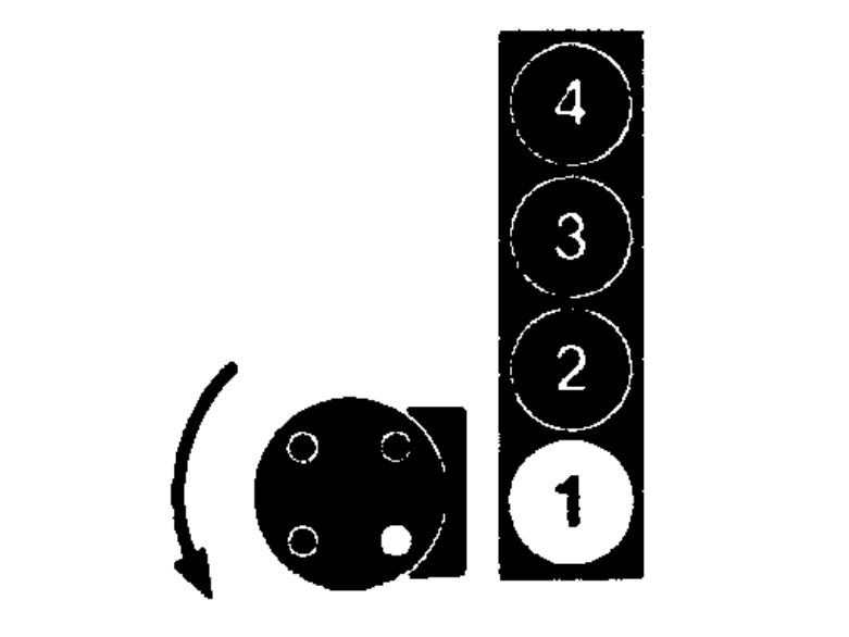

I need the firing order.
WRENCHTECH
  • 20,761 POSTS
Rotor turns counter clockwise. Check out the diagrams (Below). Please let us know if you need anything else to get the problem fixed. Firing order 1-3-4-2.

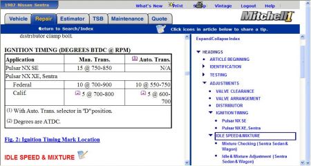

SANDEE WON
  • 9 POSTS
  • 1991 NISSAN SENTRA
  • 150,000 MILES
The timing is out Where is the mark?
HMAC300
  • 48,601 POSTS
Timing spec 10 degrees btdc 550-650 manual 575-675 auto. Pics included. Check out the diagrams (Below). Please let us know if you need anything else to get the problem fixed.
+5

What is the Firing Order for a 1994 Nissan Sentra? It has the 1.6L Engine, Manual Transmission, 160K Miles.
Thanks!
CHARLESDAV
If you are looking from the front of the car from left to right 1, 2, 3, 4 it should be on the distributor cap starting from top right plug and going clockwise 3 - 1 - 4 - 2, another web site has a differnt firing order showing 1 - 3 - 4 - 2 but I have the same engine and the first one I gave you is how my firing order is.

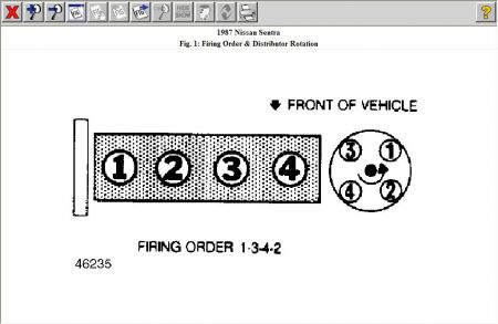

LADYAPPLE
  • 1987 NISSAN SENTRA
Engine Performance problem
1987 Nissan Sentra 4 cyl Wheel Drive Type unknown Manual? Miles
How do I get the firing order to have the timing done on my car?
Monday, September 7th, 2020 AT 2:03 PM (Merged)
  • 75,992 POSTS
There you go
https://www.2carpros.com/forum/automotive_pictures/12900_fo3_1.jpg
https://www.2carpros.com/forum/automotive_pictures/12900_fo_3.jpg
Good Luck

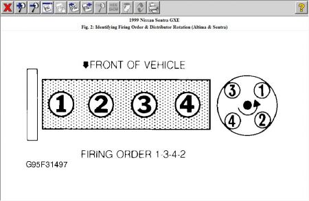

TIM LYON
  • 1999 NISSAN SENTRA
  • 4 CYL
  • FWD
  • 167,000 MILES
While doing the tune up I have crossed some plug wires I need the firing order, the cap is marked
Friday, January 8th, 2021 AT 11:54 AM (Merged)
  • 75,992 POSTS
Merry Christmas see below
https://www.2carpros.com/forum/automotive_pictures/12900_FO_1.jpg
+2
