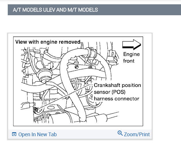

Had to remove head to repair broken off spark plug. After reinstalling the head, I had no spark. I have compression, and gas. There are no engine codes, and there is voltage to all four coils (coil over plug ignition).The computer will fire cylinder 4, one time only at the start of cranking, occasionally. I am using AlldataDIY as my repair manual, but it gives no way to diagnose this problem. Email to them for help has gone unanswered. HELP
Jun 23, 2009 at 12:15 PM
  • 75,992 POSTS

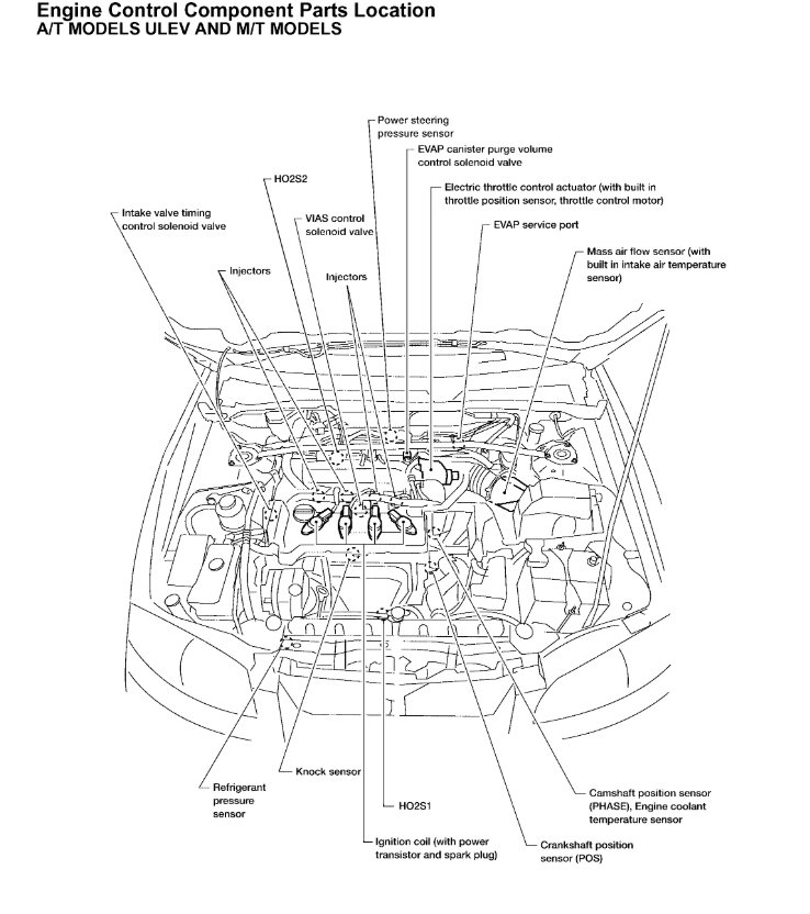

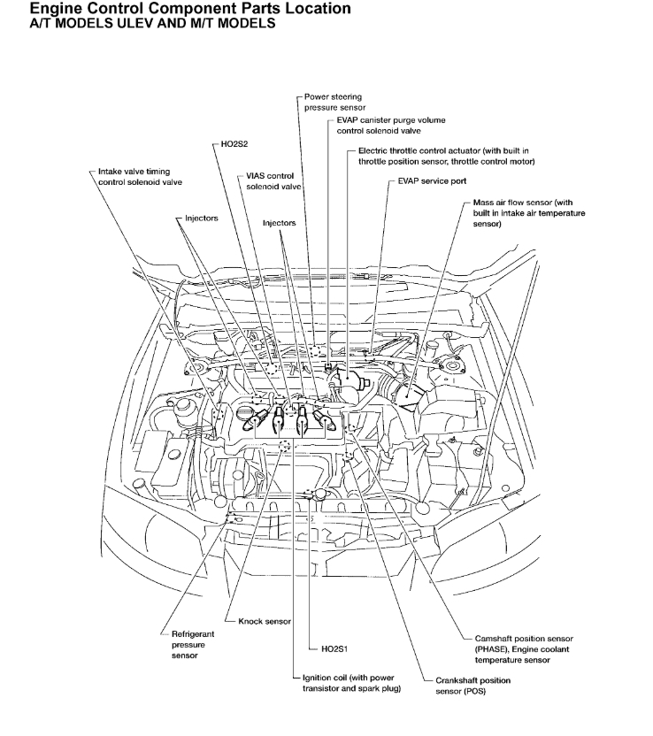

It sounds like the crankshaft sensor has stopped working here are diagrams and instructions on how to replace it. Check out the diagrams (Below). Please let us know what happens.
Jun 23, 2009 at 12:30 PM
CRAZYSENTRA
I have the exact same problem. I had to replace the sensor cost me $89.00 all set!
