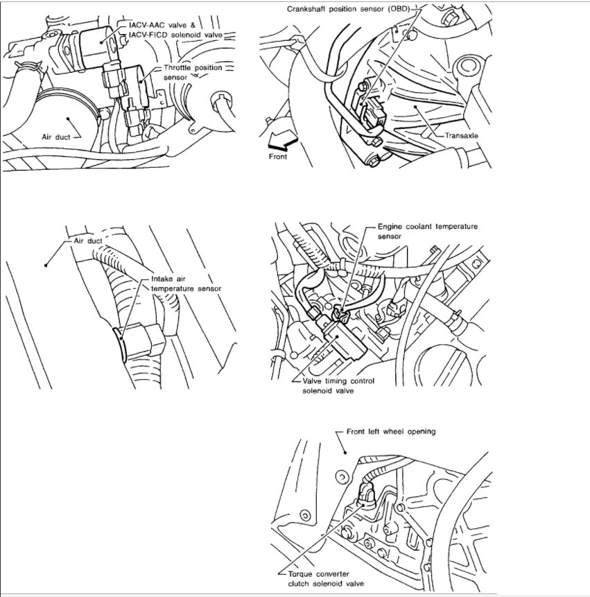

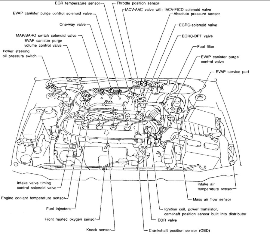

My engine will start but will slow down and cut off then you have to wait 30 minutes to and hour then it start up again, when it going up hills it just put put until it's almost cut off, it's like buttermilk for gas,help pleased.
Sep 9, 2017 at 3:36 AM
  • 54,878 POSTS
It sounds like you have a crankshaft angle sensor that is going out here is a guide and some diagrams (Below) that will help you get the problem fixed.
This guide gives you an idea of what you are in for when changing the sensor
