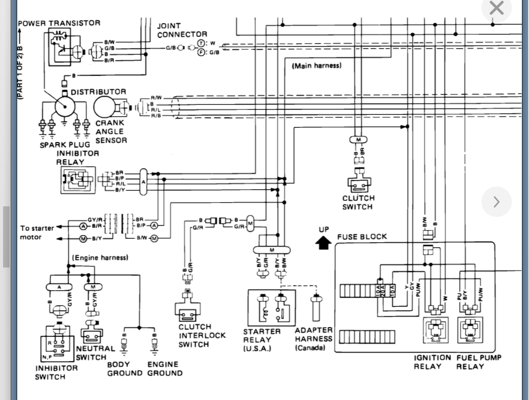

1988 Nissan Sentra , 98,000 miles. Has no spark to spark plugs. Replaced coil, power transistor, distributor cap, rotor, plugs, wires. Crank Angle Sensor (distributor) checks out ok. But, when I tried to check for bad codes on the E.C.M. computer, there were no led lights showing at all. Checked ECCS fuse, fusible link, all ok. Replacing the ECM is expensive, how do I know if it is really not working at all? Nissan was no help at all. Thanks.

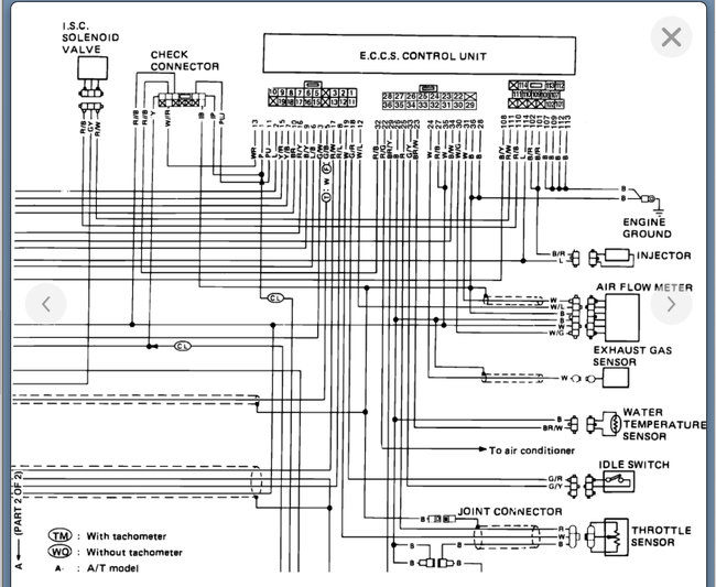

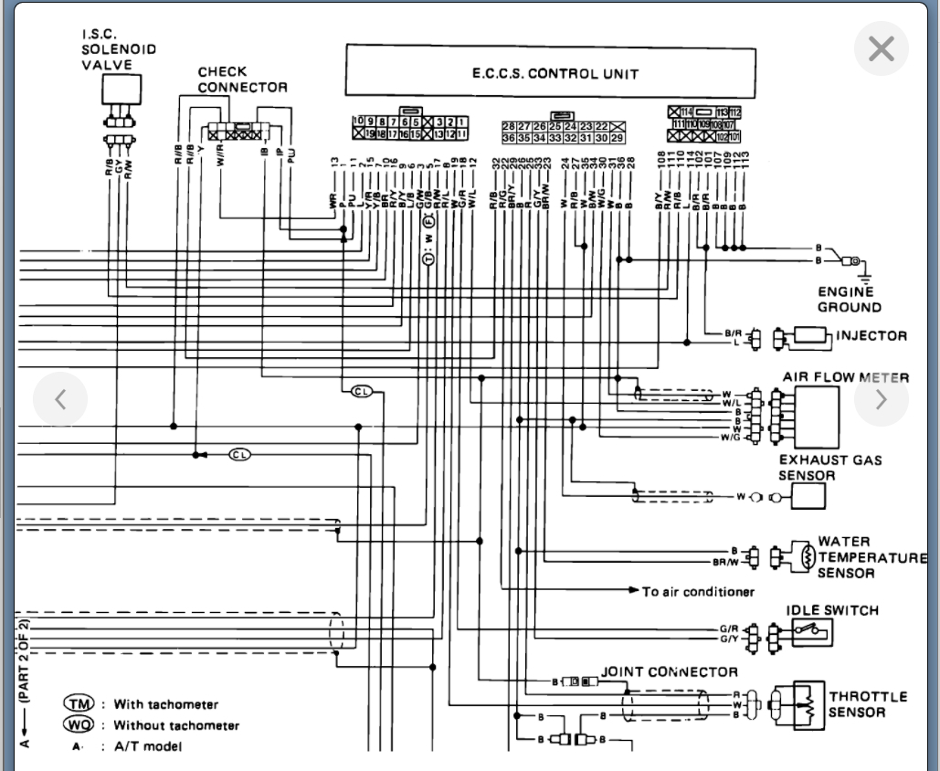

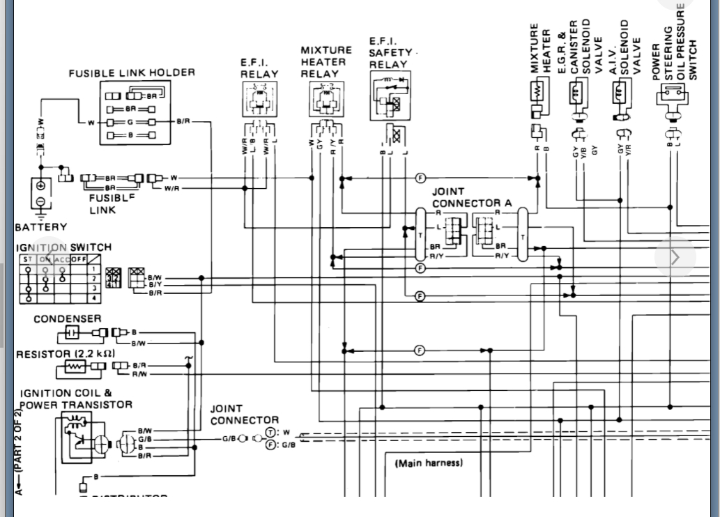

If you have replaced the distributor, module, and coil then we need to check a couple more items. There is an inhibitor relay that will cause this issue.
However, the way we are going to have to find this is to take the wiring diagrams below and work backwards through the system tracking voltage until we find it. I assume you have no voltage from the distributor to the power transistor and then continue backwards. You will see the coil and transistor on page one and then pick it up on page two in the lower left corner.
Let's run through this and let me know what you find. Thanks
