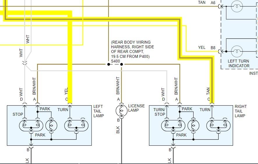

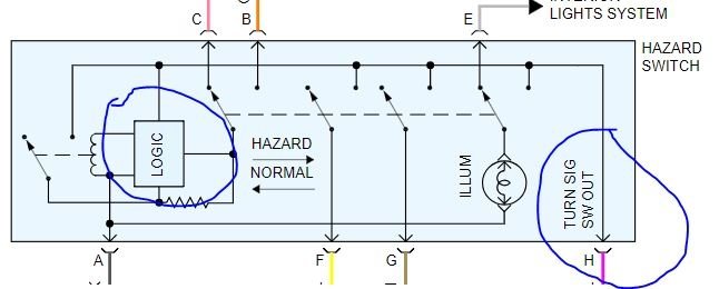

If they are all working, chances are the logic module in the new switch is different and that is what you are seeing. When power runs through the signal, circuit it goes through a module or flasher that will pulse power rhythmically. According the the schematic I have, the logic module is located in the new switch you purchased. That could be the issue and nothing is wrong.

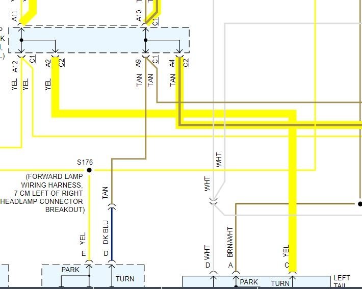

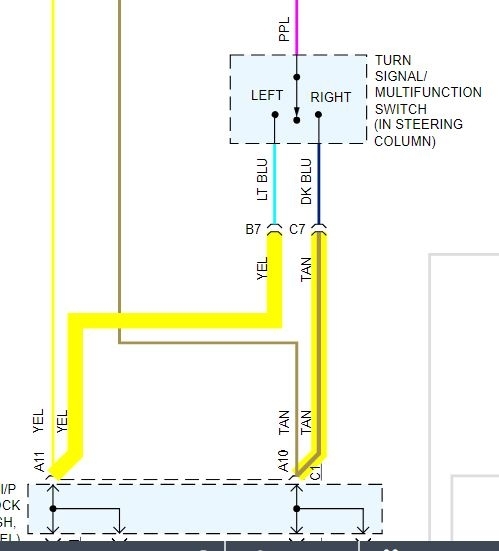

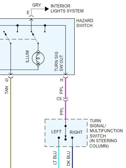

Take a look at the pictures I have attached. First, I attached a pic of the hazard switch you have replaced. Note what I circled. You will see the logic module and the power out which runs to the signal switch in the vehicle. From that point, I have attached other pictures showing that power then runs to the lights. I had to do it in a few pics to eliminate other things. Also, I highlighted the wires related to the signals. Note that there is one power supply from the hazard switch that leads to the signals.
Let me know if this helps or if you have questions. Also, let me know how fast they are flashing. If you could upload a picture of them working, it would help.
