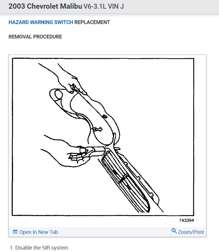

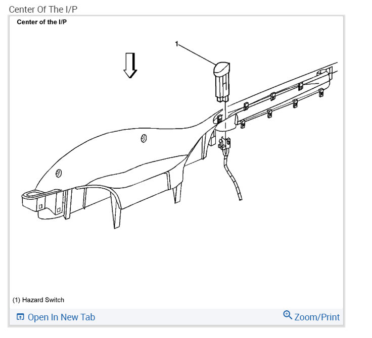

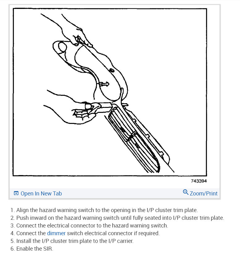

The 4 way and the directional are the same connection,you have to pull the dash and replace the 4 way hazard switch in the dash. It sounds harder than it is it only took about 15 minutes to do it. The dealer was closed so I got it from the junk yard (20.00). I dont know what the dealer would charge but I think it was a bargain. Check out the diagrams (Below). Please let us know if you need anything else to get the problem fixed.

is your emergency flasher switch. dont waste no time looking for the flasher because the flasher is a small relay in the emergency switch. i have the same problem 2 months ago.
Hazard Lamp/Turn Signal Lamp Flasher Integral to hazard switch, left center of instrument panel.

These are inside the hazard switch for both turn signal and hazard flashers.

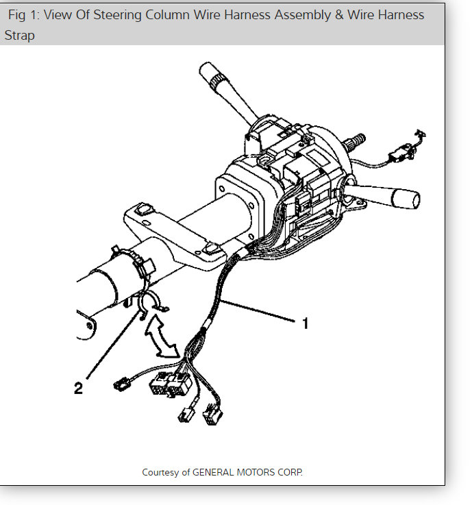

it's an internal part of hazard switch left of steering column. but check your grounds at front and rear first

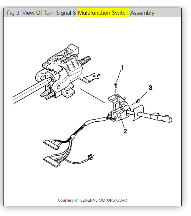

Turn signals are possessed, they will work and suddenly with no notice will shut off. Sometimes they work and sometimes they don't, it's real strange. Someone told me it may be the blinker switch behind the emergency flashers, is this possible or something else/ Thank you
Dec 13, 2019 at 9:55 AM (Merged)
BLUELIGHTNIN6
  • 16,542 POSTS
definitely could be a sticking/failing signal relay which is behind flasher switch yes. that is most likely cause but not only possibility, it may also be the turn signal switch itself failling.

the hazzard flasher module is bad. It is located in the hazzard switch.
