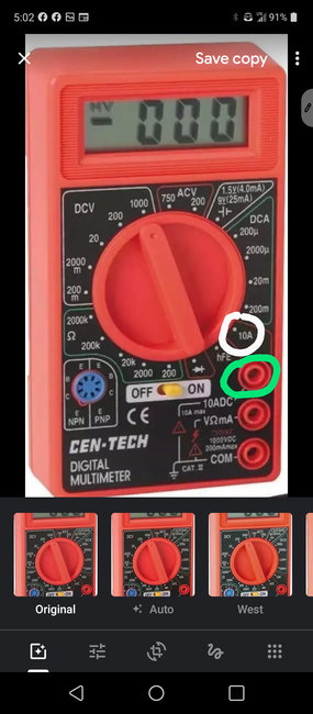

I just did a parasitic battery drain test with a multi-meter and got a reading of 0.02 amps and it would fluctuate up to 0.08 amps. Is this good or bad?

When I hook up the multi-meter it continuously for maybe 10 seconds and then it settles down to 0.02. Now keep in mind I am using a cheap Harbor Freight multi-meter. My settings is set on DCA and on the number 20 in the range setting and the red lead is plugged into the 10amp hole.

Here is a pic of the multi-meter i'm using: the white circle is where the dial is set and the green circle is where the red lead is.

That looks correct. If it only says high for about 10 seconds and then drops to.02 amps and stays there, that isn't an issue. There are different things that draw power for a very short time before they go "to sleep mode".
