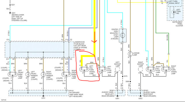

All turn signals work except left rear. new bulbs have been put in.. the signal indicator flashes one time when i turn on the left turn signal and that's it. the right side works perfect.. emergency flashers don't work at all.. i don't think the button even clicks.. also the car has started fine.. i start it every two days or so. this morning it was completely dead looks to be a new battery.. just bought it from someone else. any ideals as to any of my problems?
May 21, 2020 at 11:15 AM
  • 110,244 POSTS

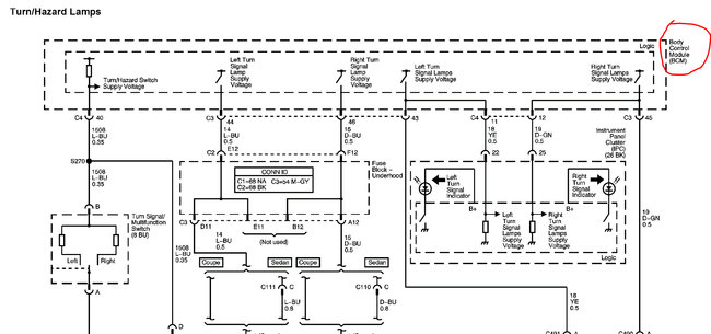

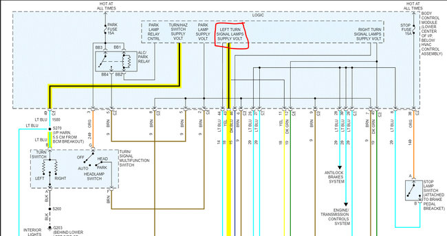

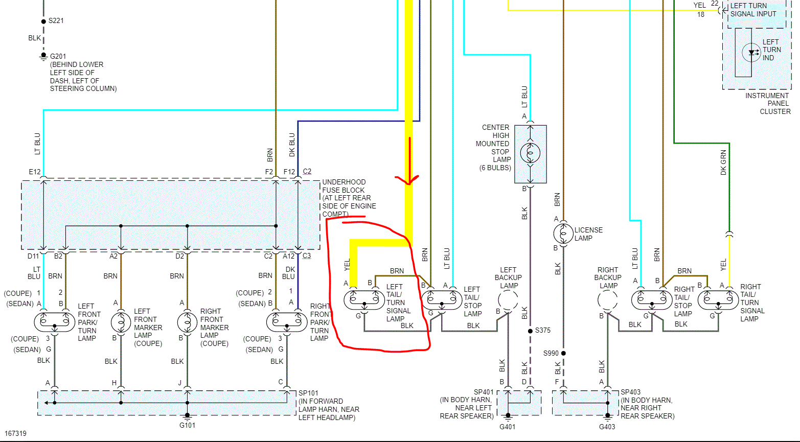

Does the left front signal turn on or do anything? I'm asking because the power supply to the left rear signal is provided by the body control module. So, to start I need you to check for power to the yellow wire on the left rear signal bulb.
I attached two pics. The first is the body control module showing how power is distributed. The second is at the light itself (rear) showing the yellow wire I'm referring to.
Do this and let me know what you find.

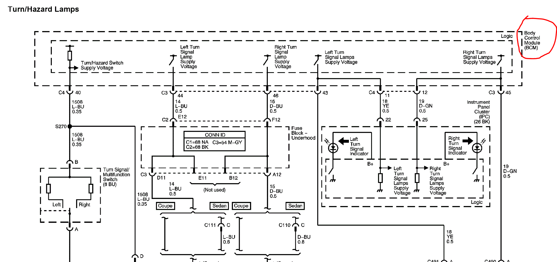

The turn signal flasher function is performed by the Body Control Module (BCM). That is why I'm thinking that is where the problem is. If you take a look at the attached picture, that is a portion of the body control module schematic for the signals/hazard.
Let me know what you find.

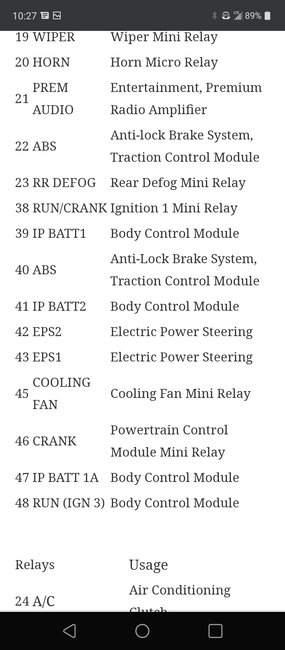

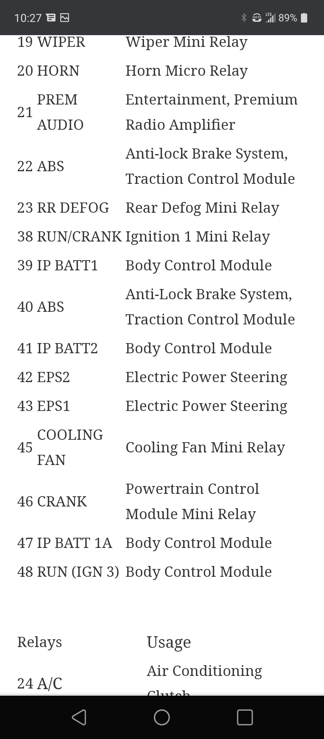

This is the is the diagram if the fuse block and it shows a BCM relay slot on number 47 but is missing in my fuse block. could this be the problem?
May 31, 2020 at 3:33 AM
  • 110,244 POSTS
The IP stands for instrument panel. Chances are it isn't the cause. Plus, I assume it wasn't removed when this happened, correct?
May 31, 2020 at 12:12 PM
GRAMPAS5150
  • 47 POSTS
If it was removed i don't have any clue i just know that that slot is empty. where is the BCM located for my car and will it have to be programmed.

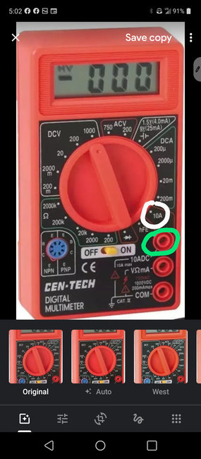

I just did a parasitic battery drain test with a multi-meter and got a reading of 0.02 amps and it would fluctuate up to 0.08 amps. Is this good or bad?

When i hook up the multi-meter it continuously for maybe 10 seconds and then it settles down to 0.02. now keep in mind i am using a cheap Harbor Freight multi-meter.. my settings is set on DCA and on the number 20 in the range setting and the red lead is plugged into the 10amp hole.

Here is a pic of the multi-meter i'm using: the white circle is where the dial is set and the green circle is where the red lead is.
Jun 1, 2020 at 10:06 PM
  • 110,244 POSTS
That looks correct. If it only says high for about 10 seconds and then drops to .02 amps and stays there, that isn't an issue. There are different things that draw power for a very short time before they go "to sleep mode".

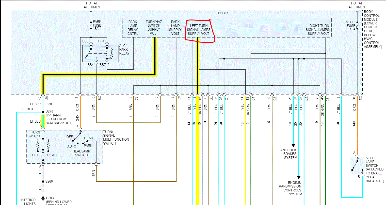

I finally got around to testing the yellow wire at the socket end and there is no power. there is six wires going to that socket and some do test good but the yellow one has no power. i have an appointment to have the b codes done on the 11th. If he can read them.. he told me some Saturn's he can read others he can't.
Jun 6, 2020 at 4:05 AM
  • 110,244 POSTS
I hope it's an easy fix. If you have the chance, let me know what is found. I'm interested in knowing.
