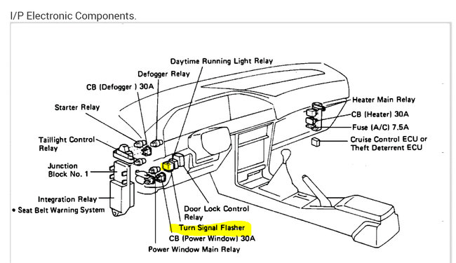

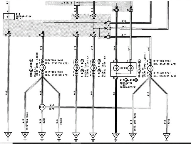

Hi, my car listed above GLS model, turn signals do not turn off and is draining the battery. The fuses are fine and bulbs as well. I can however not find the relays for the turn indicator. As the car is a right-hand drive. Regards
Dec 8, 2021 at 2:40 AM
  • 110,248 POSTS
When you say they won't turn off, do you mean when the key is off, or they don't cancel?
Since this is a right-hand drive, I'm somewhat limited. However, usually the components are a mirror image to each other.

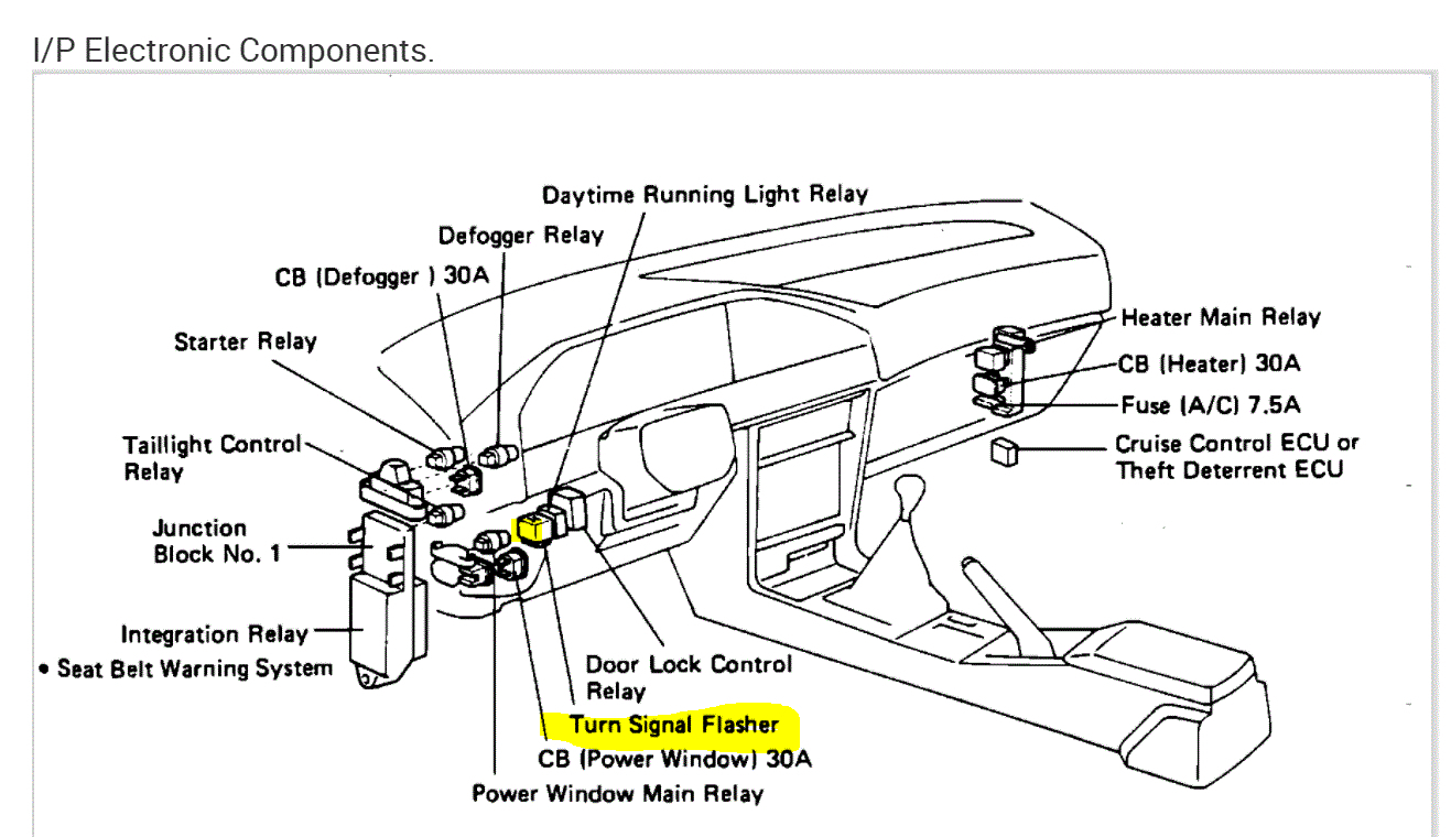

I highlighted the flasher below. Check there and the opposite of the dash for it.

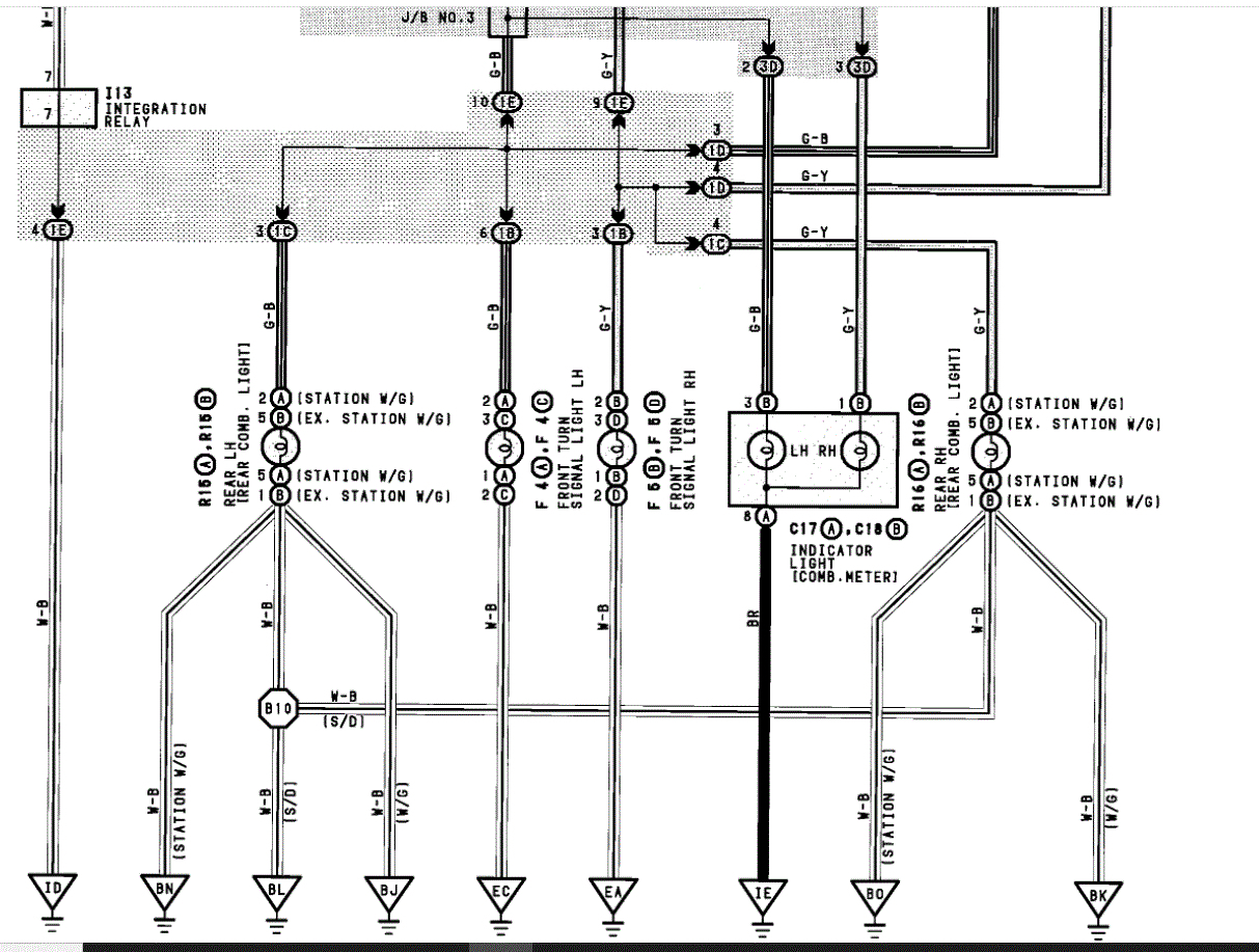

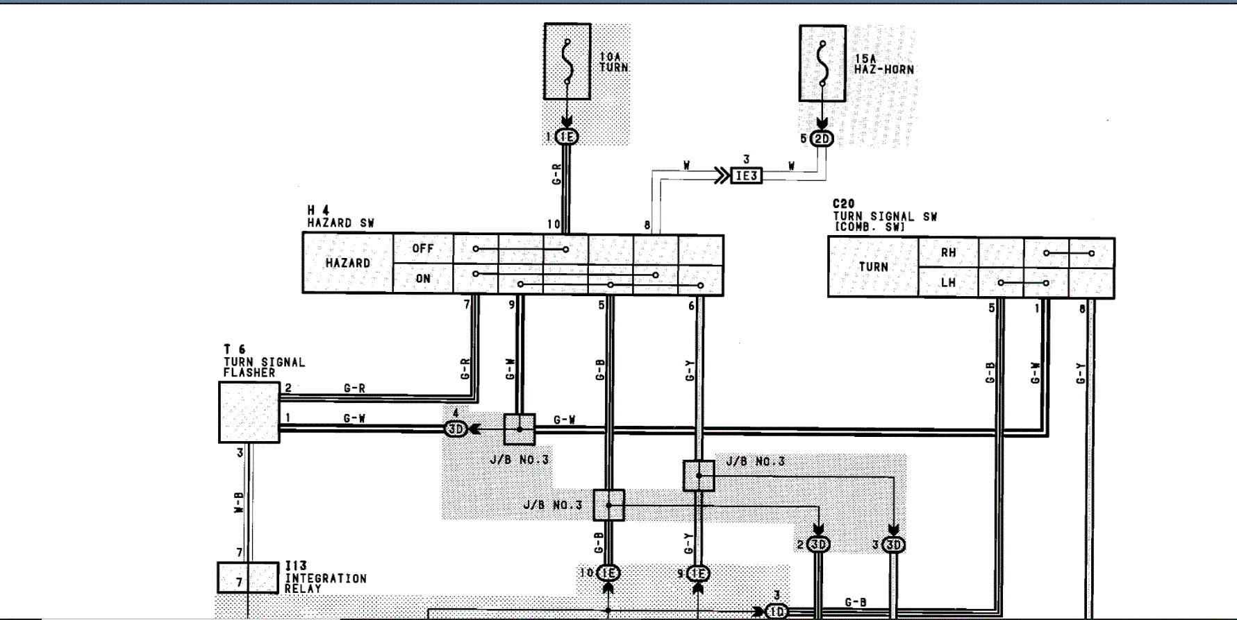

I also attached the wiring schematics which I have for the signals, so you have a reference.
Let me know as much as you can.
