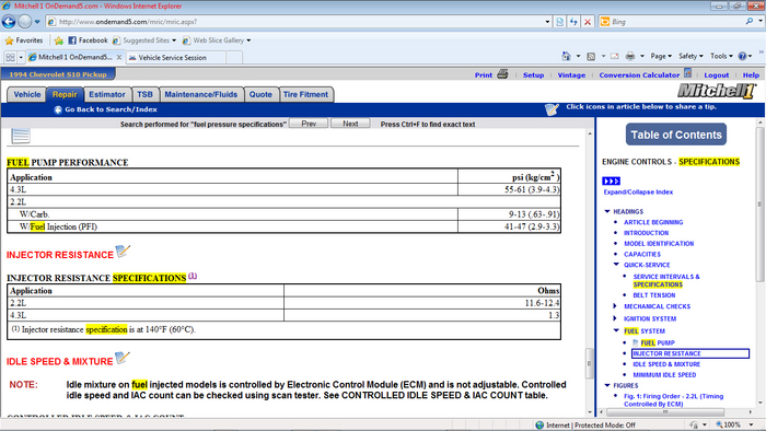

See attached image of fuel pressure specs.
Jan 29, 2021 at 3:01 AM (Merged)
