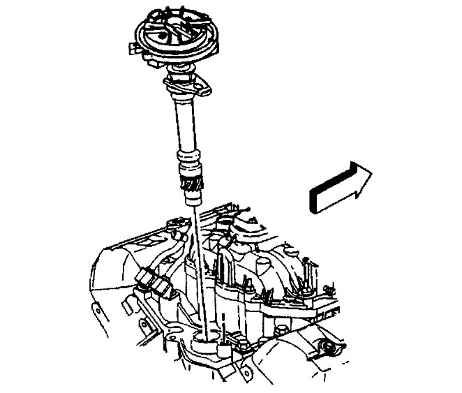

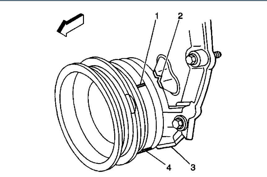

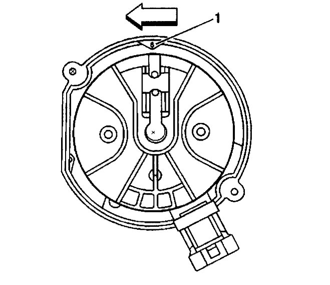

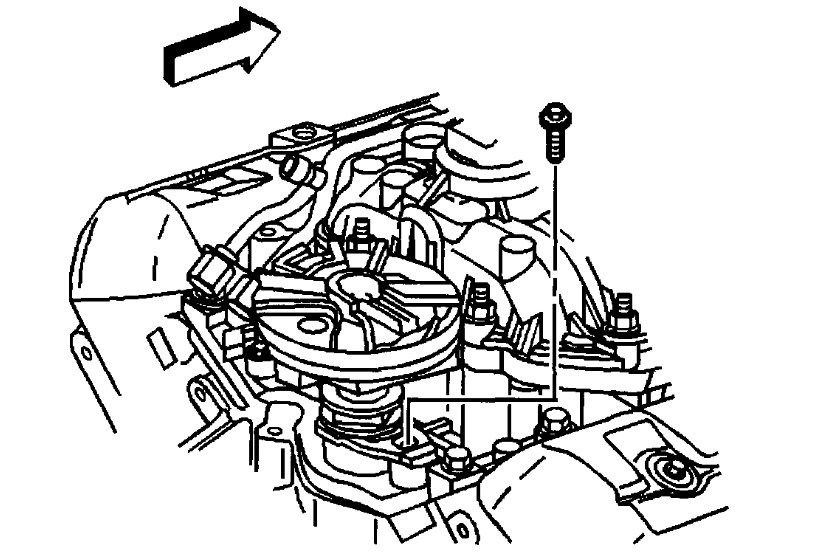

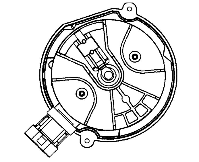

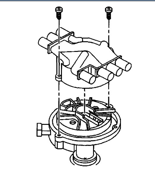

Okay, it sounds like you have the distributor in incorrect.
I attached the procedure for installing it.
IMPORTANT: The engine front cover has 2 alignment tabs and the crankshaft balancer has 2 alignment marks (spaced 90 degrees apart) which are used for positioning number 1 piston at top dead center (TDC). With the piston on the compression stroke and at top dead center, the crankshaft balancer alignment mark (1) must align with the engine front cover tab (2) and the crankshaft balancer alignment mark (4) must align with the engine front cover tab (3).
1. Rotate the crankshaft balancer clockwise until the alignment marks on the crankshaft balancer are aligned with the tabs on the engine front cover and the number 1 piston is at top dead center of the compression stroke.
2. Remove the distributor cap bolts and discard.
3. Remove the distributor cap.
4. Install a NEW distributor gasket onto the distributor.
5. Align the indent hole on the driven gear with the paint mark on the distributor housing.
6. Ensure that the distributor rotor segment points to the cap hold area.
7. Align the slotted tang in the oil pump driveshaft with the distributor driveshaft.
Rotate the oil pump driveshaft with a screwdriver if necessary.
8. Install the distributor and distributor clamp.
The flat in the distributor housing must point toward the front of the engine.
9. Once the distributor is fully seated, align the distributor rotor segment with the number 6 pointer (1) that is cast into the distributor base.
If the distributor rotor segment does not come within a few degrees of the number 6 pointer (1), the gear mesh between the distributor and camshaft may be off a tooth or more. Repeat the procedure again in order to achieve proper alignment.
10. Install the distributor clamp bolt.
Tighten the distributor clamp bolt to 25 Nm (18 ft. lbs.).

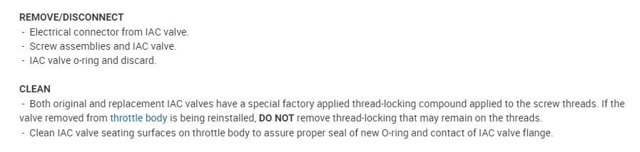

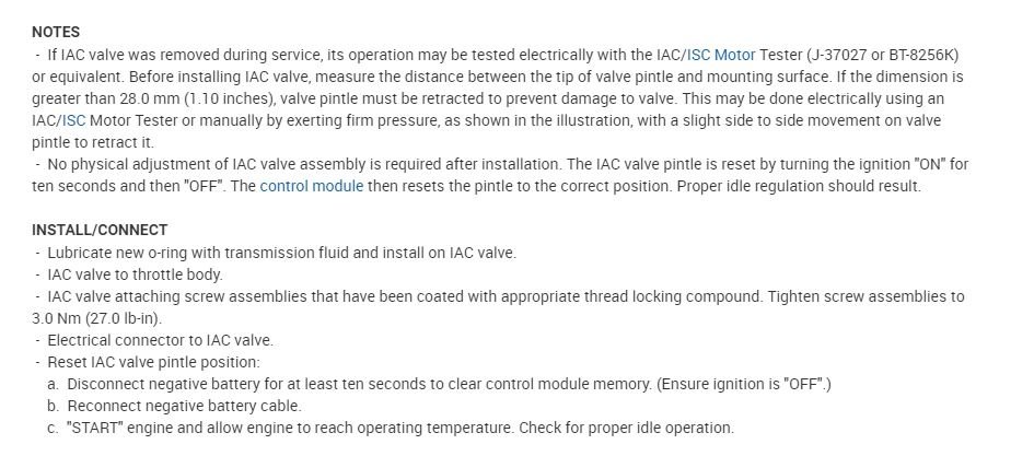

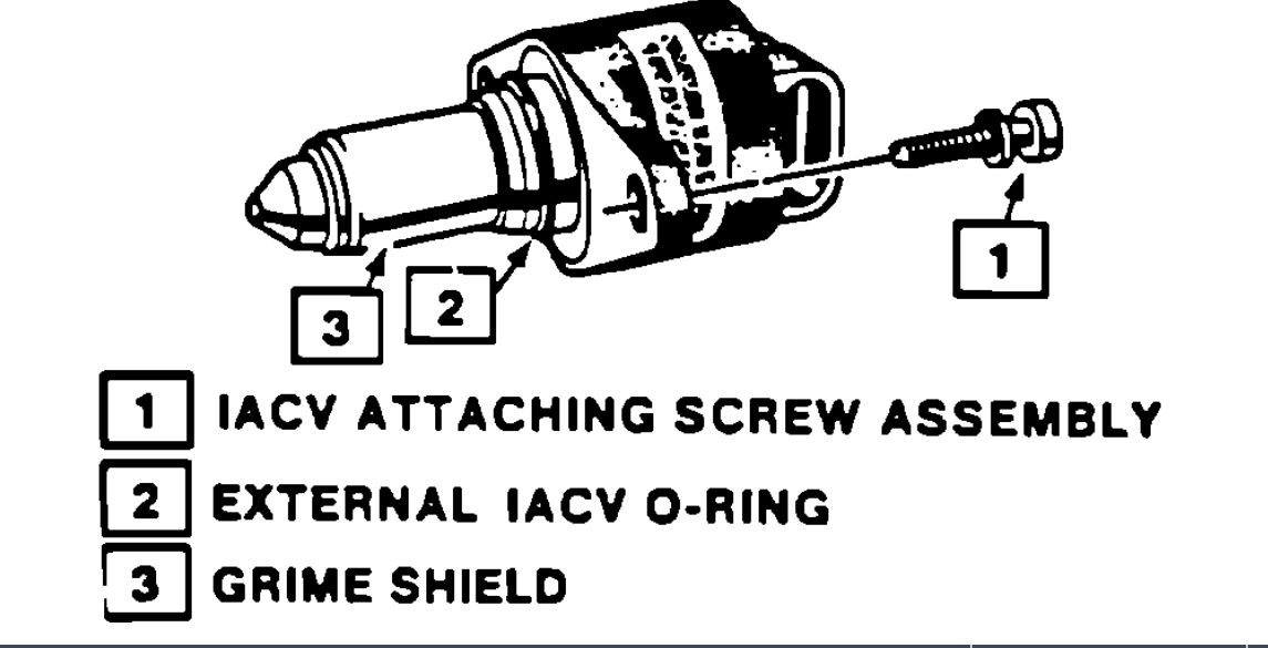

Good evening,
Are there any codes set in the system?
I would start by cleaning the throttle body of all carbon.
This could also be an idle air control motor. I attached a picture and procedure.

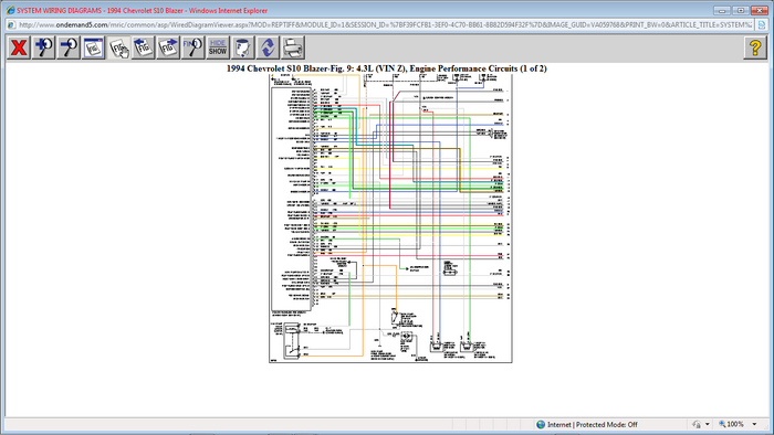

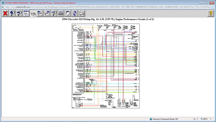

Check to see if the injector is pulsing. I have attached a schematic that shows where the injector receives its signal from. Upper right corner.
Jan 29, 2021 at 11:01 AM (Merged)
JAGFIX
  • 11 POSTS
Thank you for the schematic. It is hard to view and it appears to be different than my vehicle wires. I noticed the schematic is for a VIN W. I have the TBI VIN Z.
RIVERMIKERAT
  • 6,110 POSTS
VIN Z schematic. Slightly different. Click the thumbnail. Then right click the image and select "Save Image As". Then you can view it with any image viewing software you may have, or print it.
