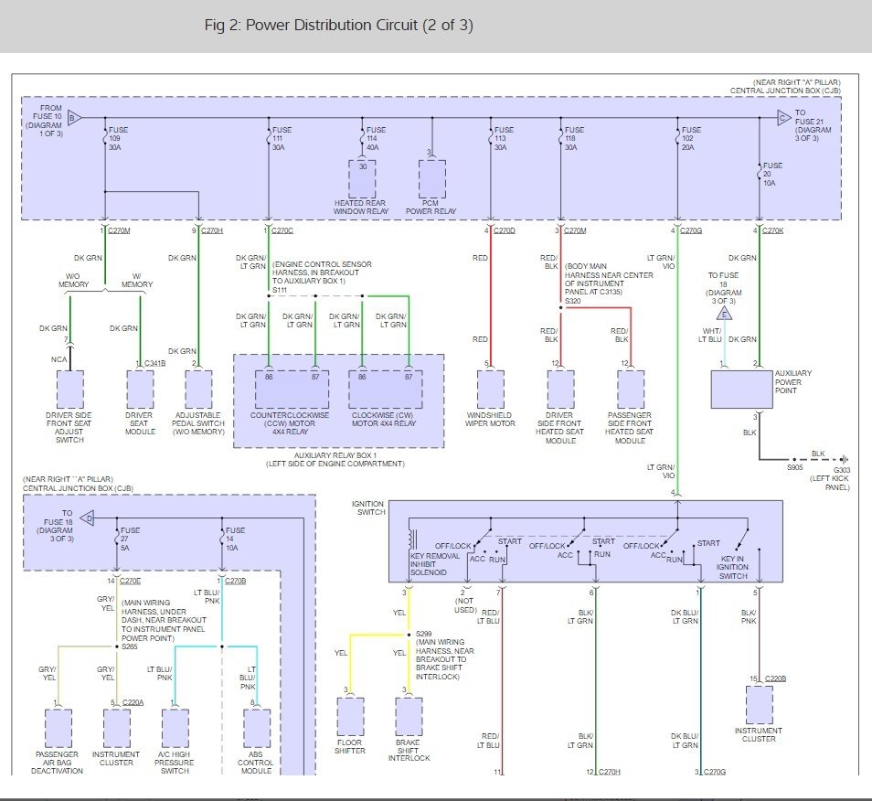

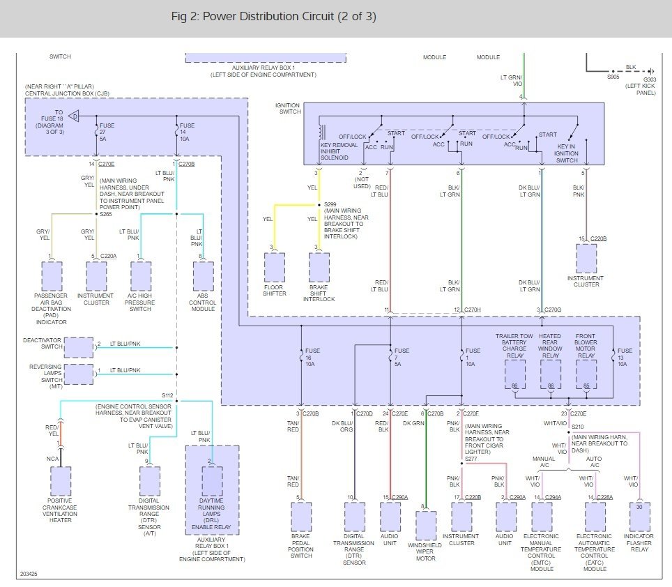

I did some checking and it looks like you may have an ignition switch that has gone out, here is a wiring diagram and a guide to help you confirm the problem. See how the radio and turn signals come off of the one terminal?
and
This could be why the engine stopped as well.
Please run some tests and get back to us so we can continue helping you.

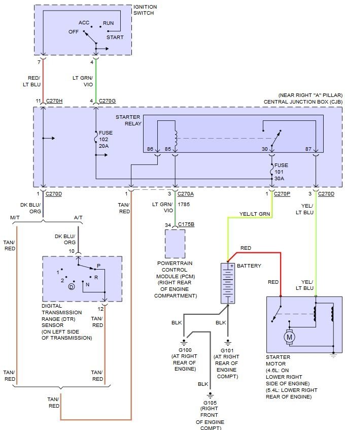

I replace the starter and battery on my truck, I replaced the battery at the same time. I removed the battery replaced the starter then put the new battery in after. I went to the cab and tried to start it and nothing. I went to the starter solenoid and jumped the power to the signal terminal and the engine started to crank over. I went into the fuse box after this and jumped the power terminals on the plug in and the truck started. I shut off the truck and attempted again with no start again. I then switched the replay out and attempted again with no start. After this I checked the fuse for the ignition and starter replay and the looked fine. It seems like I am not getting power to the switch terminal (85) on the starter relay. I am lost at this point. Any help would be appreciated.
Sunday, May 30th, 2021 AT 3:45 PM (Merged)
STEVE W.
  • 13,572 POSTS
Check fuses 101(30A) and 102 (20A) for power with a test light. I have had fuses that looked fine that were bad.
Run a security system reset first. Modern vehicles have a bad habit of activating that when they lose battery power. In your case if you look at the wiring diagram, you can see the connection to the PCM. That is how it disables the start circuit. It simply removes the ground from the relay and instantly you have no control of the starter relay. If you can move the shifter, run it through the gear positions and back to park.

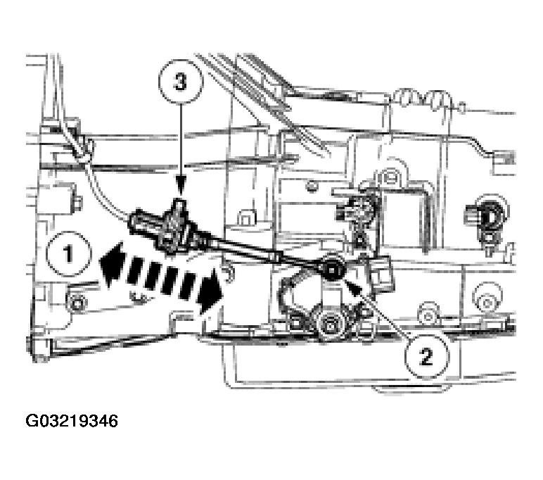

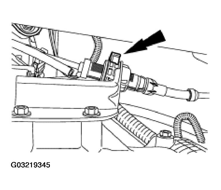

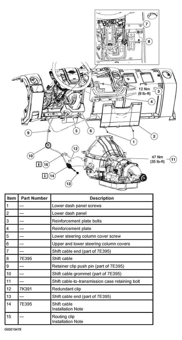

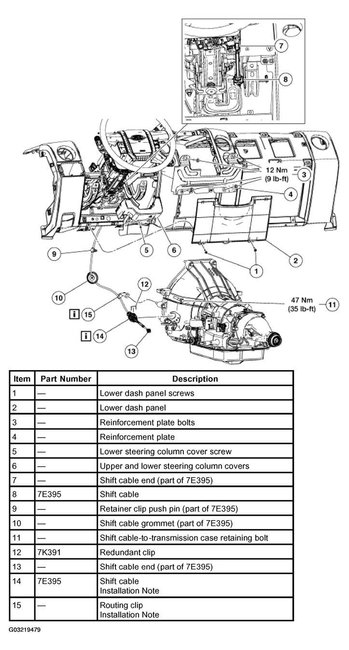

The truck listed above has a new crate motor about 30,000 on motor. We replaced shift cable went to check it and when to just turn the truck on to make sure it was showing in park like it should, but they turned it too far with the transmission piece undone now truck will not start.
  • 109,885 POSTS
It sounds like they have the linkage out of adjustment and the vehicle does not realize it is in park. I have attached three pictures for you to review. The first one is an exploded view of the unit. The next two show the adjuster and the locking tab that needs to be released for the adjuster to move. Once you loosen the adjuster, make sure the vehicle cannot move and manually push the shifter lever on the transmission all the way to park. Once that is done, make sure the column shifter is in park and make any minor adjustments to ensure the transmission is in park. If the cable is out of adjustment, the neutral safety switch will not allow the engine to start.
