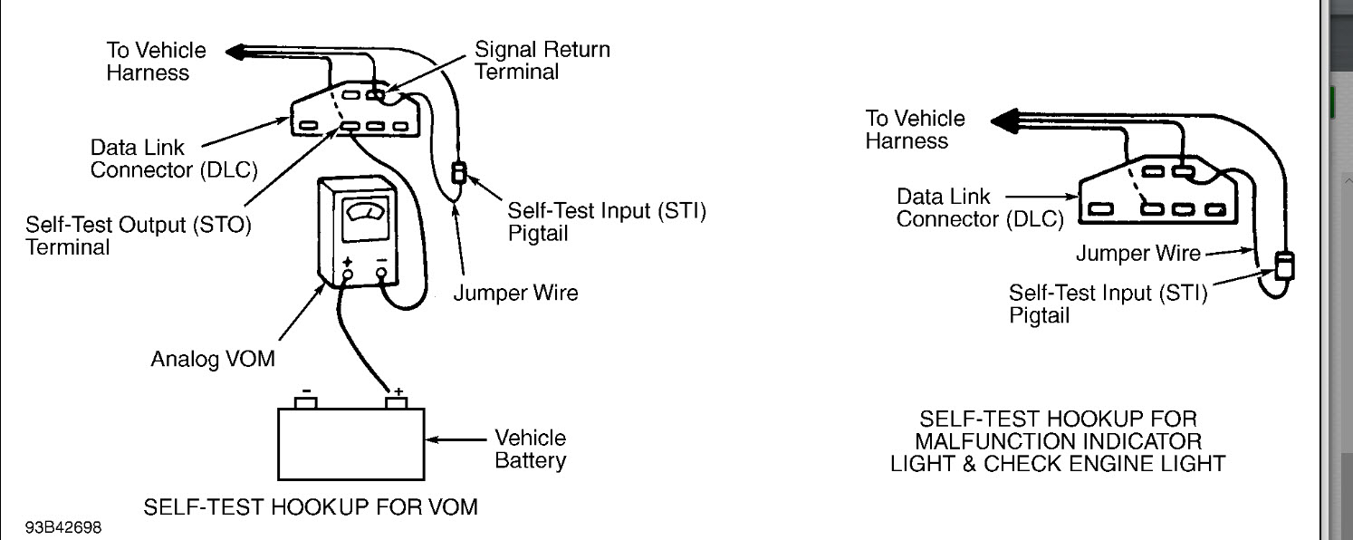

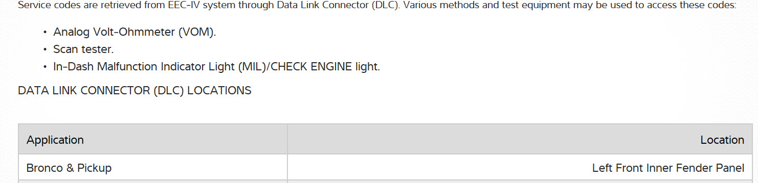

Finding a scanner is tough it has the obd1 under the hood. I got it to crank but ran really badly. Now it has quit again on side of road. The battery keeps draining out in attempts to crank it. Fun days.
Jan 1, 2017 at 6:50 AM
HMAC300
  • 48,601 POSTS
you do not need a scanner for OBD1. see picture on how to do it with a jumper wire. see pictures and get back with the codes. shows what to look for and how to hook up system so you can read codes.
