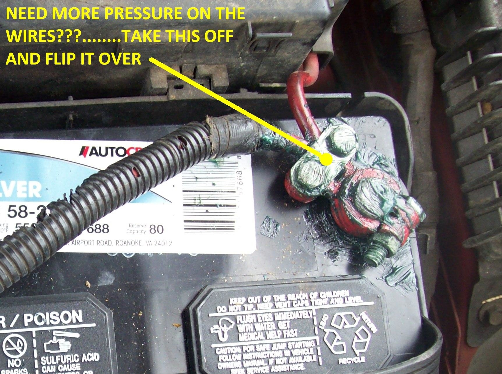

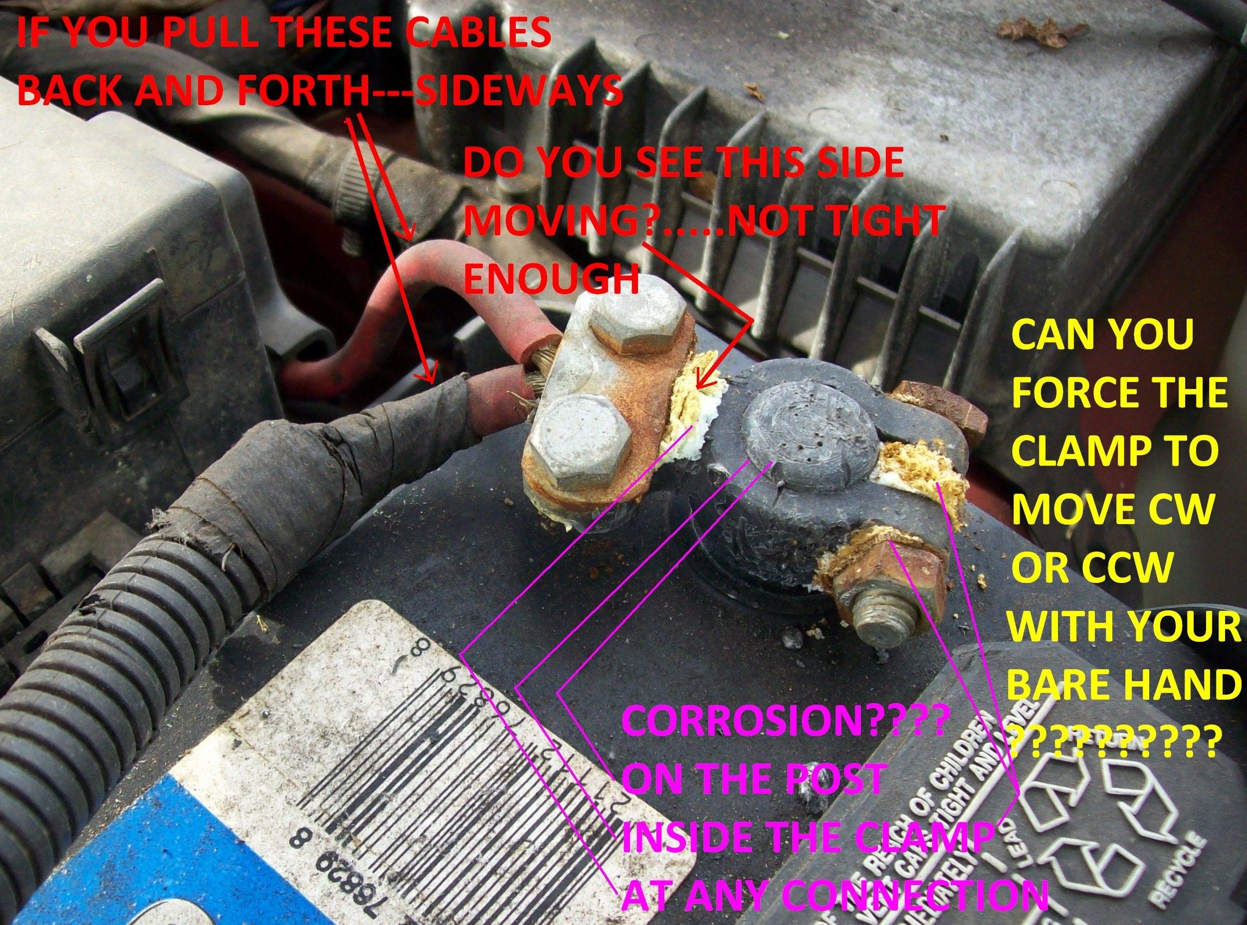

Ok, lets do the basics 1st before we throw blame elsewhere.
Grab your battery clamps on the battery posts, can you forcibly twist, pull, make it move the clamp on of the battery using your hand?
If you have aftermarket (regular ole) clamps whereas a 2 hole strap holds the cable to the clamp. Let's "left and right" the cable forcibly. Does the copper on the other side of the strap move? (it should not!)
Your starter solenoid (now days called a starter relay) body should be bolted on to a good clean ground (fender)
Now for the good part, I always try to shorten this but get the message through.
Clean the battery posts and inside of the battery clamps. Tap them way down on the battery posts. Tighten well (your clamp should still have a gap when you are done, not the clamp ends touching and the bolt will go no further). (This depends on the type clamp you have)
Now follow the positive and negative cables from the battery and the starter.
Clean (or at least loosen and scooch the ends around) the cable ends and the posts they connect to. (both sides of the Solenoid, the starter connection (These all being the Hot cables) and check the ground from the negative battery cable. Tighten everything well.
Many folks halfheartedly do these things, they'll touch the items but never get in there on them!

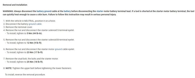

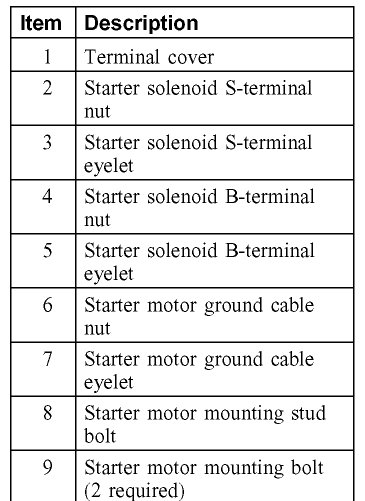

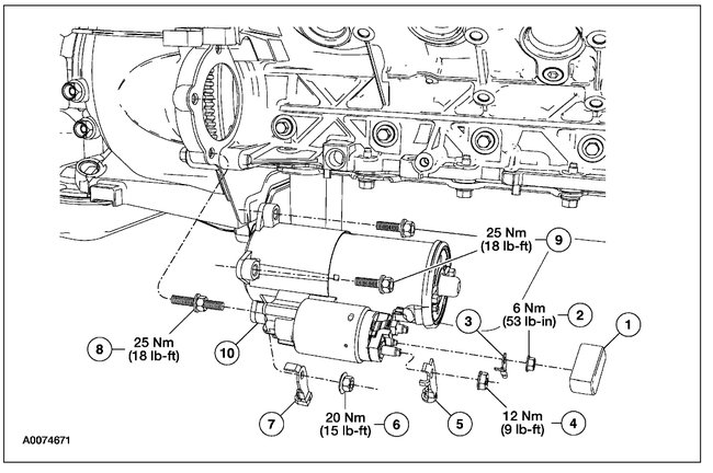

Here's a link from our site (repair guides-top right of our pages)
Here's some pics I made

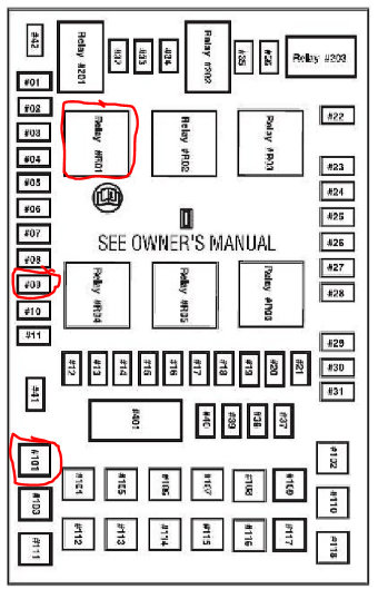

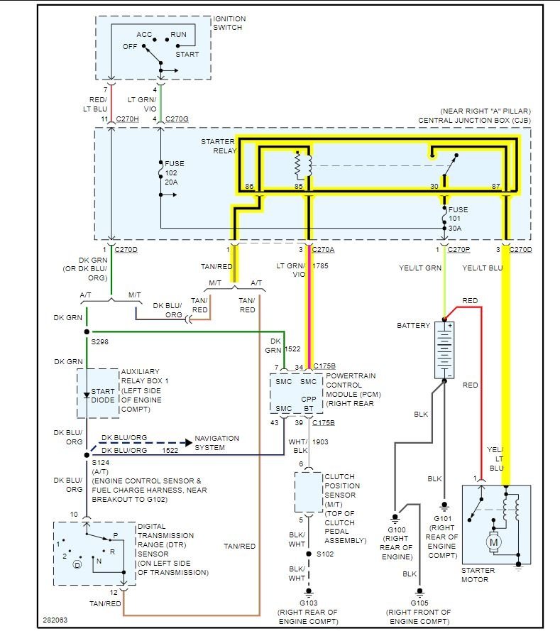

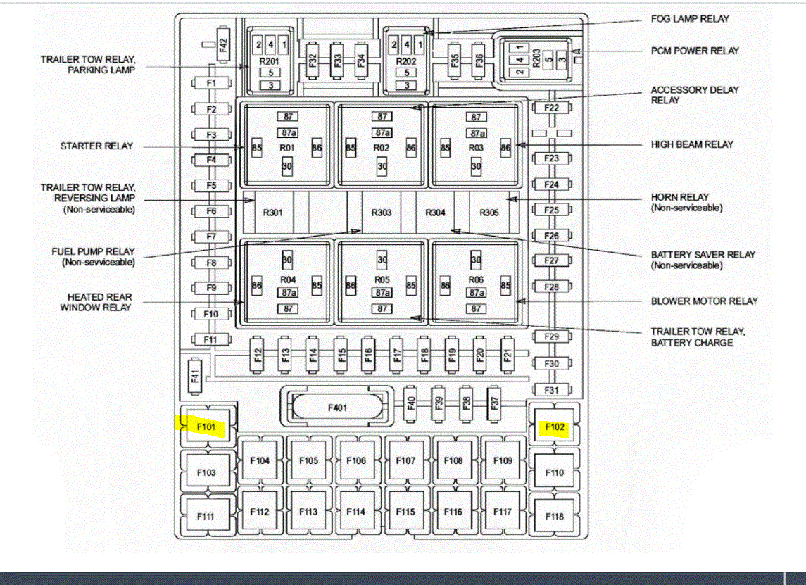

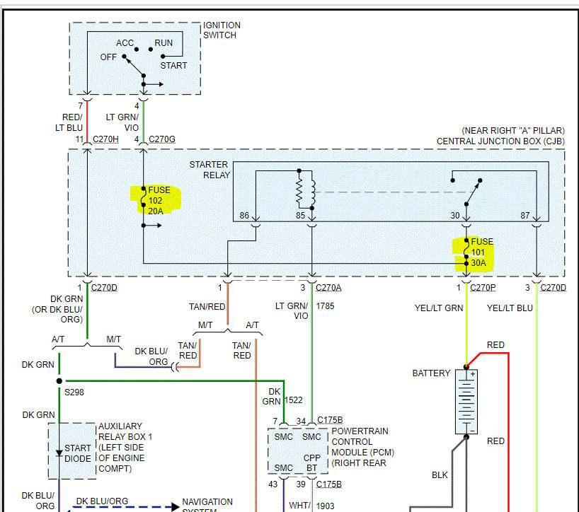

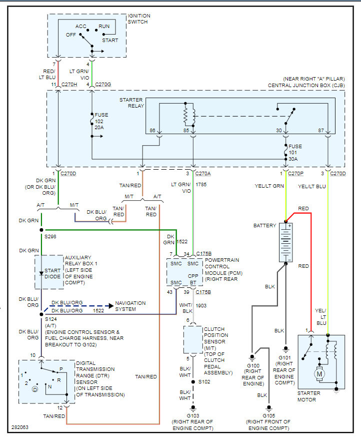

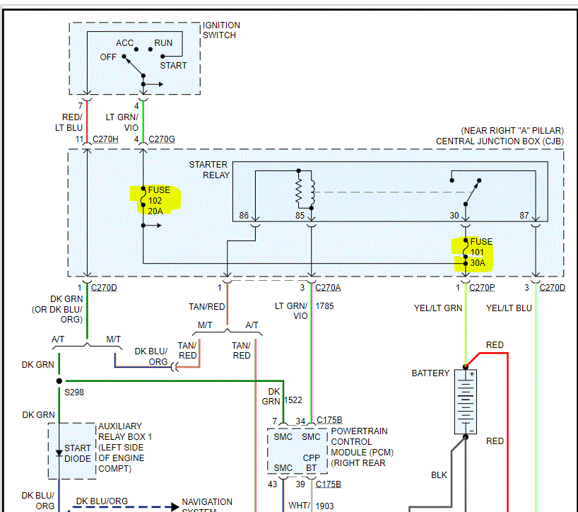

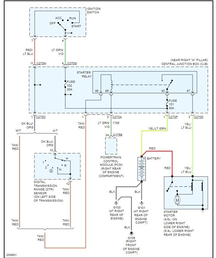

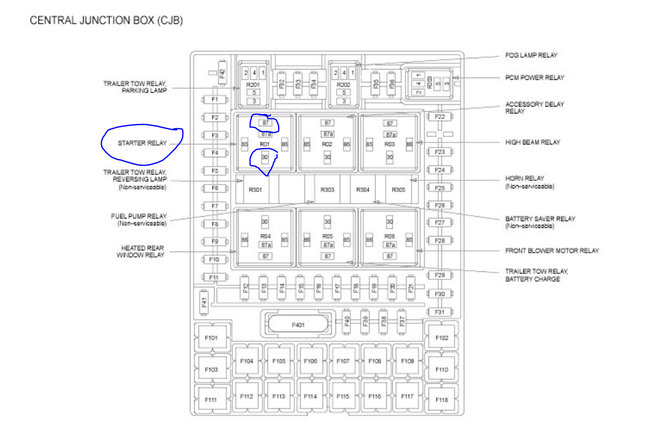

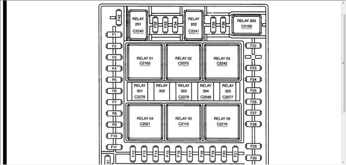

This could be a couple of things, so I'm going to go through a few checks first.
I attached a couple pics below. The first one is from the starting system wiring schematic. I highlighted two fuses I want you to check. In addition to checking the fuse condition, confirm there is power to them.
The fuses are located in the vehicle under the dash, left side. I highlighted the fuses to check in pic 2.
Let me know what you find.

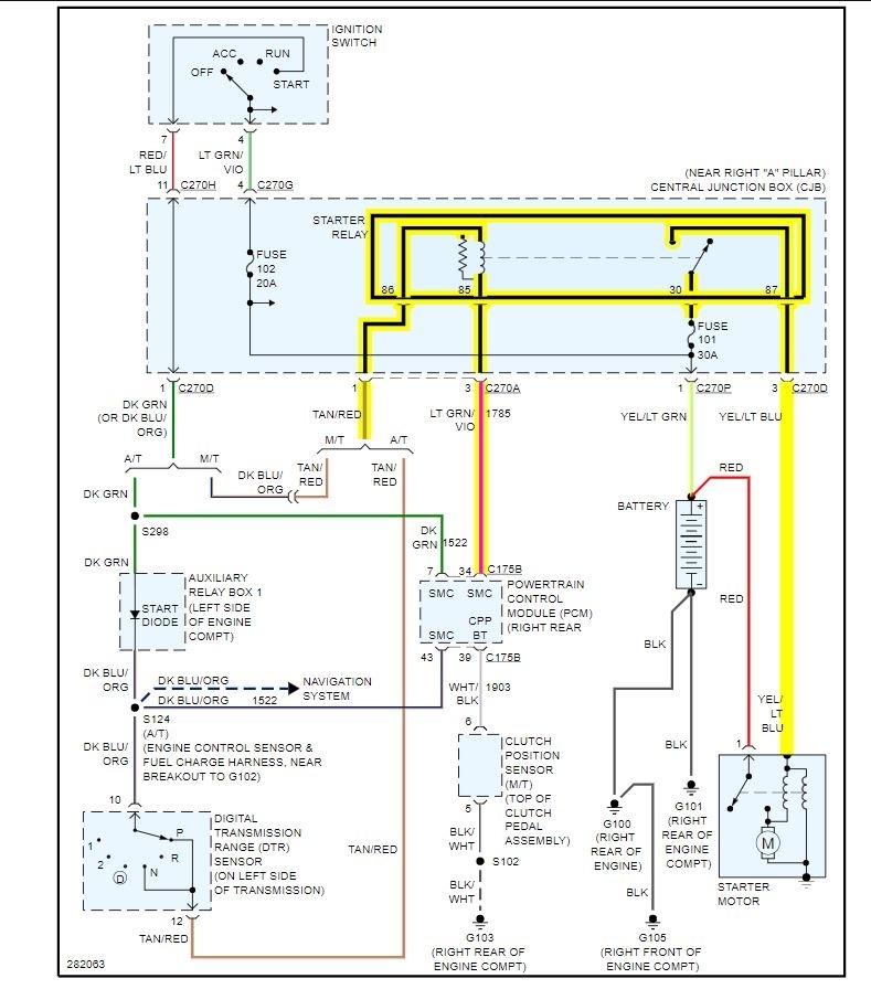

Clearly we would need to do some testing to confirm this but I have seen this before on these trucks. This is normally one of a couple things. First and foremost is the digital transmission range sensor. Basically this sensor tells the PCM what position the transmission is in when trying to start the vehicle. Basically it says if in park or neutral it allows voltage to the PCM to show it is ok to start the engine. There are times when this sensor is beginning to fail that it doesn't give the proper voltage and the PCM thinks it is in something other then park or neutral. This is a system that needs to have the correct voltage to start and anything else will be a no start.
If you put the vehicle in Drive and then try to crank the engine does it act the same as when this issue happens? All dash lights come on but the engine doesn't turn over? This is not a confirmation that this is the issue but the PCM doesn't know the difference so if it is acting the same then that is where I would start.
The next most common failure is the starter relay. However, this will normally have a clicking with it. If you hear no clicking then this is most likely not the issue. However, if you want to just swap the relay with another next time it happens and it still does it then that will confirm it is not the issue.
I attached the info about these systems. If it were me, due to this being an intermittent issue, I would just replace the relay and the TRS because they are not that expensive and not that hard of repairs. You will need an alignment tool when installing the TRS but this is explained in the info.
Let me know if you have questions and we can go from there. Thanks

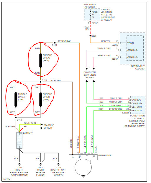

SANDTRAP
Son did reverse polarity in the truck listed above (ex). It won't even crank over. Here one click in fuse box. Checked all fuses. They are good after I replaced radio fuse and cigarette lighter fuse. Had friend test battery it is good. Tried switching pm relay with another . Still nothing. Any suggestions?
May 30, 2021 at 8:44 AM (Merged)
DANNY L
  • 5,648 POSTS

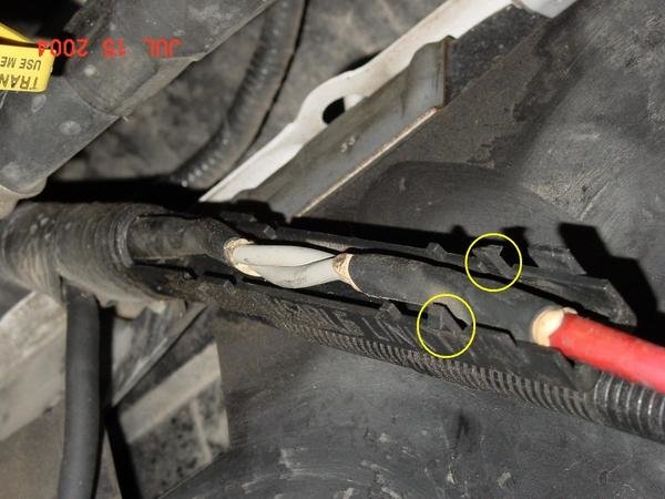

Hello, I'm Danny.
Your truck has 3 fusible links that will melt when the battery is hooked up backwards.I would suspect they melted (doing its job) to prevent damage to the electrical system. The links are in the alternator circuit.Here is a tutorial showing how to test wiring:
I've attached a picture below of the fusible link circuit circled in red and its location.Hope this helps and thanks for using 2CarPros.
Danny-
SANDTRAP
What is this connector that goes either the fusible links. It showed nothing on amp meter. Is it related to starter?
DANNY L
  • 5,648 POSTS
Hello again.
The grey color fusible links will be spliced into the black/orange striped wires coming from the battery and going to the alternator. It will look like similar to the picture I've attached below Hope this helps .
Danny.

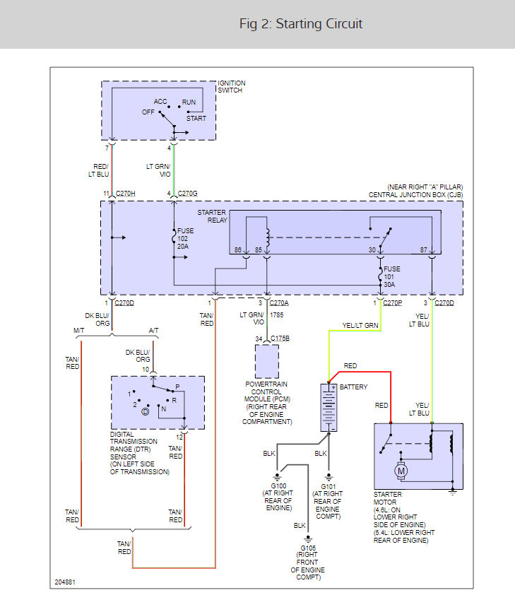

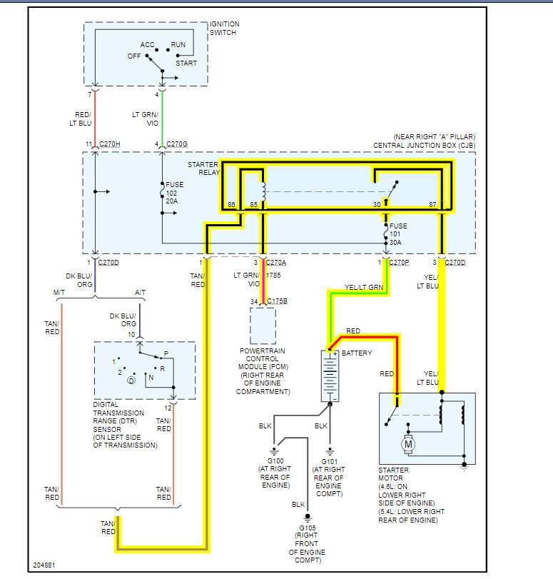

Now that the basics are out of the way.
The guide below on testing relays.
The wiring diagram for the starting circuit in your truck is attached below. Let us know if you need anything else.

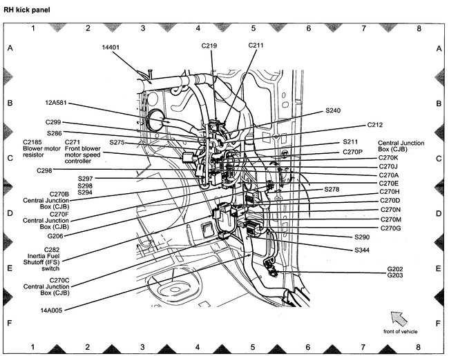

ITCHYFINGER
The truck randomly will not start. Stick the key in twist and all the lights cone on the dash. Turn it and nothing happens. Lights don’t dim or go away. Other times it starts perfectly. Weather doesn’t seem to be a factor.
The shop I took it to replaced/reprogrammed keys, the halo rfid reader in the column and reprogrammed all of the modules according to them. The also combed through the harness and fuse block and didn’t find any problems. Someone suggested I change the starter so that was done. I have played with the gear selector to see if a park safety switch could be the problem. I even parked it. Started it again in the evening and didn’t touch the shifter, then tried again in the morning and it wouldn’t start. Tried starting it in neutral, this didn’t help either.
I have owned this truck since new in 2005. I have never had issues with the starter.
Some history... it is on its second motor. It’s been in there for about 5 years. It came out of a 2001 Mustang and we had to change the flex plate. The aftermarket ones kept breaking, and we replaced with a junkyard new one that has been fine ever since. Motor runs well, with an oil leak from the pan.
May 30, 2021 at 8:45 AM (Merged)
BMDOUBLE
  • 1,139 POSTS

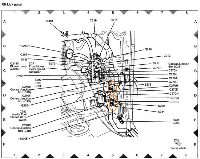

Go to your central junction box behind the passenger side kick panel, make sure all of the connectors are fully latched! I have had many come into my dealership with unlatched connectors due to the passenger's foot hitting it just right. These guides can help us fix it
and
Check out the diagrams (Below). Let us know what happens and please upload pictures or videos of the problem.
ITCHYFINGER
So just check the seating of the relays?
BMDOUBLE
  • 1,139 POSTS
No the electrical connectors on the side of the fuse box. I've highlighted the ones that you should look at.

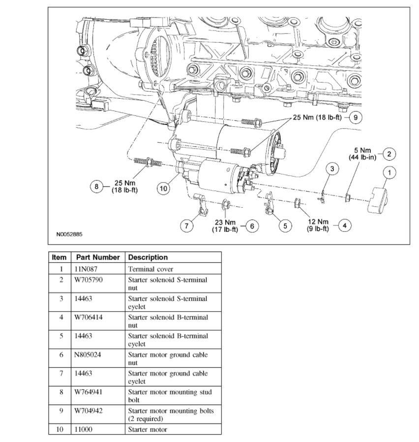

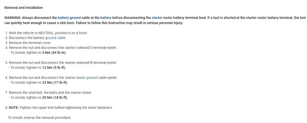

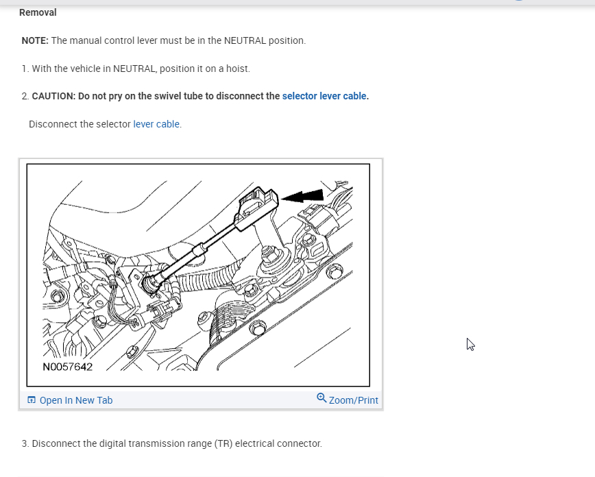

  • 55,224 POSTS
It sounds like you have a starter motor that has gone out. To confirm the problem lets use a test light on the the big cable going to the starter. When the engine is cranked over the test light should light up. Also we should run the codes
Here is a guide to help you.
This guide will give you an idea of what you are in for when doing the job.
and
Here is a wiring diagram of the starter circuit check to see where you are loosing power if the starter checks out.

Check the starter relay at C2163-see below
