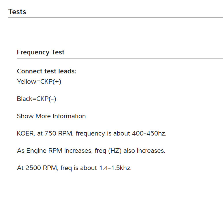

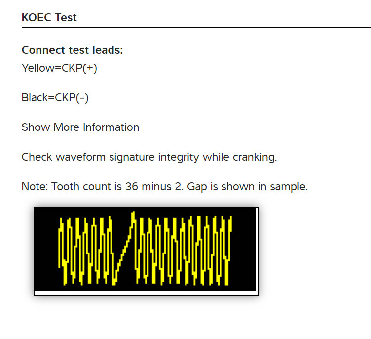

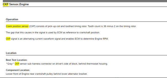

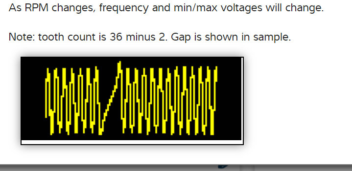

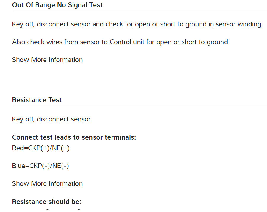

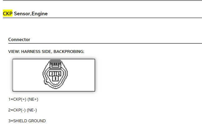

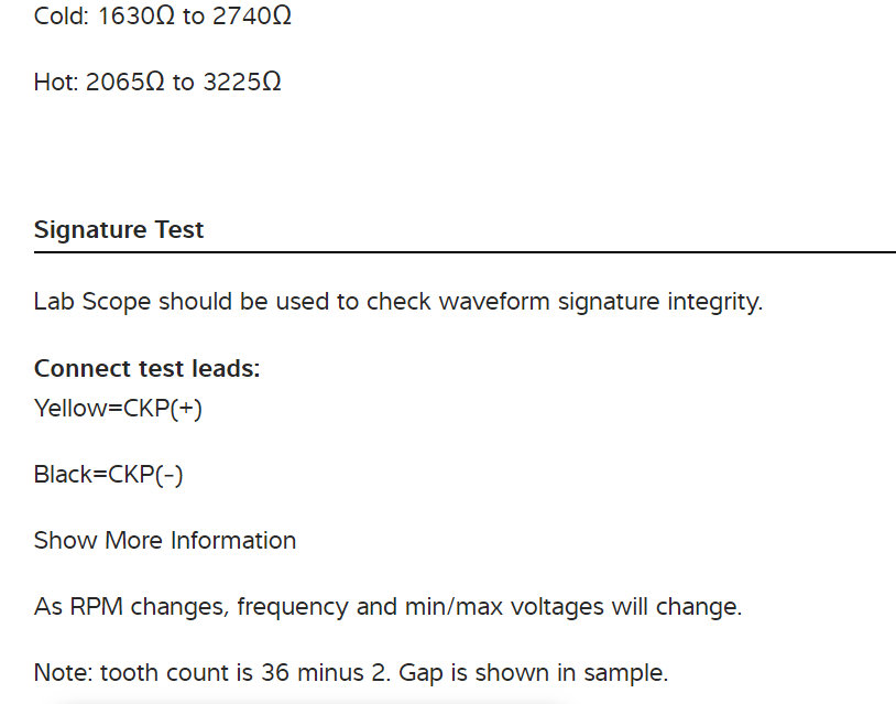

This could be a problem with your crankshaft position sensor. Your vehicle's Crankshaft Position Sensor (CKP) is responsible for letting the Power-train Control Module (PCM) AKA, "computer" know where the engine is in it's four stroke cycle. Specifically, it keeps track of number one piston and let's the PCM know when it is at Top Dead Center of the compression stroke. The PCM keeps track of everything else from there. If the CKP is not working, or has intermittent failures due to a bad connector, or frayed wiring the PCM can't keep track of the engine's cycle and therefore won't start.
I have included a few links down below for you to go to.
https://www.2carpros.com/articles/how-a-crank-shaft-angle-sensor-works
I have also included a diagnostic troubleshooting flowchart for the CKP in the diagrams down below. Please go through the guides and flowchart and get back to us with what you find out.
Thanks,
Alex
2CarPros
Thursday, March 21st, 2019 AT 9:37 PM

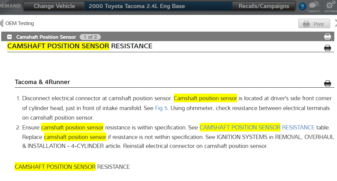

Hello again.

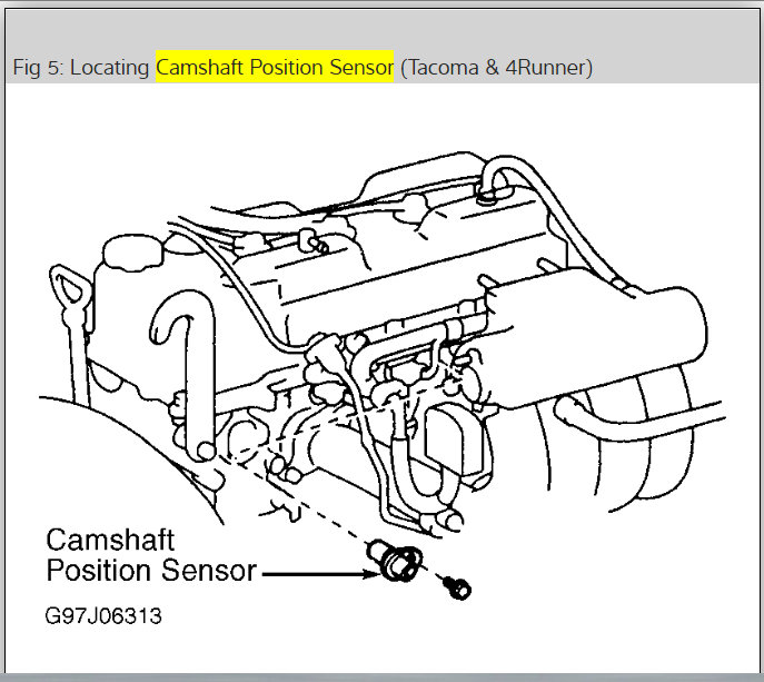

This could be a problem with your Camshaft Position Sensor (CMP) as well. It sounds to me that given the intermittent nature of the failure that if it is the CMP it will definitely be heat related. I have included a diagnostic guide from the factory to test the CMP on your vehicle in the diagrams down below. Please go through it and get back to us with what you find out.
Thanks,
Alex
2CarPros
Monday, April 1st, 2019 AT 6:31 AM

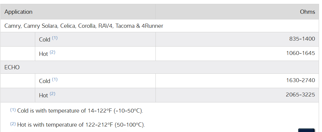

RIDERD33
I just tested the CMP and the resistance is 1043 at 55°. This is within spec you provided so I assume that isn't my problem. Any more ideas?
Saturday, April 6th, 2019 AT 1:39 PM

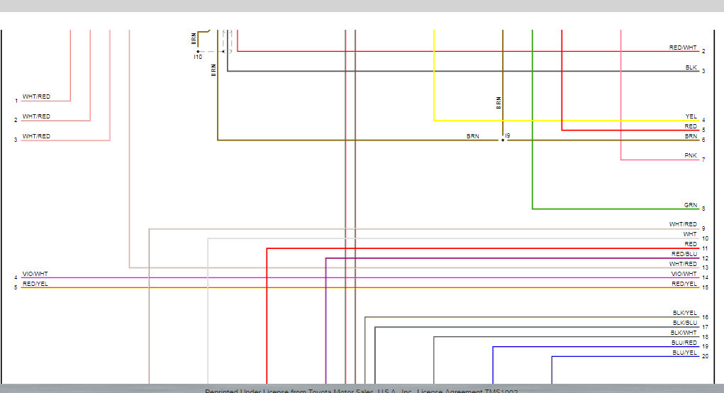

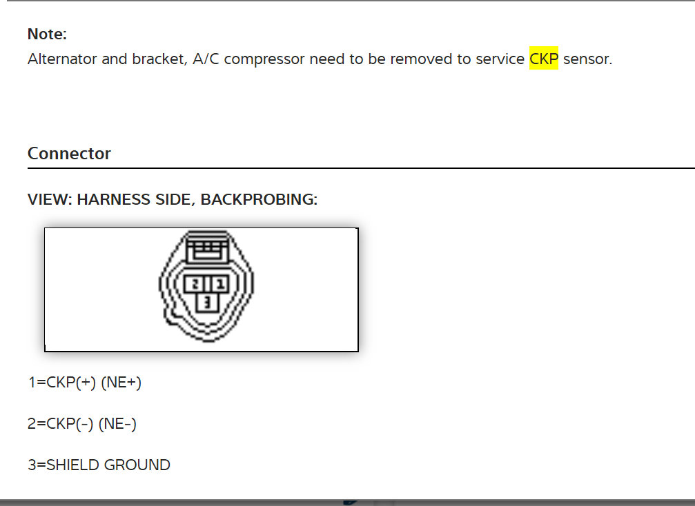

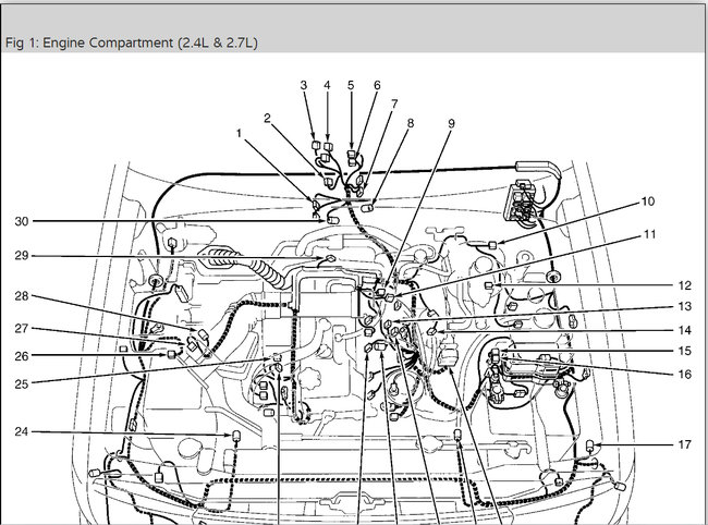

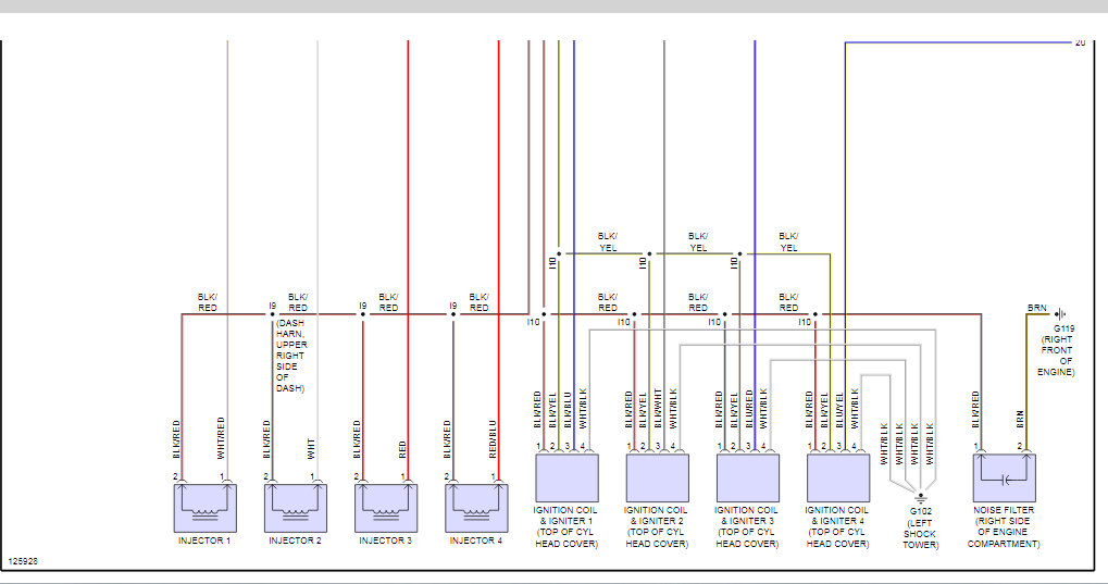

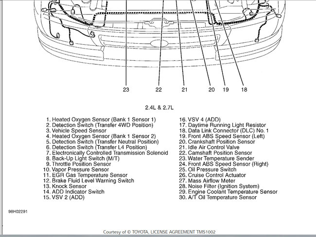

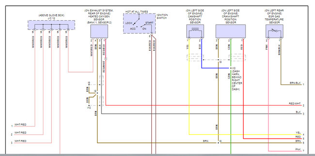

I know, don't you hate that. If you take it into a shop, guaranteed it won't do it when you guys go for drive to show the mechanic what's wrong. Given the intermittent nature of the no start it is either going to be the CKP or the CMP sensor or the wiring to each that is going out but not quite there yet. The sensors usually when they are going bad will work great when they are cold but will start to fail when get hot. I have included in the diagrams below the wiring diagram with the CKP and CMP sensors on it. Check the wiring going to them and get back to us with what you find out.
Thanks,
Alex
2CarPros
Saturday, April 6th, 2019 AT 10:56 PM
