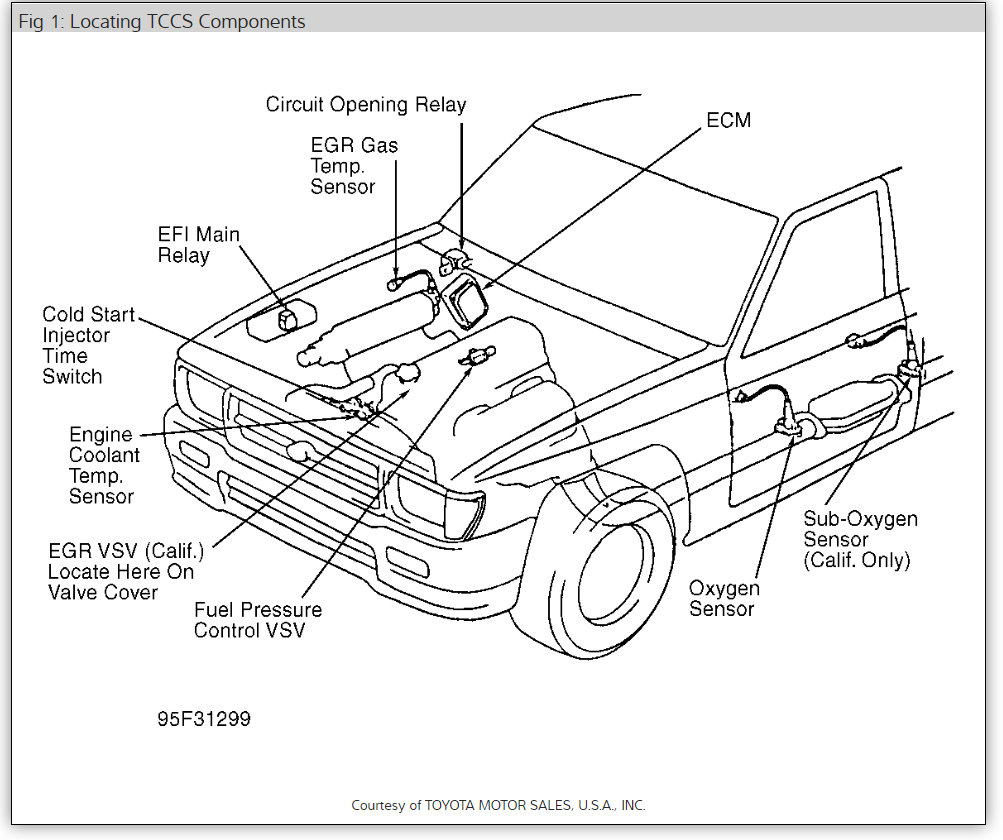

The toyota tacoma truck engine cranks but won't start when the outside temperature ranges from 95 F - 110F. I open the hood and let it cool down, then the engine cranks and actually starts. What could be the problem?

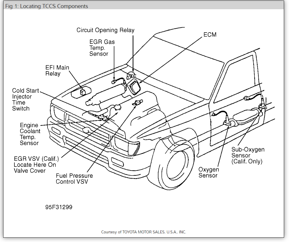

What happens is the EFI relay gets hot and stops working I have seen this p[problem before. Here is the location of the relay and a guide to help you test it.
Check out the diagrams (Below). Please let us know what you find.

Thanks for the guide this fixed my truck.

The EFI relay fixed my car too FYI
