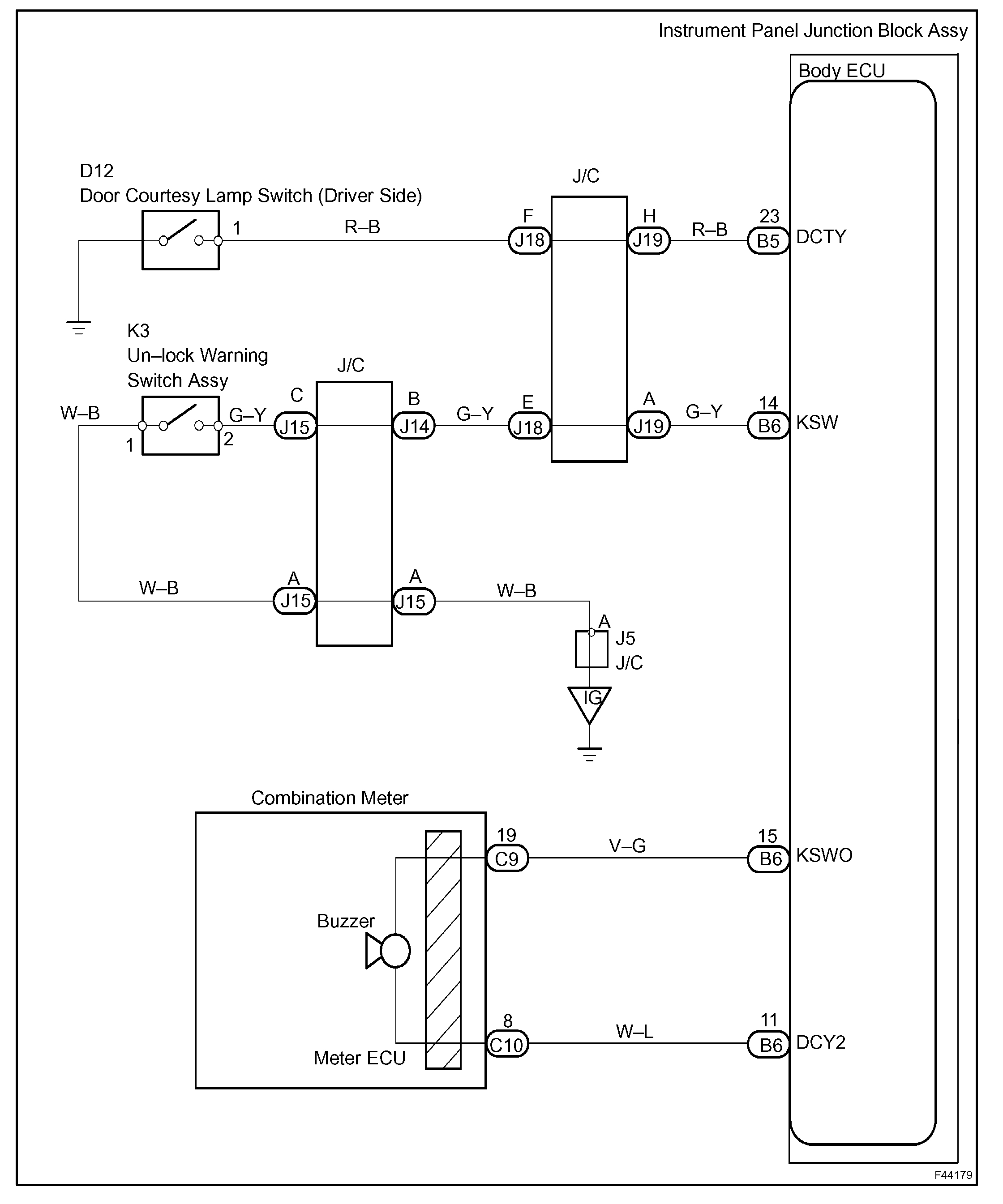

I have the vehicle listed above sr5 model. For a long time when I open the drivers side door with my keys in the ignition. I do not here the warning/chime to tell me my keys are still in the ignition. So because of that I have had to call AAA to come and open my truck up. Any ideals what could be the problem/where should I start to look? Thank you.
Mar 8, 2020 at 12:40 PM
  • 110,194 POSTS
Is this an intermittent problem or does the warning buzzer never work? When the ignition switch is OFF, the key is in the ignition key cylinder, and the driver side door is opened, the body ECU operates the combination meter to cause the buzzer to sound. (see pic 1 for schematic)
This could be related to a sticking door switch. Pay attention to see if the dome lights every fail to turn on.

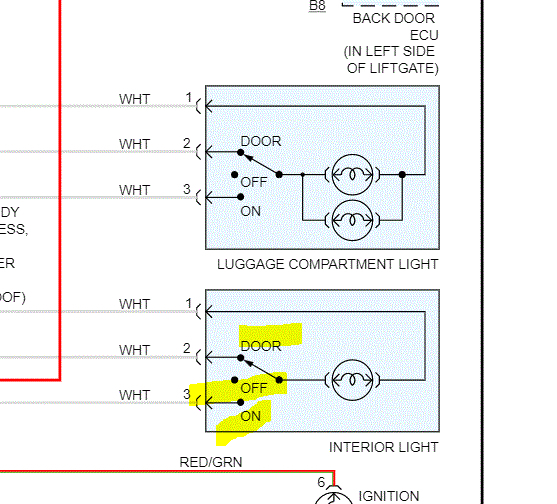

I will try your advice some time tomorrow. I am a little confused here. Should the dome lights be in the on or off position to see if they fail?

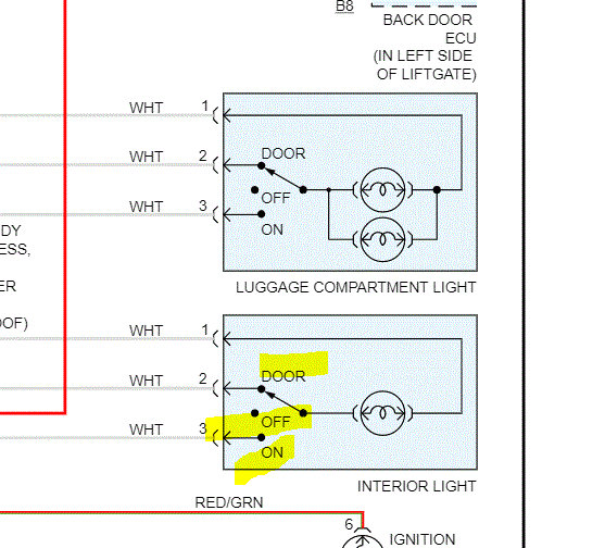

  • 110,194 POSTS
Usually, you can turn the dome light on all the time, only when the door opens, or off all the time. Make sure it is in the right position. If you look at pic 1, it should help make sense of what I am saying.
I will watch for your reply.
