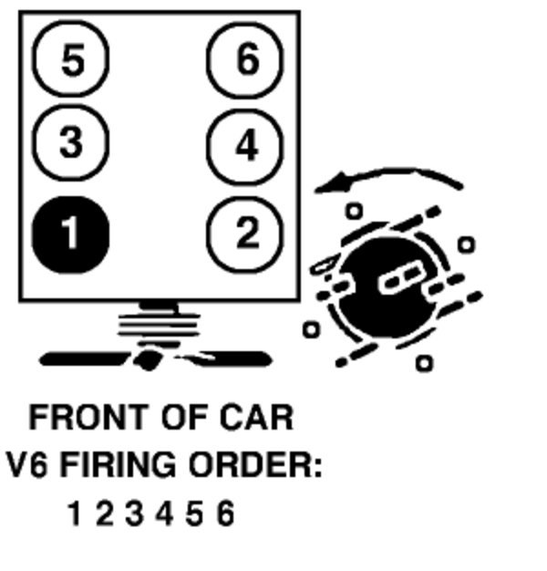

I need to know what is the firing order please?
Thanks!
May 22, 2008 at 12:08 PM
  • 55,423 POSTS
Here is the firing order fro your engine with a diagram below.
FIRING ORDER 1-2-3-4-5-6
no.1 cylinder is front cylinder on right side of engine
no.2 cylinder is front cylinder on left side of engine
no. 1, 3 and 5 cylinders are on the right
no. 2, 4 and 6 cylinders are on the left side

My #3 & #6 cylinders are misfiring & I just want to know the firing order. Thank you

See attachment for info on cylinder order.
