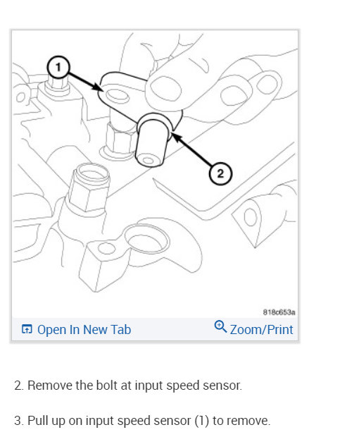

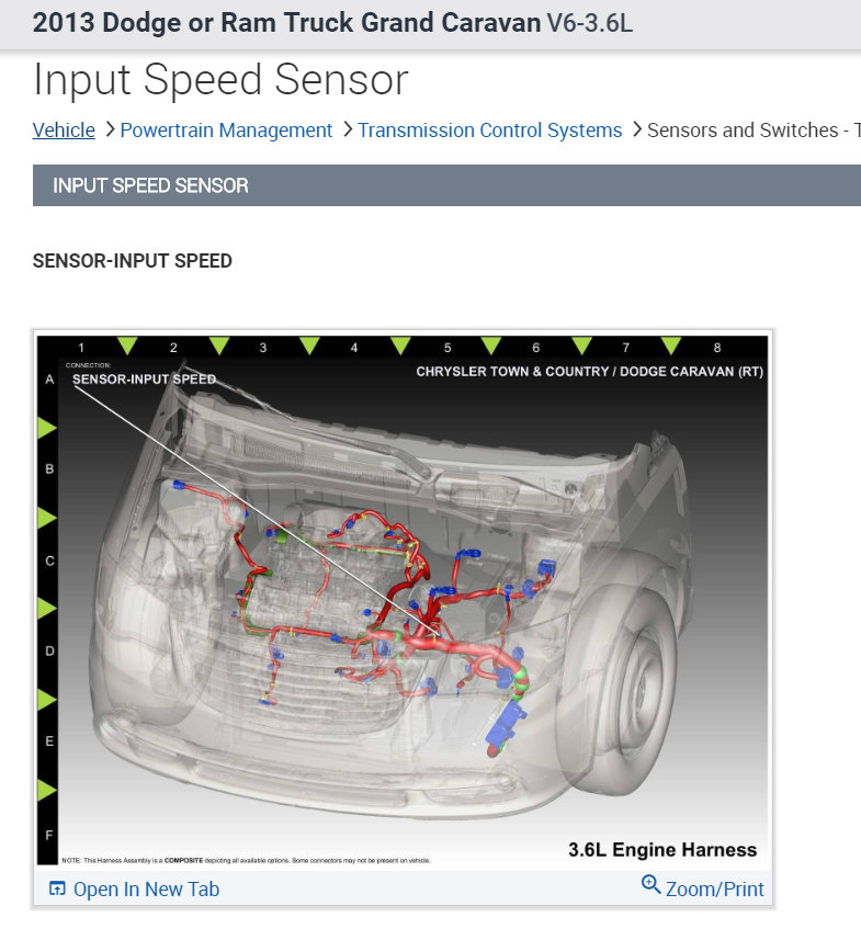

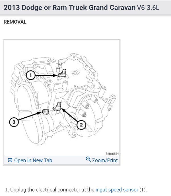

It sounds like you have a turbine shaft speed sensor that is not working right which may or may not trigger a trouble code. Here is a guide to help us run the codes and the location of the sensor below:
Dec 27, 2018 at 10:07 AM

Did not show any codes when nbn I checked this morning, but I disconnected the battery and reconnected it after twenty minutes and it has ran fine all day. If it happens again I'll update.

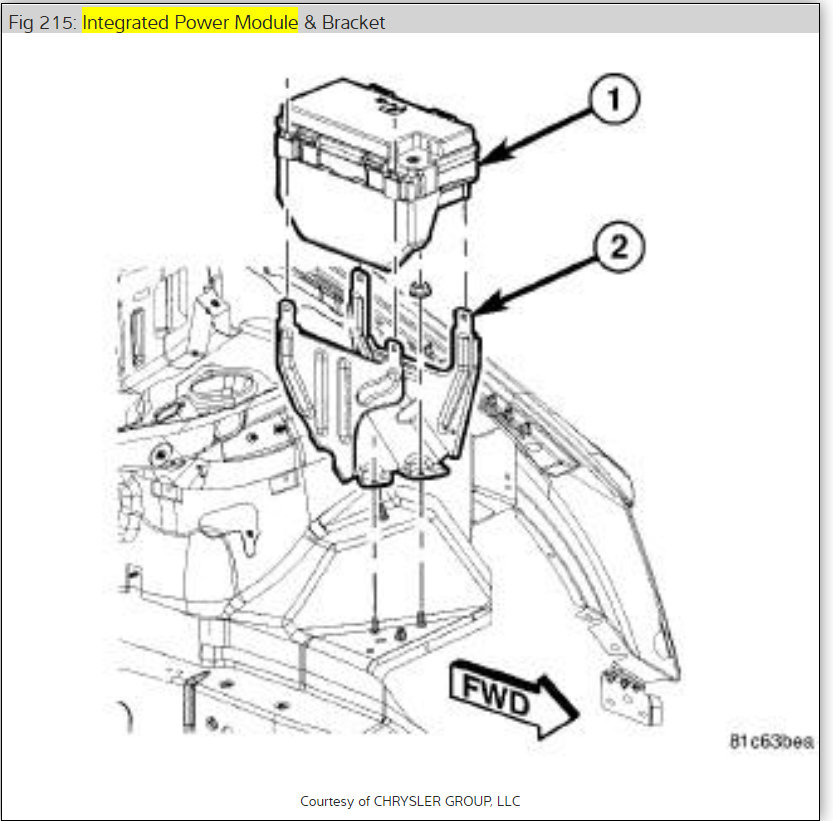

  • 55,224 POSTS
Okay it sounds like the TIPM could be going out here it its location so you can check it out. If you need to replace it the unit self initializes so no programming is necessary. Use 2CarPros anytime, we are here to help. Please tell a friend.

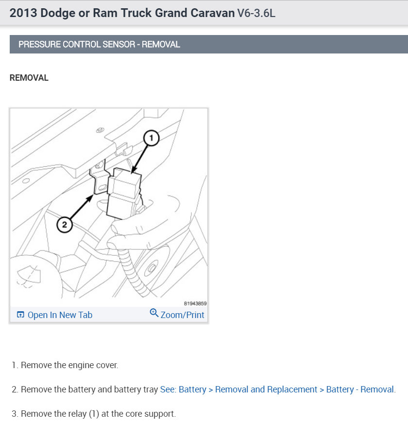

It just happened again and this time it shows a code of P0845.

P0845 Transmission Fluid Pressure Sensor/Switch B Circuit is the code which will make the transmission not shift. here is the location of the sensor so you can check it out in the diagrams below check the electrical connector at he sensor as well. Check out the diagrams (below). Please let us know what you find. We are interested to see what it is.

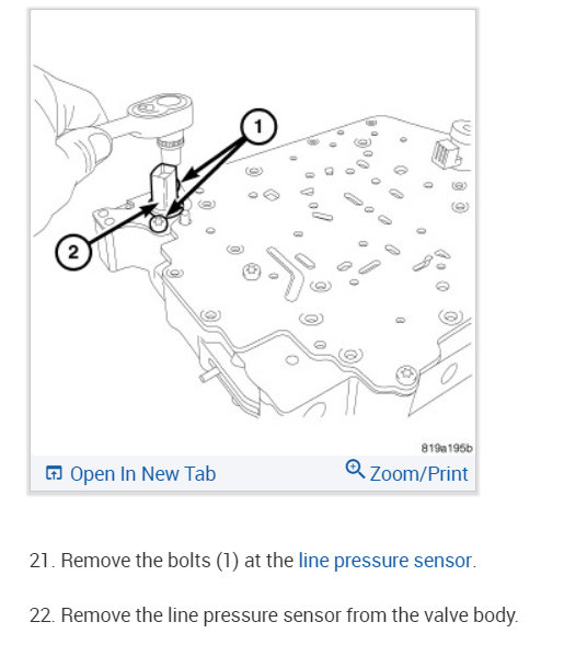

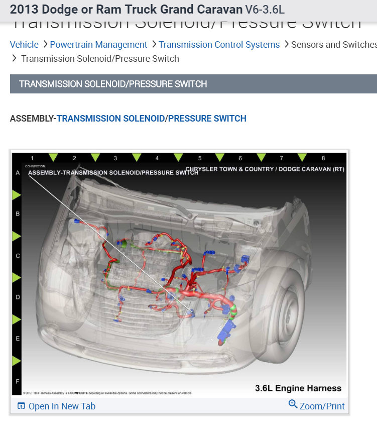

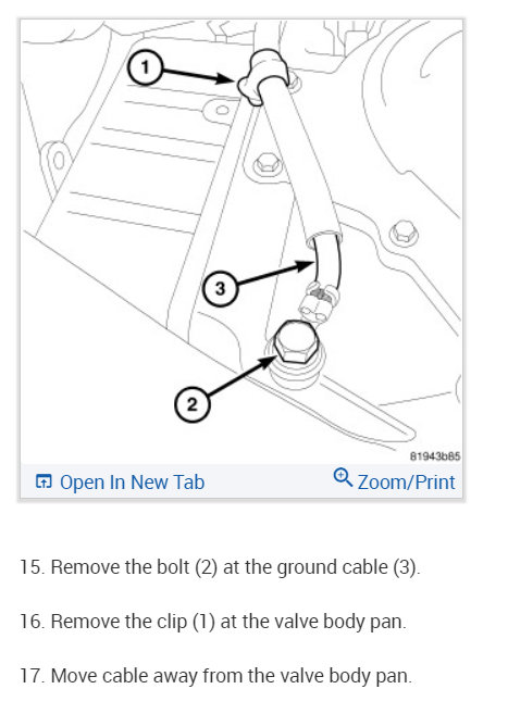

So I checked the sensor/relay and the switch plugged into the transmission which that was a pain to get off. They both looked fine, cleaned both, ohmed out the relay and it ohmed out to 63ohms. Battery was pretty bad so I cleaned that too.

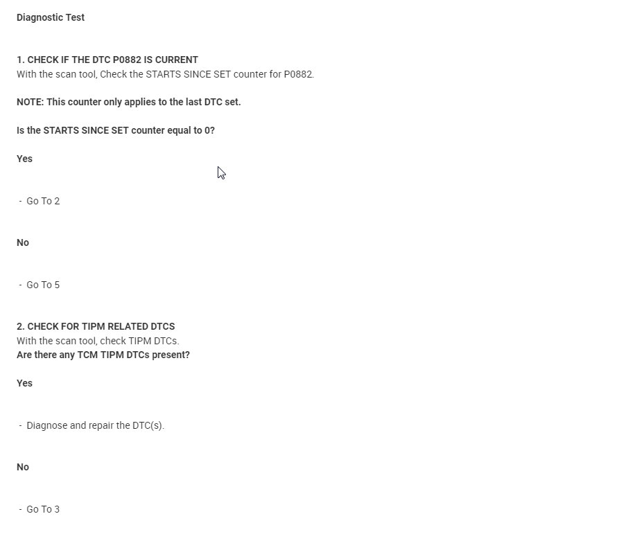

VJBUCK007

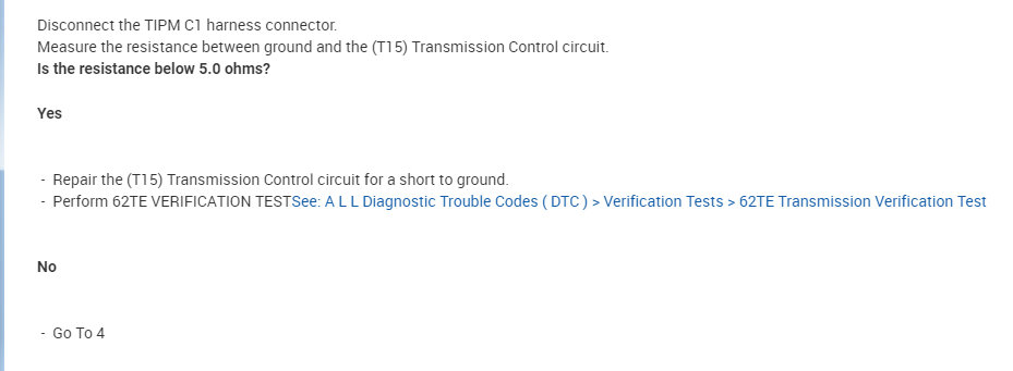

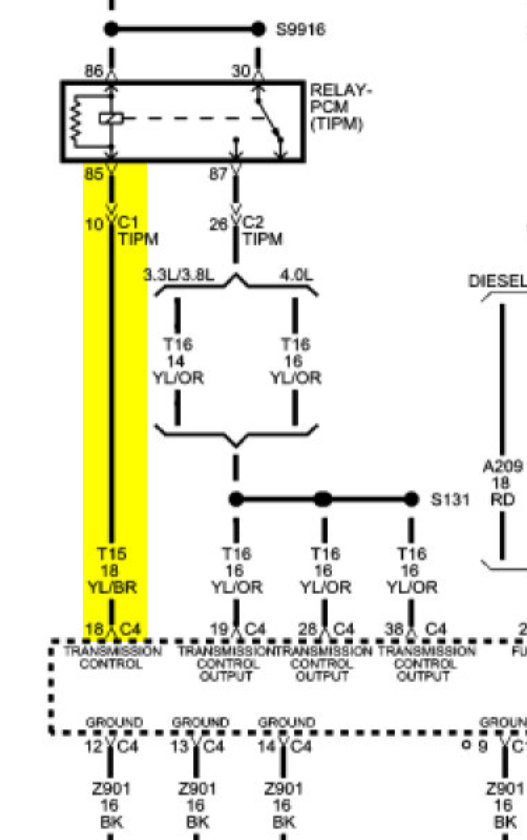

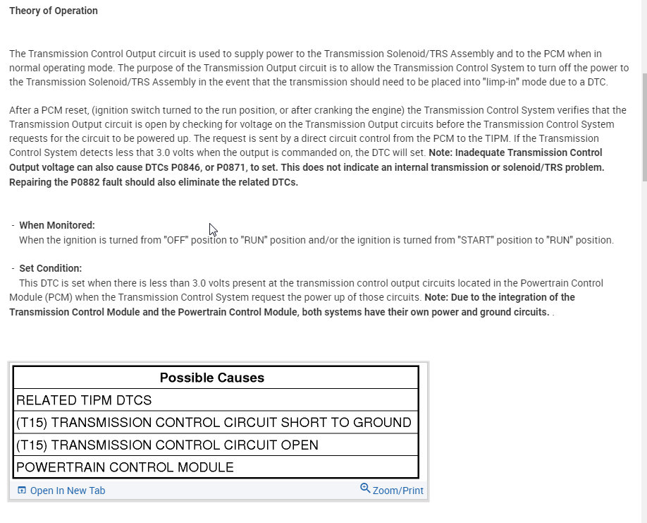

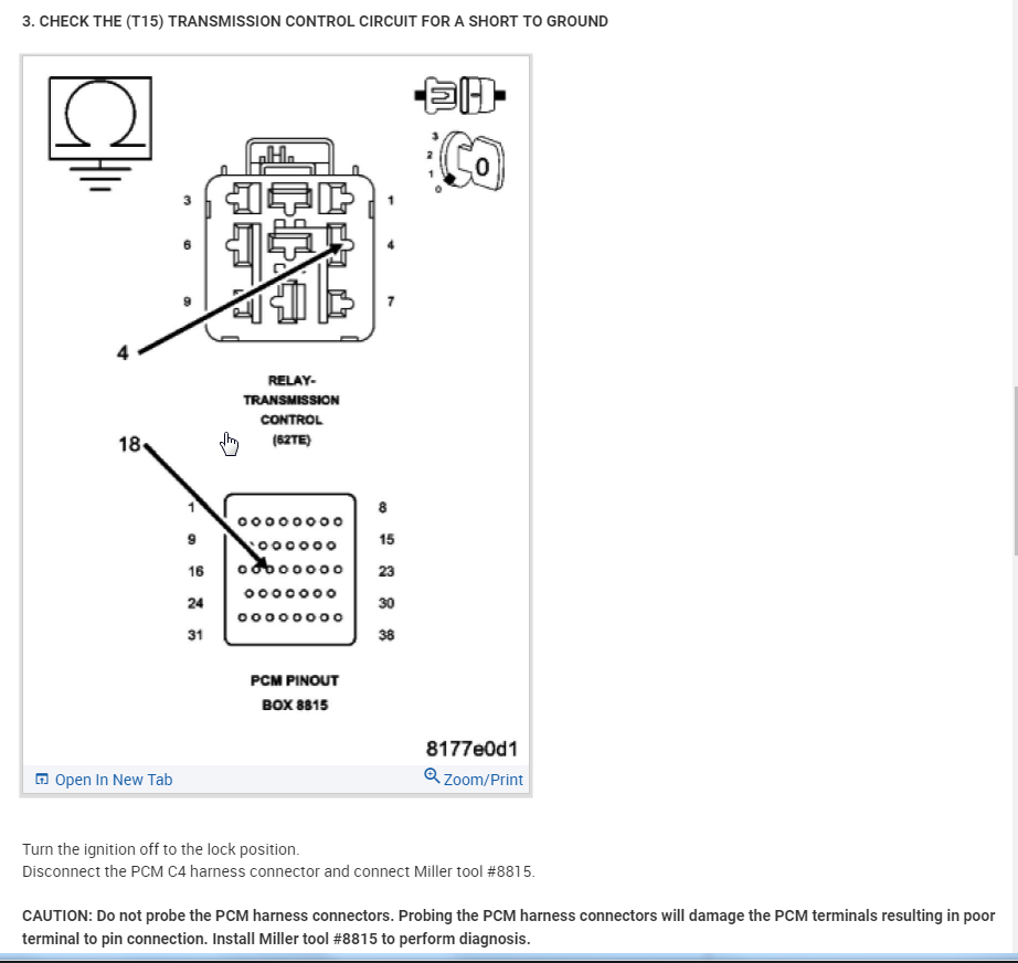

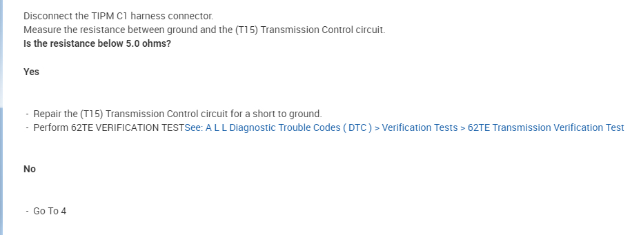

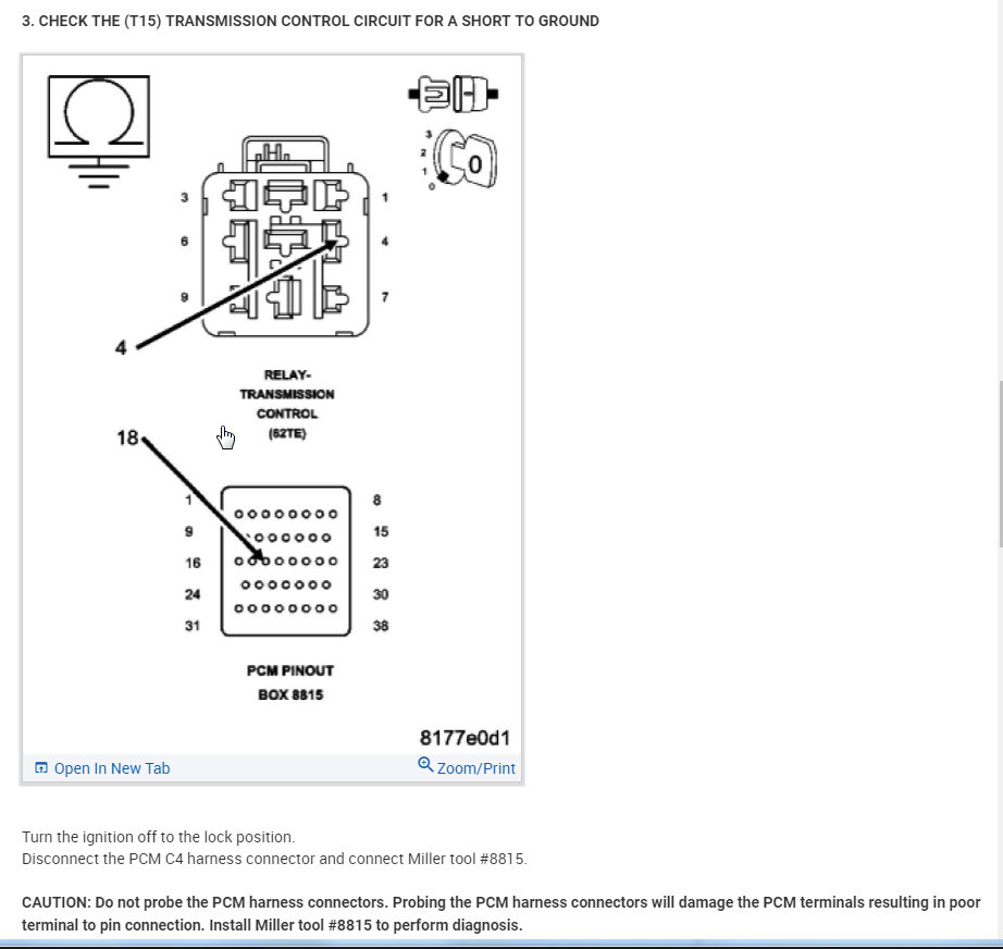

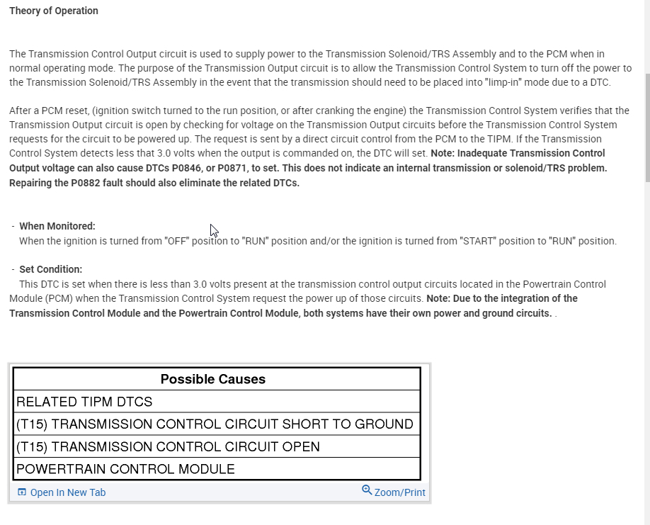

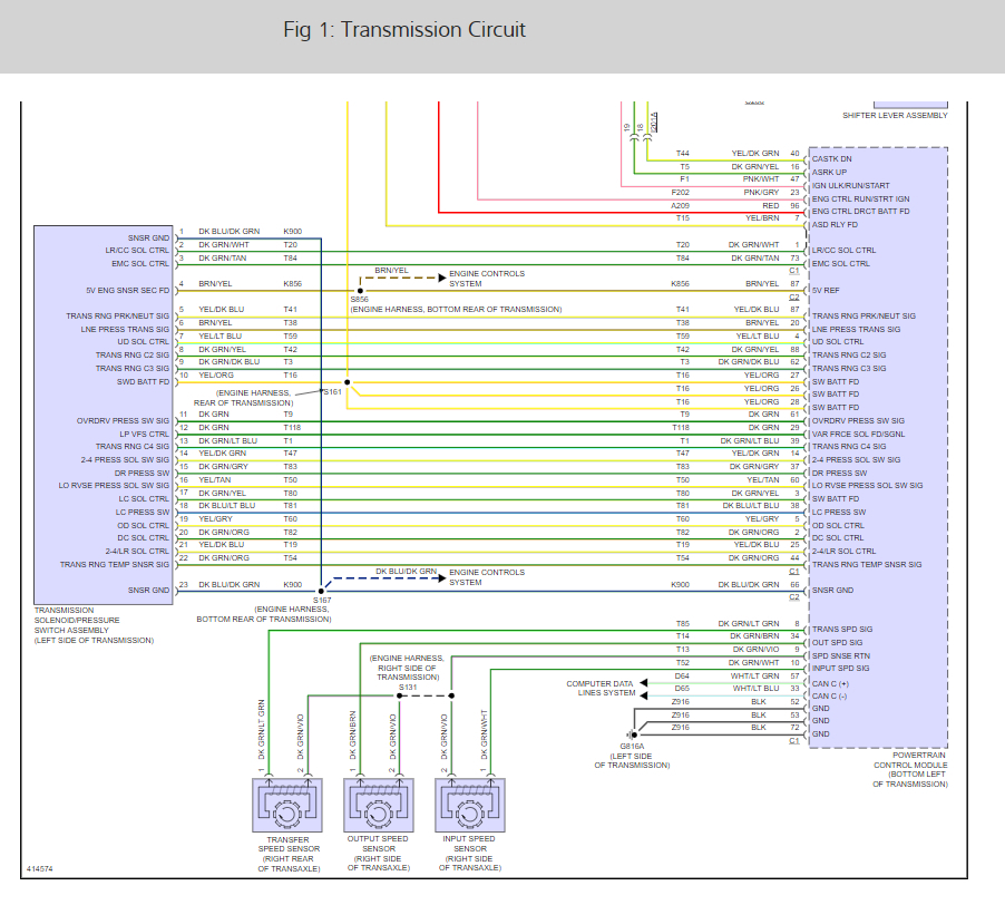

P0882 code is saying, the ECM has detected less than 3 volts at the transmission control relay output circuit.
May 20, 2021 at 8:57 AM (Merged)

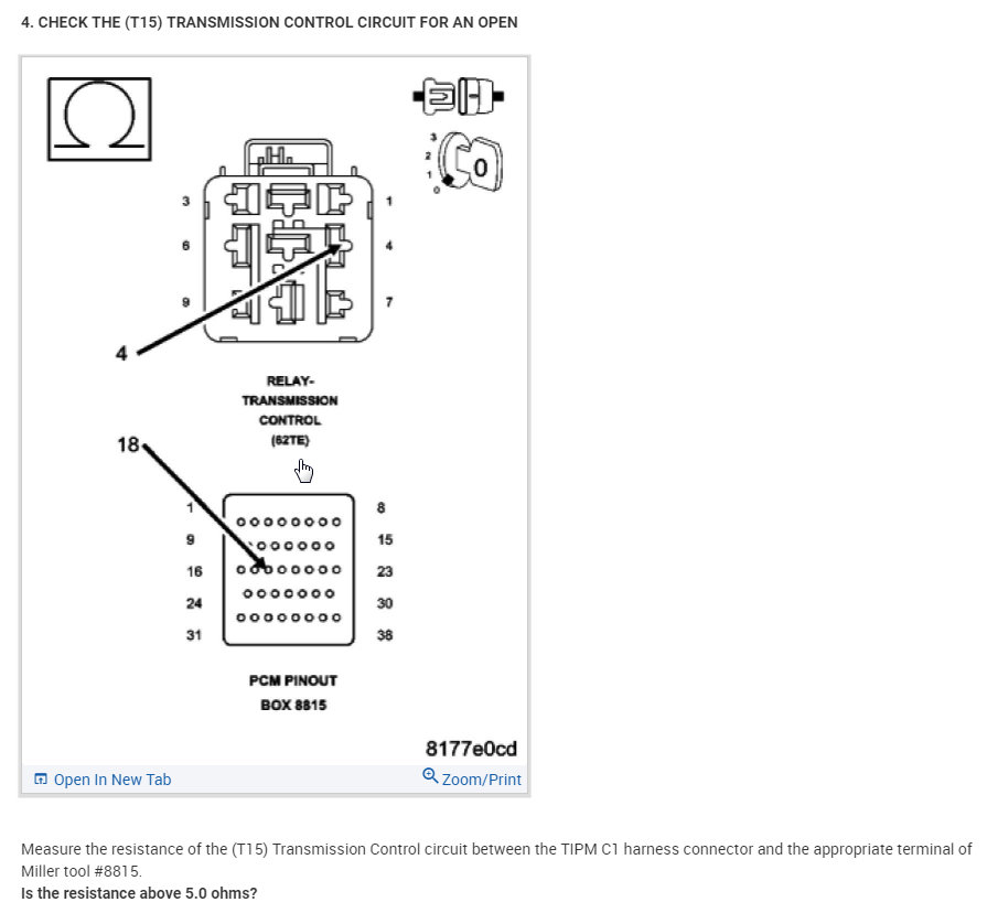

Hi VJBuck007,
More than likely you have a wiring issue. Assuming this is your only code, I would suspect the T15 circuit is shorted. I attached the test you need to follow to figure it out. It also has a theory of operation that gives a pretty good idea what is happening.
Let me know if you need more assistance.

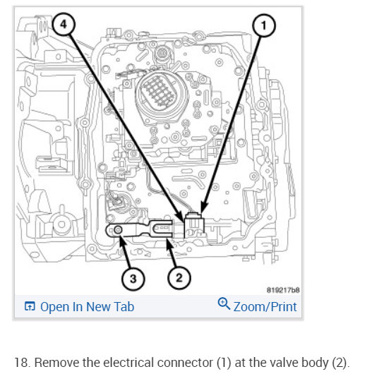

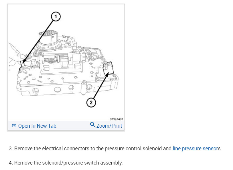

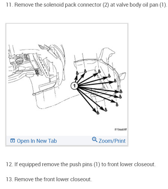

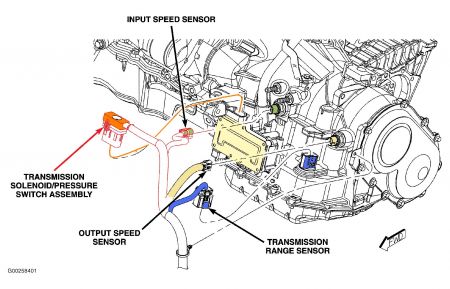

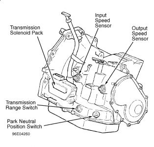

BMRFIXIT
  • 19,053 POSTS
most likely its the tranny solenoid pack need to get the codes cycle key on off on off on read trouble codes in the odometer area and let me know what you have
https://images.2carpros.com/forum/automotive_pictures/99387_Graphic9_24.jpg

NEW_TO_DODGE
  • 35 POSTS
I read the code from the odometer area and it is giving me a P0700 and nothing else. What does that refer to? Thanks.
May 20, 2021 at 8:58 AM (Merged)
BMRFIXIT
  • 19,053 POSTS
P0700 is a general code for tranny it just saying that you have an issue in the tranny and the TCM have codes have to get the TCM scanned for codes you need the help of a scanner here good luck let me know this guide will help.

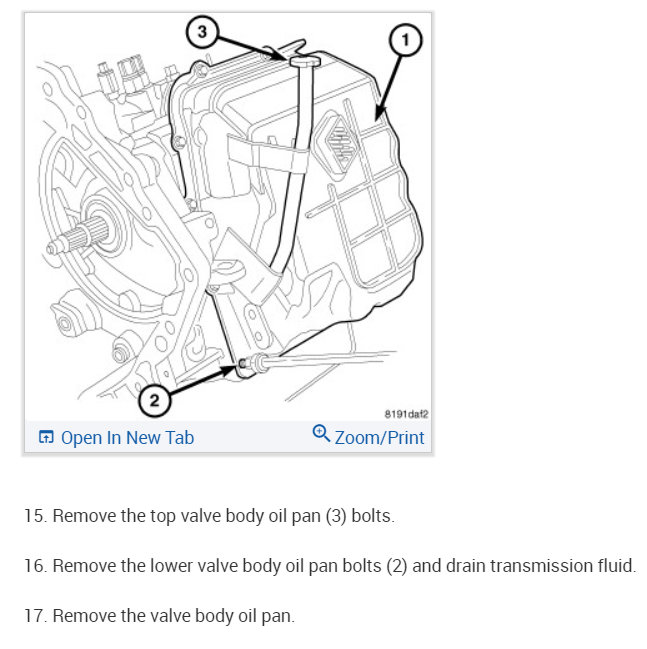

I got the van back from the shop today and the wire harness underneath the fuse block and battery had corroded causing my problem. The wires from the transmission control relay had broken causing the non shift problem. All is well now.

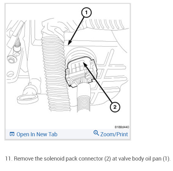

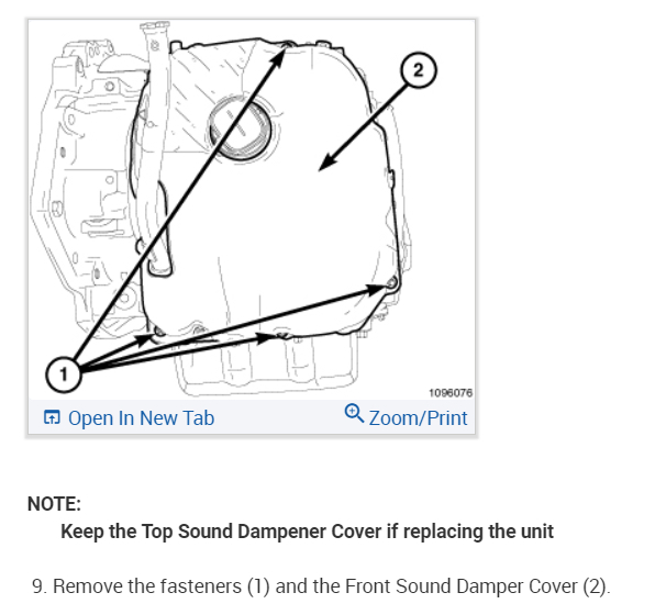

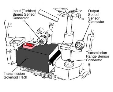

BMRFIXIT
  • 19,053 POSTS

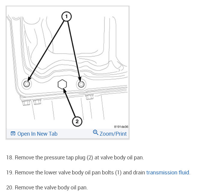

Check and replace solenoid pack on the side of the tranny Does your selector show what gear you are in P R N D when you move it let me know
https://images.2carpros.com/forum/automotive_pictures/99387_caravan_tranny_1.jpg

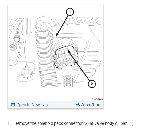

BMRFIXIT
  • 19,053 POSTS
suspect tranny solenoids pack need to have it scanned for codes or cycle the ignition key on off on off on read P0000 codes in the odometer area
https://images.2carpros.com/forum/automotive_pictures/99387_Graphic9_13.jpg

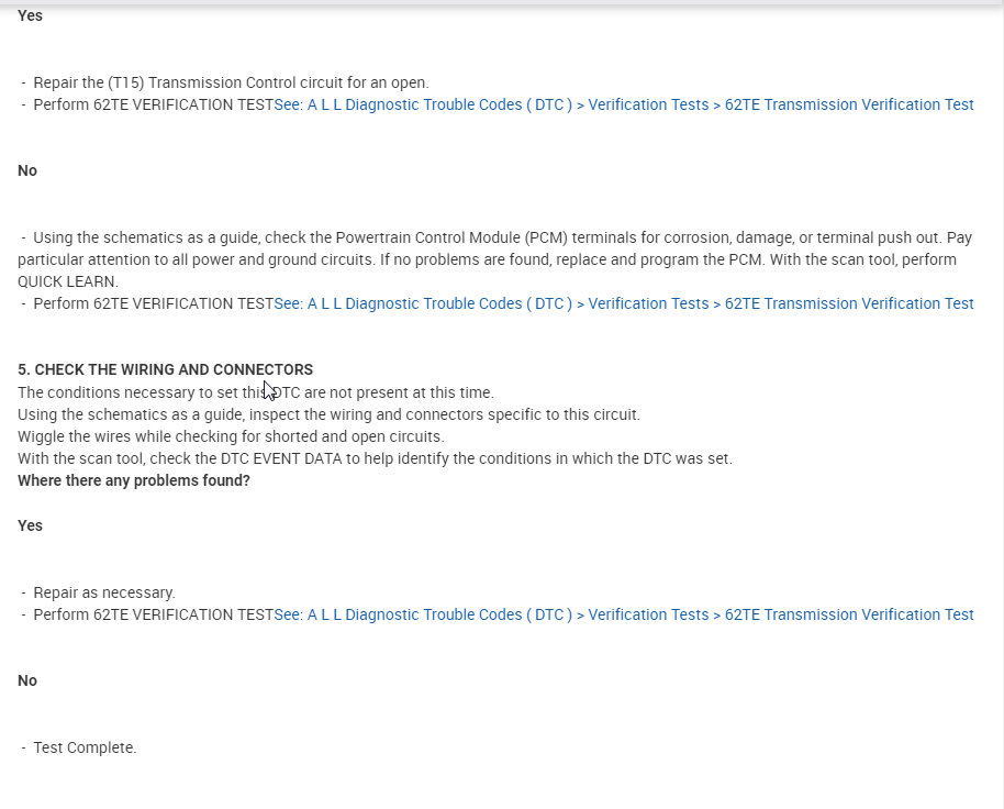

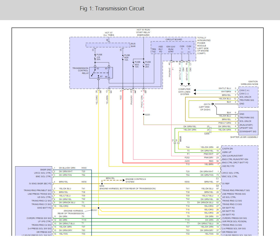

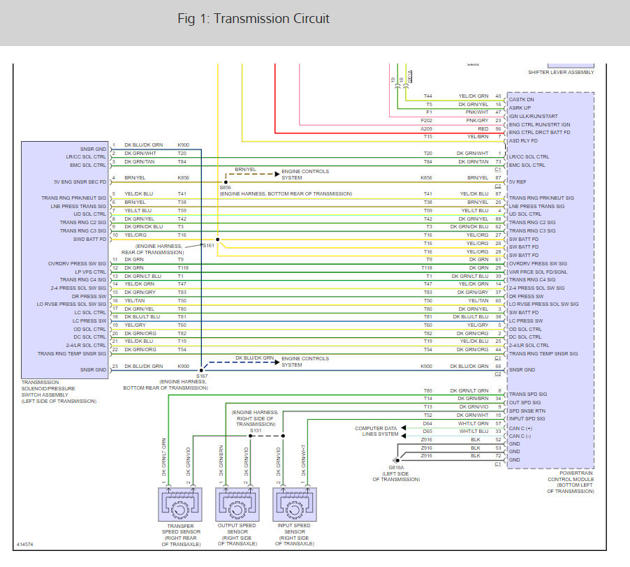

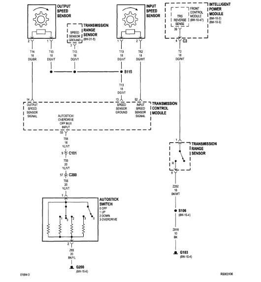

Good afternoon,
I attached a list of issues below for this. From the looks of the code, it is an electrical issue, not a component issue.
Do you have a scan tool that can read the transmission and a voltmeter to do some checks?
P0720 - OUTPUT SPEED SENSOR ERROR
When Monitored and Set Condition:
When Monitored: The transmission gear ratio is monitored continuously while the transmission is in gear.
Set Condition: If there is an excessive change in output RPM in any gear.
Possible Causes:
Intermittent wiring and connectors
Output speed sensor signal circuit open
Speed sensor ground circuit open
Output speed sensor signal circuit short to ground
Output speed sensor signal circuit short to voltage
Speed sensor ground circuit short to voltage
Output speed sensor error
TCM - output speed sensor

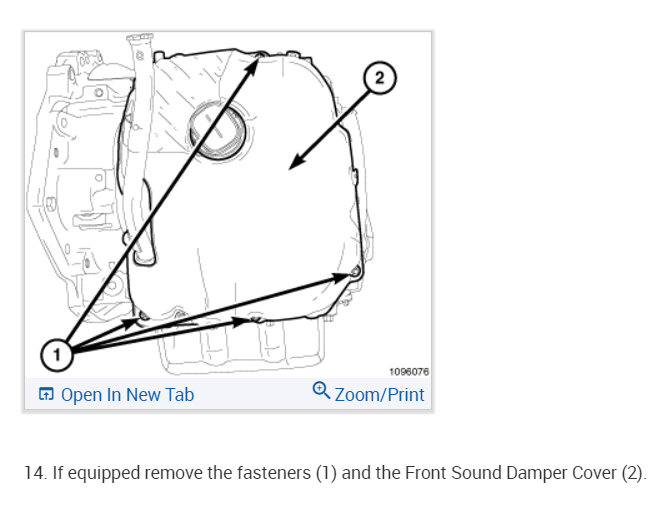

BMRFIXIT
  • 19,053 POSTS
The very common is tranny solenoid mounted on the side of the tranny 2nd is the speed sensors by scanning the tranny module for codes you can identify the issue
https://images.2carpros.com/forum/automotive_pictures/99387_caravan_tranny_8.jpg
https://images.2carpros.com/forum/automotive_pictures/99387_caravan_tranny_05_1.jpg
