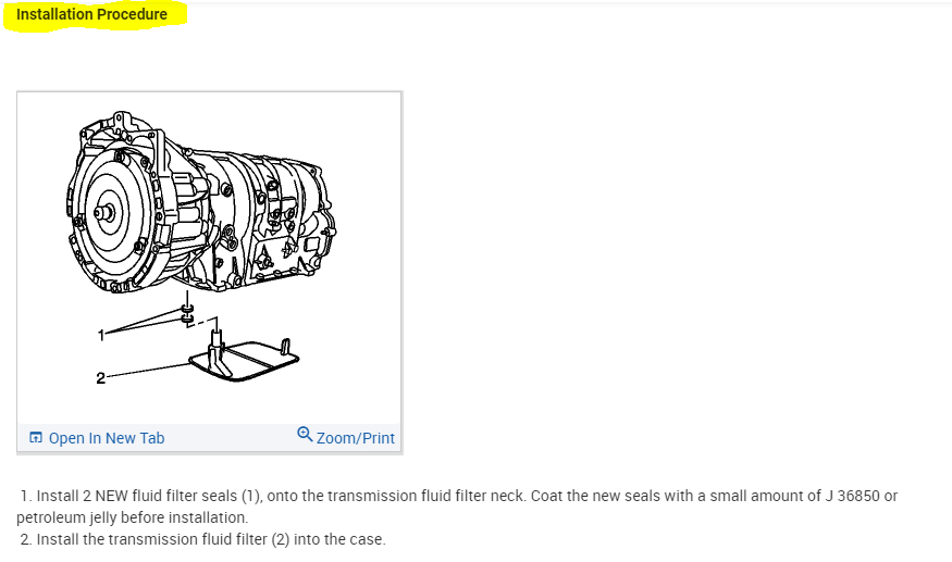

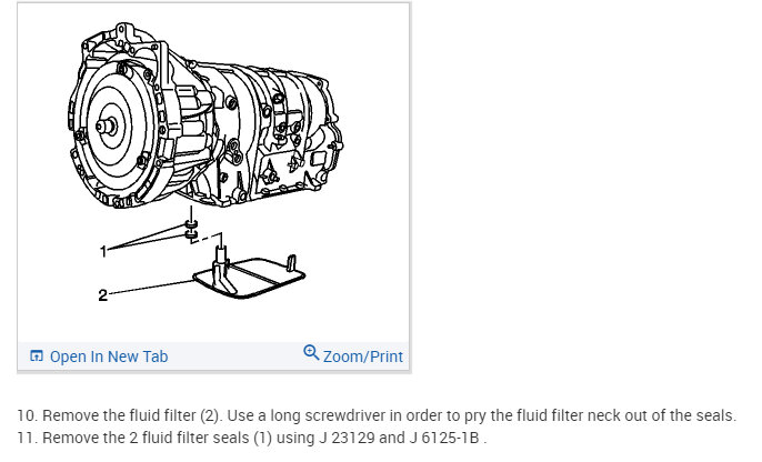

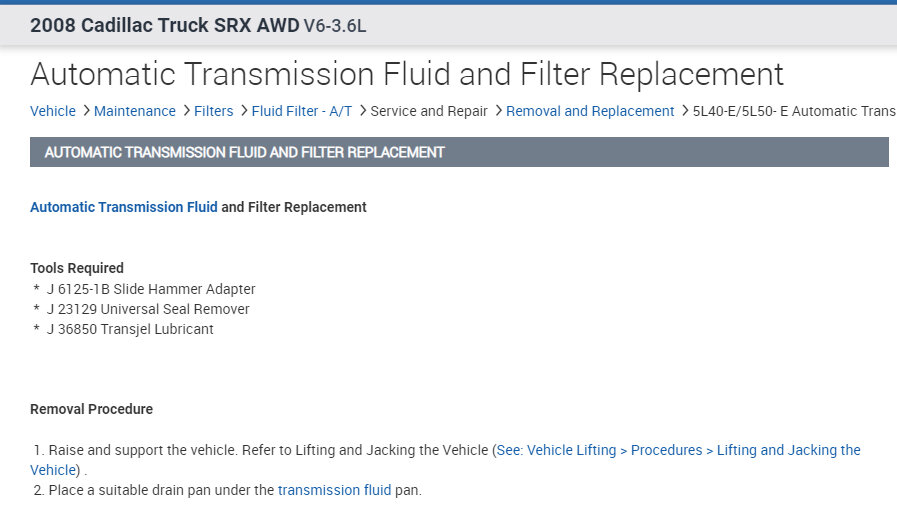

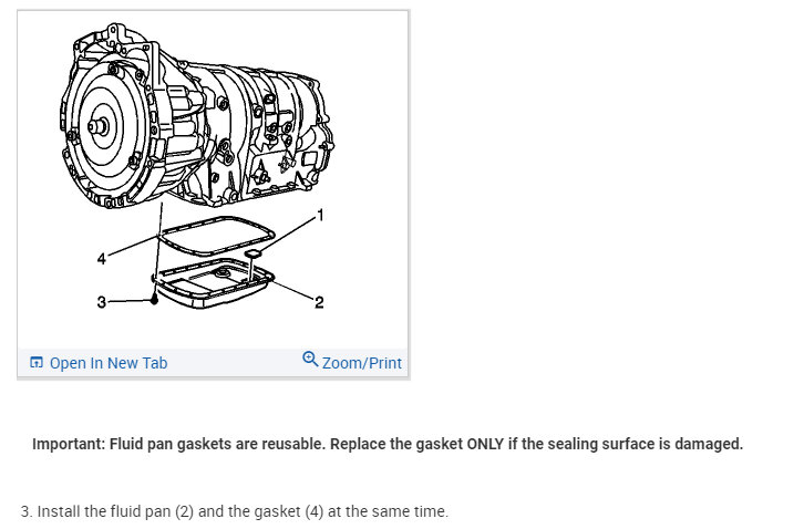

As far as the filter/pan, I attached the directions below. When you do this, there is a rubber O-ring at the top of the filter, where it attaches to the valve body. Make sure that it is removed and a new one is fully installed before installing the new filter. Lubricate it with trans fluid to make it a little easier.
Let me know if this helps.

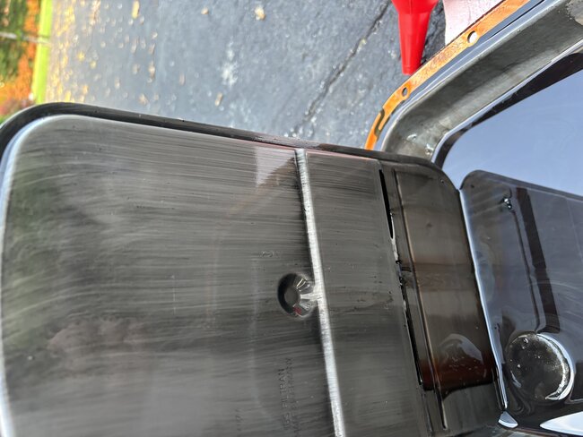

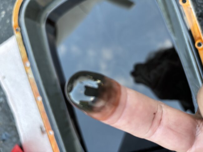

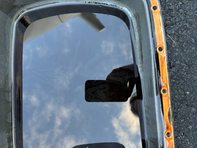

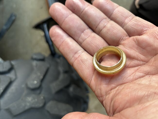

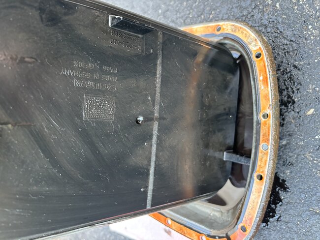

Okay, I removed the transmission pan and filter. I will enclose pics of what I found. My questions are as follows. Is any of this normal? There is a layer of trans fluid/black sludge at the bottom of the pan. What’s the best method to clean it up? Solvent? Brake cleaner? Carb cleaner? The filter itself is supposed to be black plastic on one side and silver metal on the other. Is it normal for the silver side to be black with sludge? The filter itself appears black, is the normal color supposed to be white when new? Lastly, one of the enclosed pics is of a white round plastic ring which was on the neck of the filter that attaches to the transmission. Is this the o-ring? I was expecting something rubber for an o-ring, but found nothing on the filter or left behind on the transmission resembling an o-ring. Thanks in advance. I already plan on replacing the filter and trans fluid that came out during removal. Please advise.

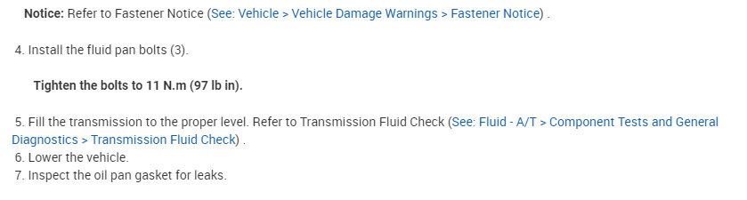

Here’s the pics. Another thing, do you know the torque for the pan bolts when I reinstall?

  • 109,885 POSTS
That is all dirt from clutch plates and old transmission fluid. When I clean these, I first wipe it out with a shop rag and then use brake cleaner.
Next, yes that is the o-ring. When I replace them, first make sure where it is positioned in the transmission is clean. Next, I lubricate it with transmission fluid and install it fully in the transmission first. Then, I lubricate the filter (where it goes into the o-ring) and with the palm of my hand, I bump it into place. Make sure it is fully seated.
Also, you asked about the sludge on the filter. No, that shouldn't be there. The fluid is very dirty and there is a chance what I originally mentioned (the filter plugging) could be the problem. I just hope there isn't too much damage to the clutch plates.

Okay, you may have missed this question. Do you happen to know the torque for the pan bolts?
Saturday, October 21st, 2023 AT 4:33 AM
  • 109,885 POSTS

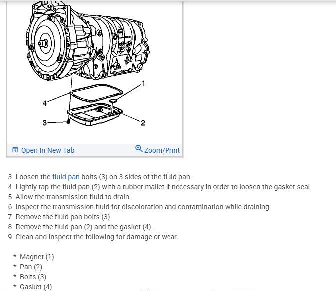

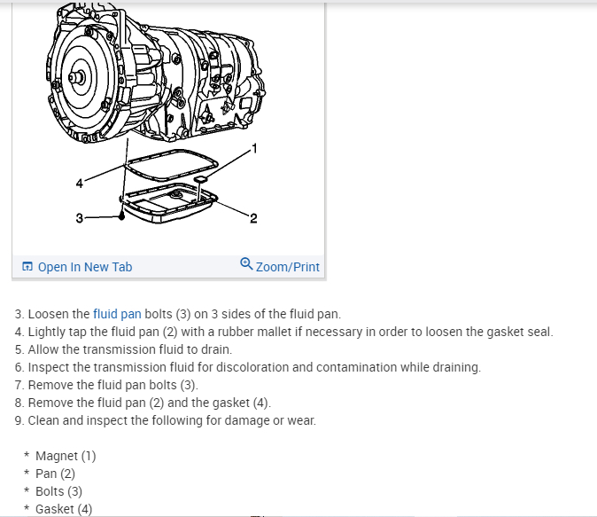

They were in the directions above. Tighten them to 8 foot/lbs or 97 inch/lbs which is the same torque.
Let me know how things work out.
See pic below.
