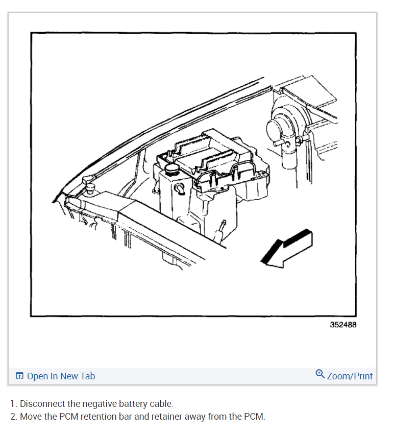

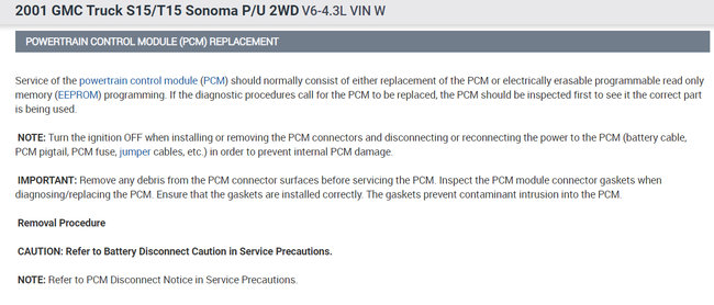

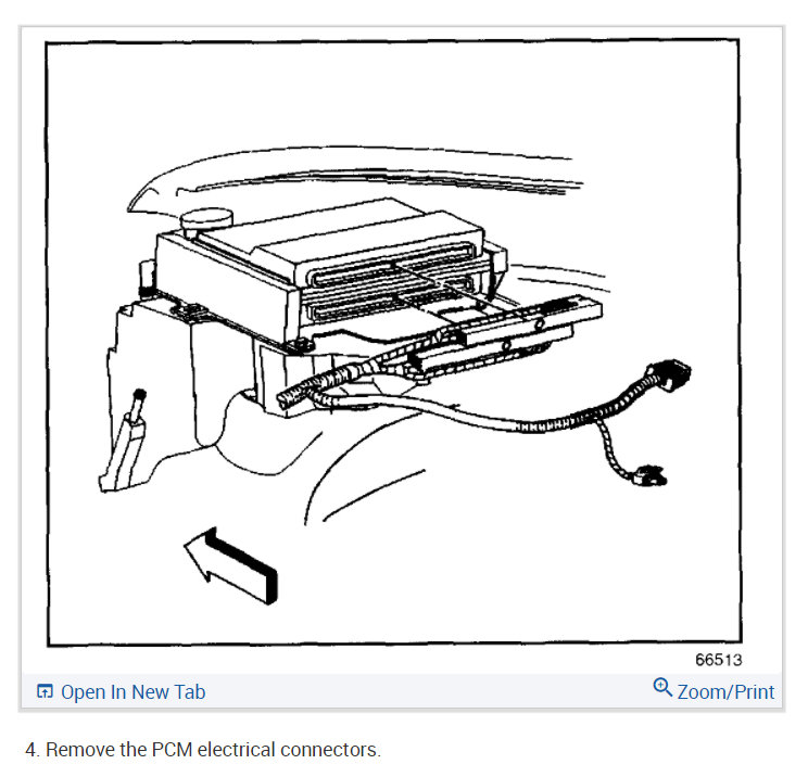

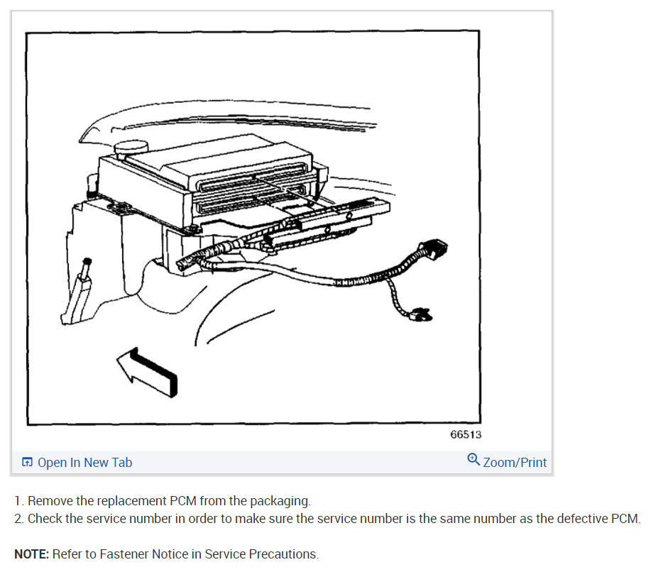

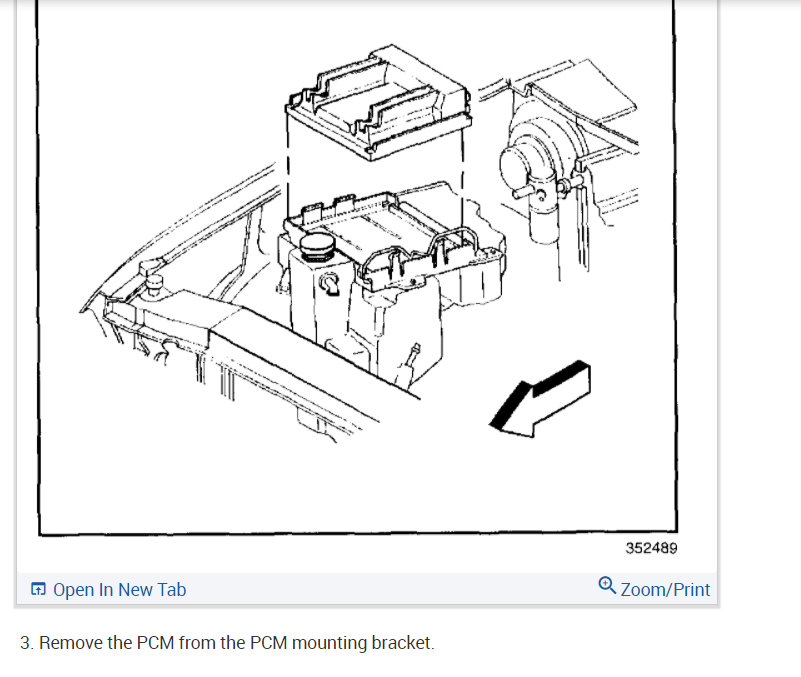

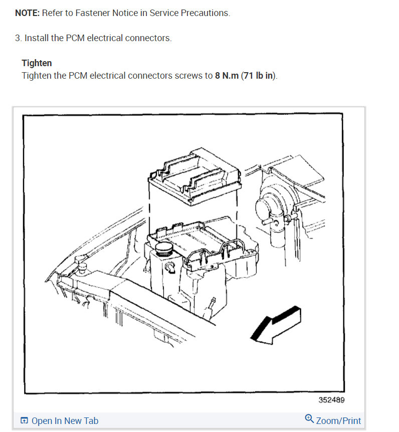

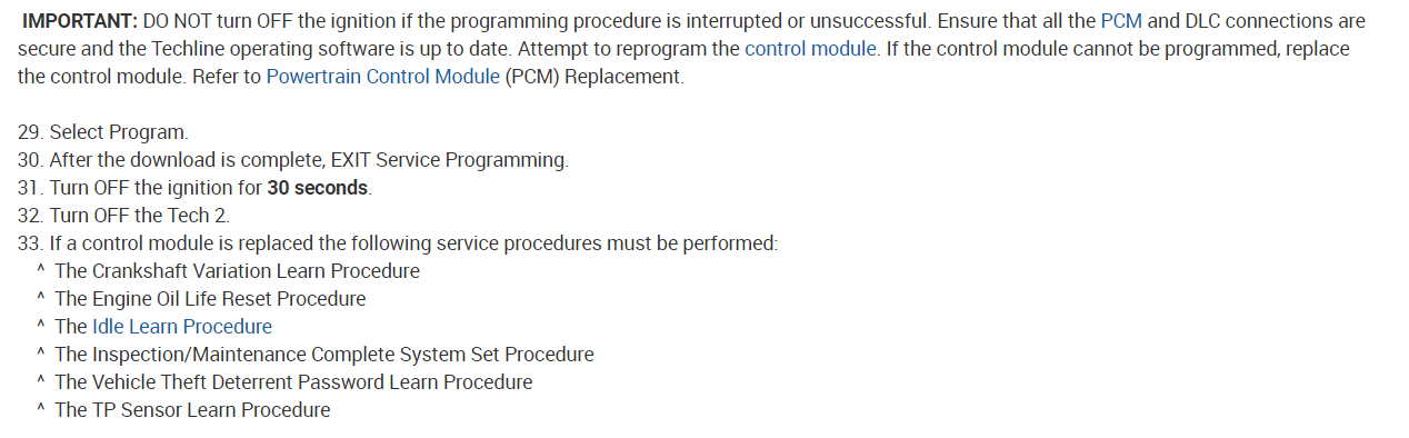

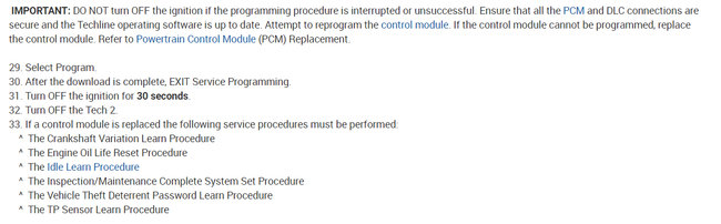

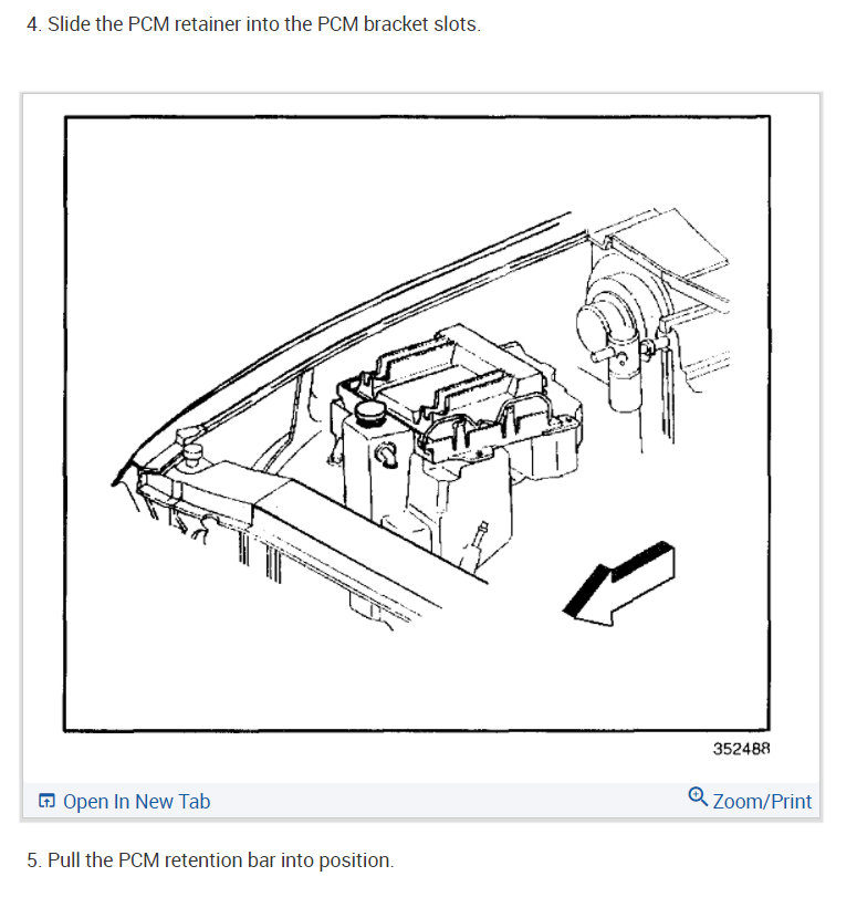

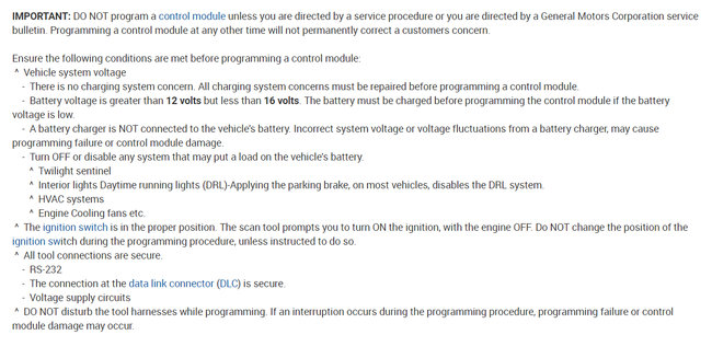

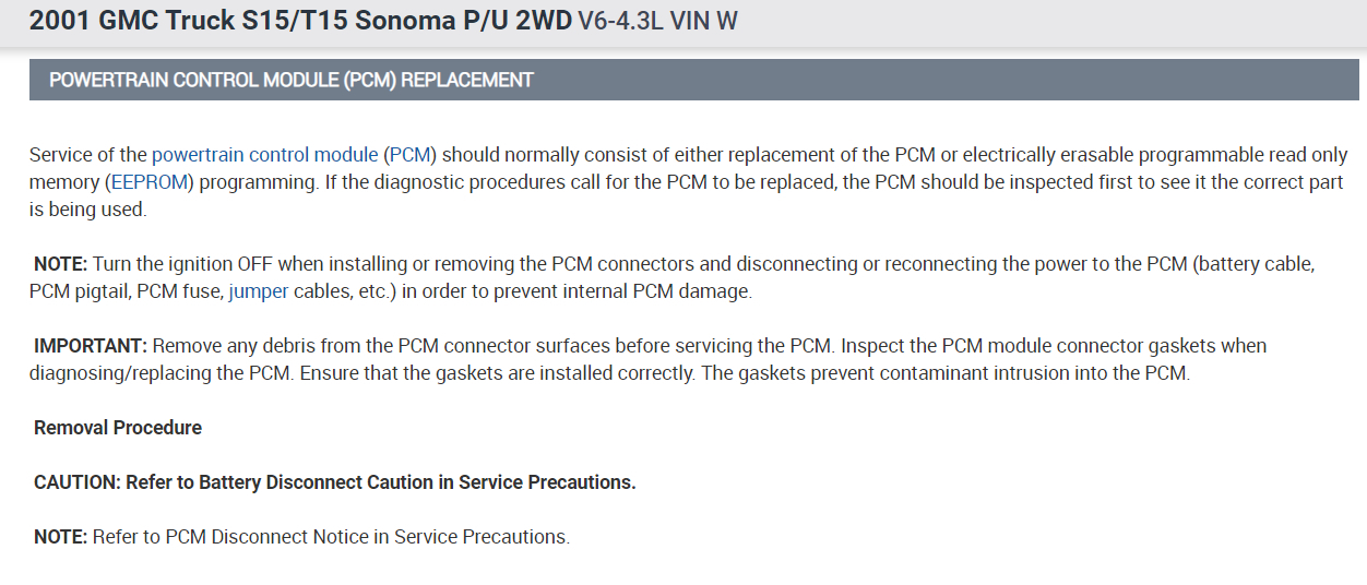

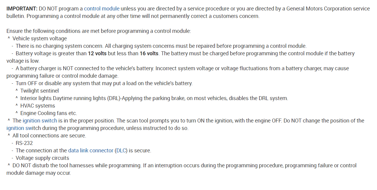

Thanks for the video. Yep, it is not shifting. Can I ask did it do this before you did the repair? If so I would try a replacement PCM because if it were a connection problem you would would have a code that pertained to it. Here are the instructions. Check out the diagrams (below). Please let us know what happens.
