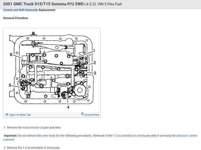

hi, i have a problem with my transmission not shifting out of first gear. i changed the speed sensor and all four solenoids. i changed out the transmission fluid too, but still not shifting. so with that all being said what could cause the problem?
Dec 28, 2020 at 2:10 AM (Merged)
Good evening
Is the check engine light on??
The throttle position sensor on the throttle body is what controls the shifting of the transmission. It monitors the voltage and based on that the PCM sends a command to the shift solenoids to open and close.
AUSTIN.JENNINGS
  • 5 POSTS
yes, check engine light is on. so what would i need to change now?
Okay, first you need to have the codes read. you can take it to a parts store and they will read it for free.
then once we know the code, we need to look at the possibilities and follow a flow chart to determine the failure. codes never identify bad parts, just failed systems.

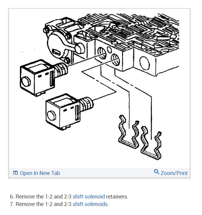

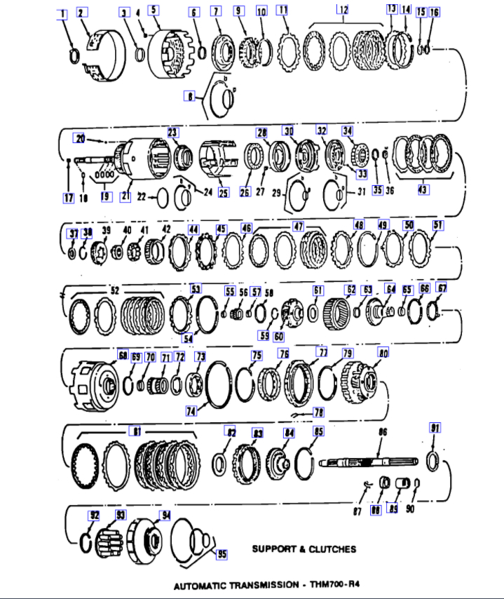

CHRISTOPHER JARMAN
  • 9 POSTS

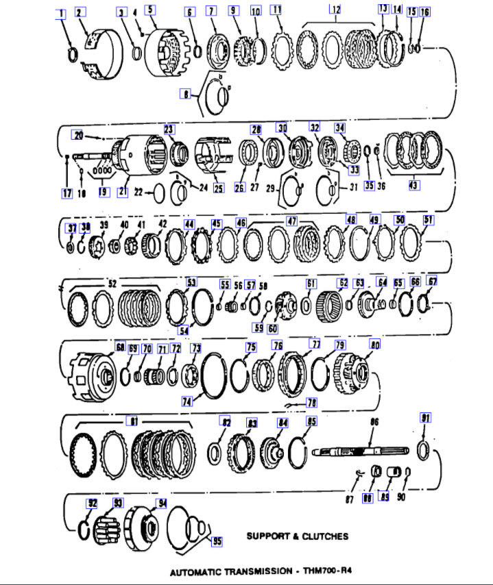

I just rebuilt my transmission put in a new third and fourth clutch pack. replaced the third fourth piston seal and all the seals checked the sunshell it was fine but replaced it anyway. put it all back together shifts into third but I have to let go of the gas to get it to shift and seems it is losing pressure and slips back out. I don't know what is going on. any help would be appreciated!

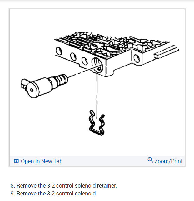

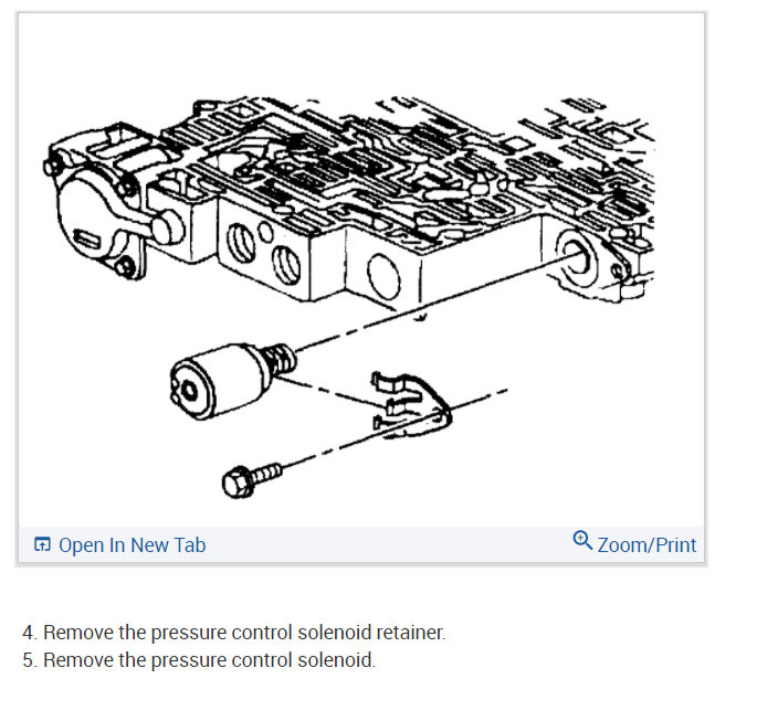

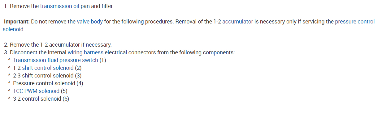

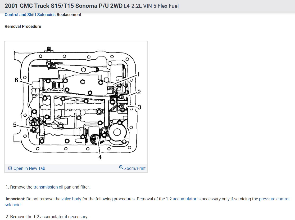

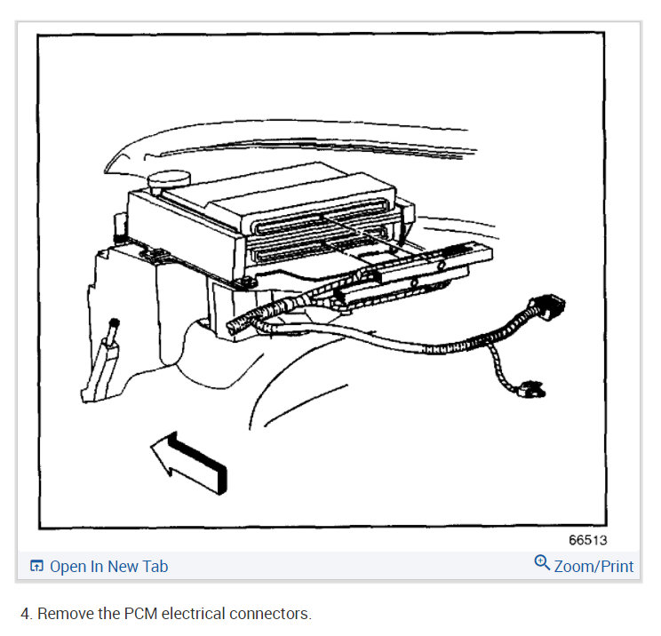

Do you have any check engine lights on? if so this guide can help us. also when you did the repair did you get the seals in correctly for the servo and drums? Check out the diagrams below to help reinstall the seals.
and
Okay, all three codes are related to wiring harness issues as they all are saying the PCM is seeing high voltage on the returns from the solenoids. The most likely issue here is a short in the harness. the harness in the pan is common. it is submerged in fluid and over the years it gets into the wiring and shorts out.
Since you replaced all the solenoids, the only thing left is the wiring harness.
You will need to drop the pan again and check the harness closely for any breaks or melted wires.

yes, they are a simple. 12 volt ground and power you should be able to feel a click when the circuit is completed. Check out the diagrams (below). Let us know what happens and please upload pictures or videos of the problem.

It was kind of but when I rebuilt the transmission the third and fourth clutches were toast and the seals were bad. I will check into the PCM. though is there a way to just reset it and see if that works? I don't have a ton of money to just throw at this truck and see what happens, lol.
CHRISTOPHER JARMAN
  • 9 POSTS
Also, when I changed my distributor it did throw out a p034 trouble code and p300. but when I adjusted the distributor it fixed that issue and the code went away. So if it is still able to put codes out does that mean its still working? I don't know. I dislike electronic issues.
  • 55,423 POSTS
I would go back through the transmission then it sounds like you might have folded a lip seal or forgot an o ring. Let us know what happens and please upload pictures or videos of the problem.
CHRISTOPHER JARMAN
  • 9 POSTS
I fixed the issue. turns out it was a the transmission pressure sensor/switch and wiring harness. thanks for all the help :)
