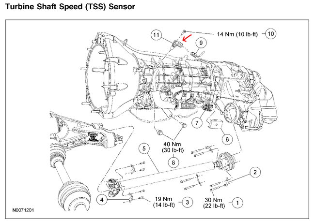

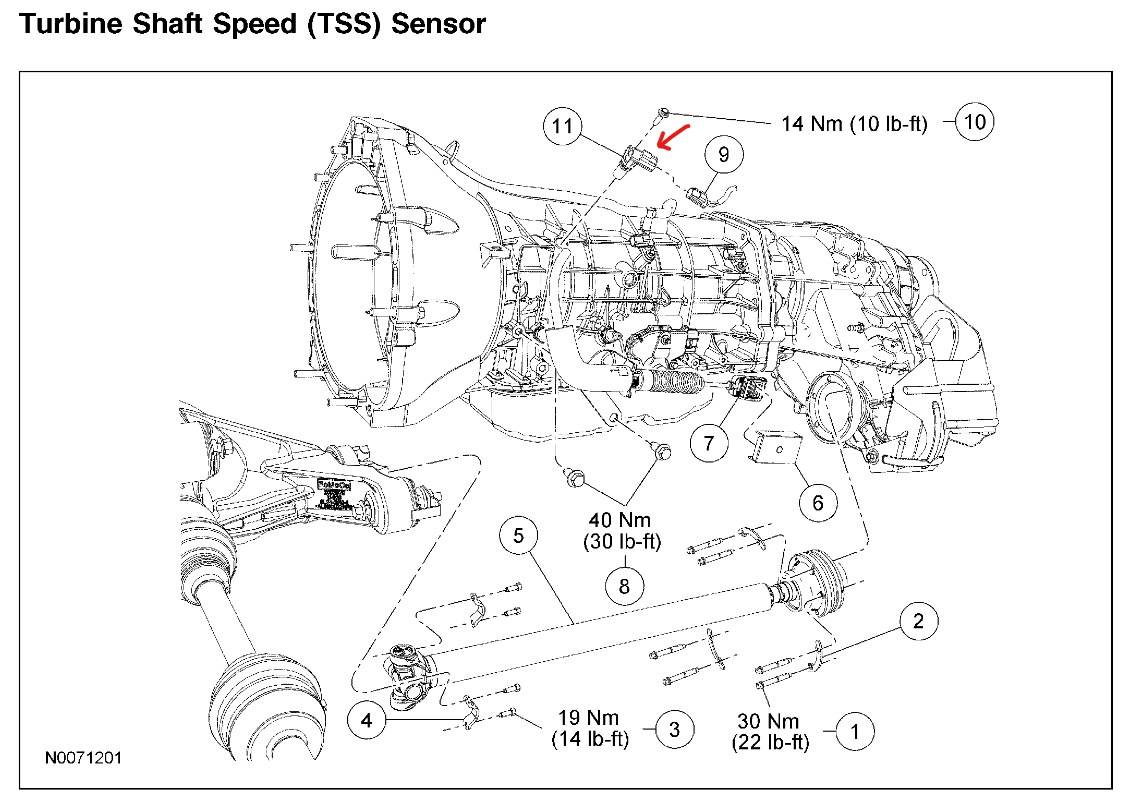

Let's run the codes because it seems like you have an input shaft speed sensor (turbine) that is not working, or the value of the sensor has degraded. Also, can I ask if the engine power is normal? If not and the engine is down on power, you could have a partially clogged catalytic converter.
Here is a guide to help us:

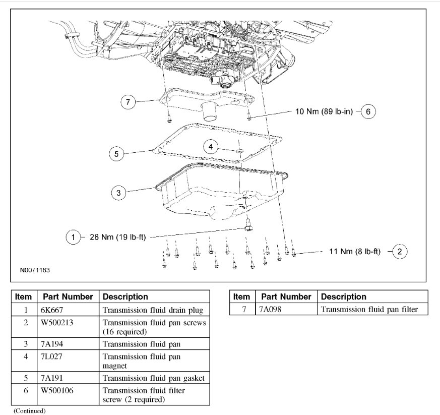

This is the location of the turbine sensor in case you need it, also has the transmission been serviced lately. I would do this as well.
Here is a guide to help:
Transmission Fluid Type
5R55S .................... Motorcraft MERCON V ATF XT-5-QM
6R60 .................... Motorcraft MERCON SP ATF XT-6QSP
Capacities
Transmission Fluid
5R55S .................... 12.4 Quarts (11.7L)
6R60 .................... 11.2 Quarts (106L)

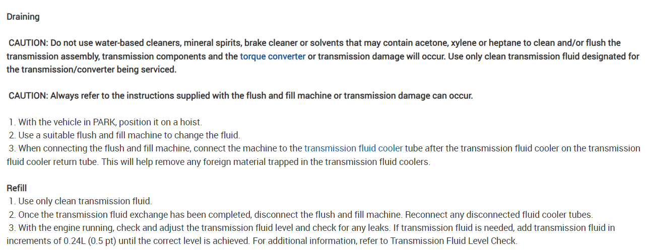

I have included the transmission service procedure for your car as well.
This guide can help as well:
https://www.2carpros.com/articles/how-to-check-and-add-transmission-fluid
