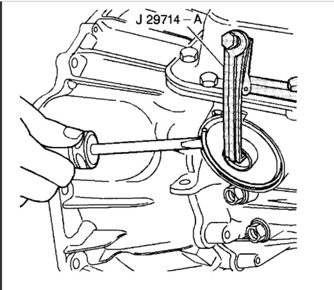

Ok had car scanned, came up with a code indicating bad torque convertor solenoid. So I bought that as well as 1 other round solenoid directly next to the torque converter that the parts store stated was also a torque converter solenoid. I also bought 1 of the shift solenoid. Dropped the pan and installed all 3 of those. Topped off with fluid, and test drive it. No difference. Except that now, when I take off it shifts so smooth from 1st to 2nd, but that's it. When it got up to speed when it should change on into 3rd, it seemed almost like you pushed it up into neutral. It felt like it was changing, but the rpm's, climbed but it was basically in neutral. As soon as I let off the gas and lightly stepped back on the gas it was still in 2nd. While the pan was off earlier I noticed there was one other what looked a shift solenoid and one other round in shape solenoid. I have no idea if they have anything to do with my issue or not but I'm desperate. Now up until a couple days ago it would shift into 3rd, after the engine warmed up and fine the rest of the day, but now it acts like it only has first and second and goes into neutral after that. I have never felt the transmission slip at anytime during all of this. The pan was the cleanest, lack of any metal shavings, I've ever seen. I'm betting for help and a direction. Please.

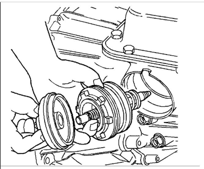

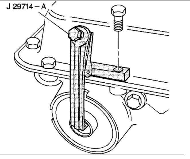

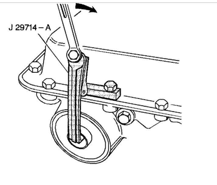

Nice work getting the shift solenoids replaced. After you replace them did you clear the codes? If so it sounds like the servo seal that is bad which will require some disassembly. Here is some guides to show you how to check the seals.
