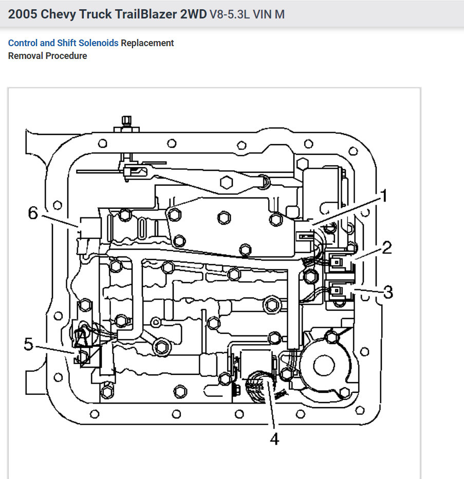

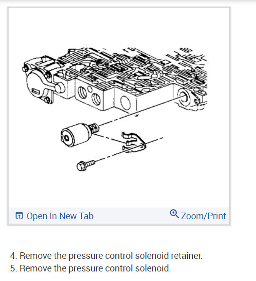

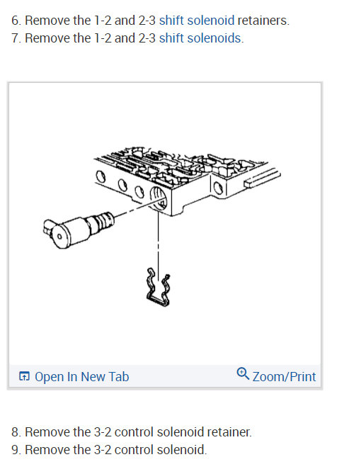

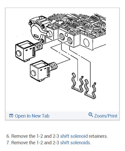

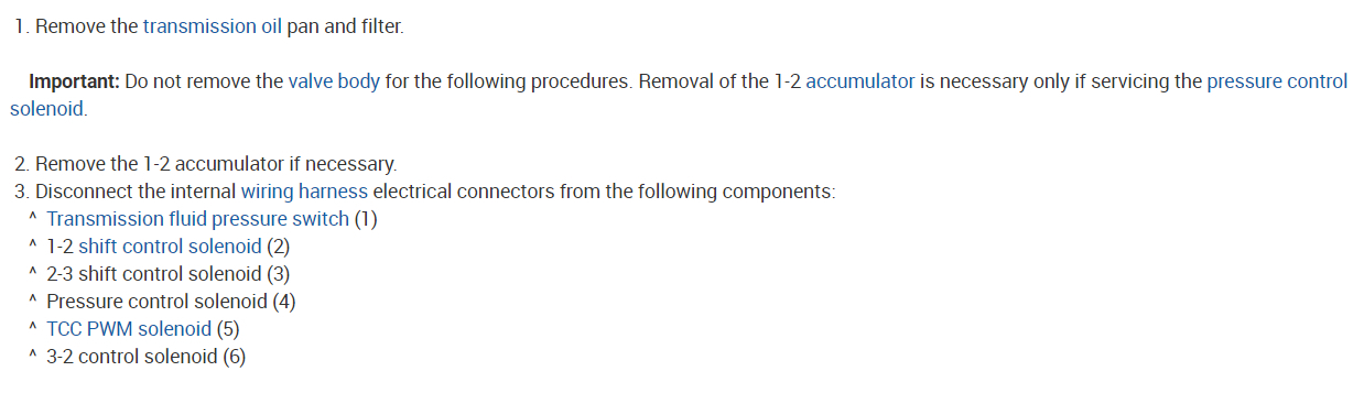

I would check the sendony to third gear shift solenoid is it common for them to go out this guide will help us with diagrams below to show you how to fix it on your car.

I have a 2005 Chevrolet Trailblazer with the 6 cylinder engine and 4L60E tranny. On way home from a trip the transmission would not shift into 4th gear (overdrive). 1-3 gears shift fine. No engine codes being displayed. Changed fluid and found no metal. Took to a local transmission shop and they are stumped. Shop advised that when they hooked up to the computer they advised they can see where the computer is sending the command to shift into 4th gear, but it's not happening. He advised if it was a clutch pack problem it would "neutral" out when given the command to shift into 4th, but the truck just stays in 3rd. Tranny shop is leaning towards computer or electrical, but still unknown. Any ideas?

The computer might not be giving a command because a shaft speed sensor could be going out but not enough to trigger a code. You can try checking live data on a test drive or replace both the input and output shaft speed sensors

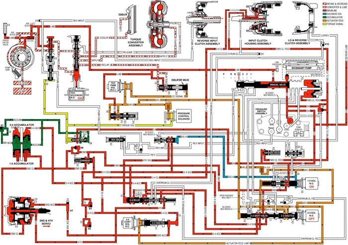

It's my understanding that on this model the shift solenoids are both activated in 2nd gear. If so doesn't this mean they are both good?

If they see that the computer is sending the signal to shift into 4th gear have they checked at the trans is the trans solenoid receiving that signal if so the would eliminate the wiring to the trans and at the trans what controls 4th.I would go more towards electrical but poss. internal trans problem. I will look up the control circuit and see what controls 4th.and will get back to you.

Ok had car scanned, came up with a code indicating bad torque convertor solenoid. So I bought that as well as 1 other round solenoid directly next to the torque converter that the parts store stated was also a torque converter solenoid. I also bought 1 of the shift solenoid. Dropped the pan and installed all 3 of those. Topped off with fluid, and test drive it. No difference. Except that now, when I take off it shifts so smooth from 1st to 2nd, but that's it. When it got up to speed when it should change on into 3rd, it seemed almost like you pushed it up into neutral. It felt like it was changing, but the rpm's, climbed but it was basically in neutral. As soon as I let off the gas and lightly stepped back on the gas it was still in 2nd,. While the pan was off earlier I noticed there was one other what looked a shift solenoid and one other round in shape solenoid. I have no idea if they have anything to do with my issue or not but I'm desperate. Now up until a couple days ago it would shift into 3rd, after the engine warmed up and fine the rest of the day, but now it acts like it only has first and second and goes into neutral after that. I have never felt the transmission slip at anytime during all of this. The pan was the cleanest, lack of any metal shavings, I've ever seen. I'm betting for help and a direction. Please.
Sep 11, 2020 at 9:01 AM (Merged)
  • 55,748 POSTS

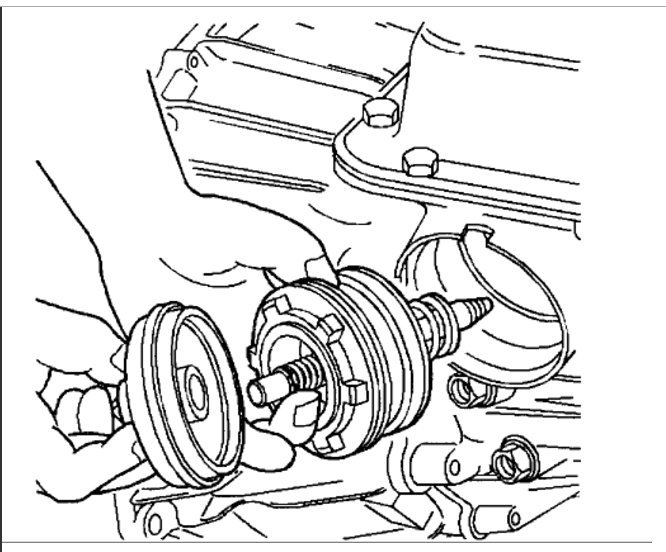

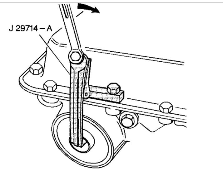

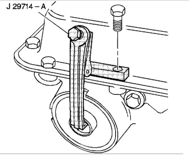

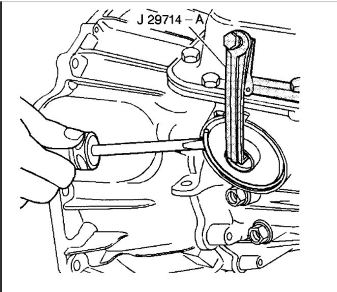

Nice work getting the shift solenoids replaced. After you replace them did you clear the codes? If so it sounds like the servo seal that is bad which will require some disassembly. Here is some guides to show you how to check the seals.
TRACY WHITE MARTIN
  • 11 POSTS
Ok thank you. Will this require removal of the transmission or can this be done simply by dropping the pan? I'm just praying the entire transmission isn't gone and requiring a complete rebuild. What do you think sir?
  • 55,748 POSTS
You should be able to do this repair without removing the transmission. If the seals are okay then the transmission will need to be rebuilt.
