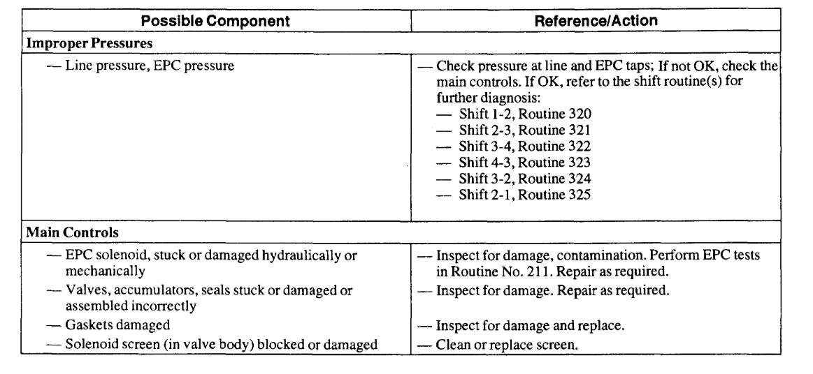

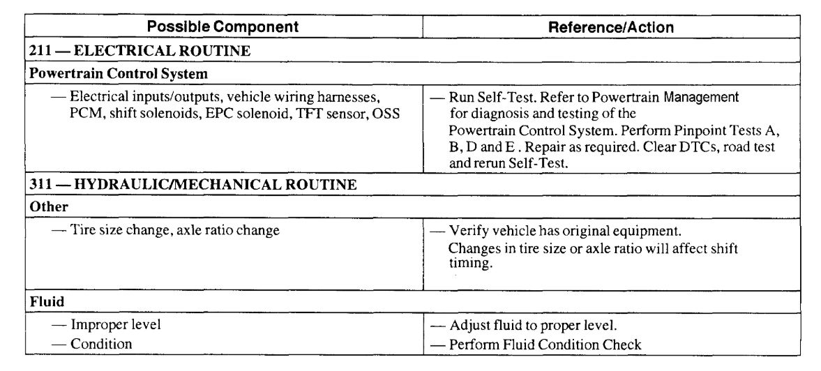

I posted last November about kind of hard shift from 1 to 2. It was an easy fix (accumulator spring). Now I have noticed a late shift a few times. I'm going 55 down the road and suddenly I feel the truck shift. Not down shift but seems to be going into gear at 55? How do these trucks shift? 4R70W
Wednesday, March 24th, 2021 AT 1:43 PM (Merged)
  • 52,797 POSTS
Good morning,
The shifts are electronically controlled. The main sensor is the throttle position sensor. It sends a signal to the ECM of the throttle position and the shift solenoids are turn on and off based on road speed as well.
I attached a flow chart for shifting issues for you to view.
Are there any codes in the system?
How long since you changed the fluid and filter?
