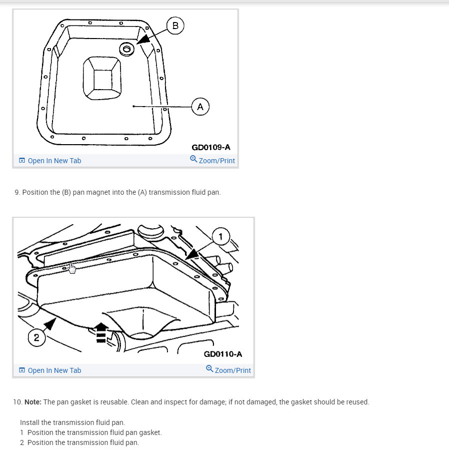

Okay, this sounds like either the valve body has sticking valves or there is a failure in the clutches inside the transmission itself.
I would start by changing the fluid and filter and pay attention to the pan and see if there is any debris in the pan or on the magnet itself. If there is, there is a good chance there is an internal failure.
If there is not, good chance it is the valve body.
Please let me know if there are any codes set in the system.

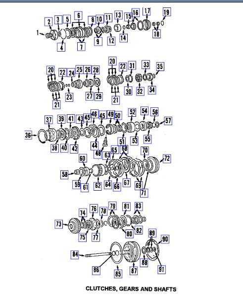

Okay, then it sounds like the seals in the transmission. It could be the forward clutch piston seals. They may be hard and need time to soften up.
The transmission would have to be removed to gain access to these seals. It most likely will result in a rebuild or replacement of the transmission.

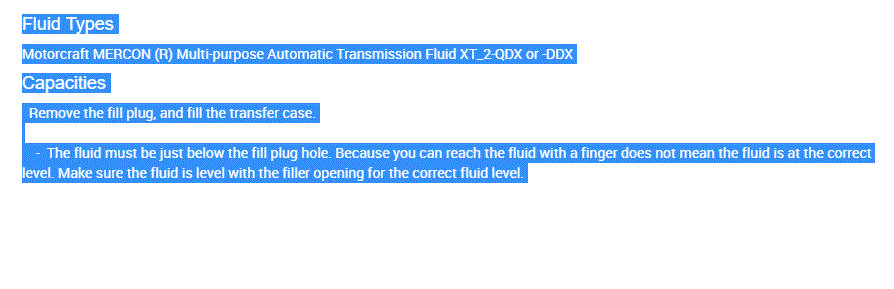

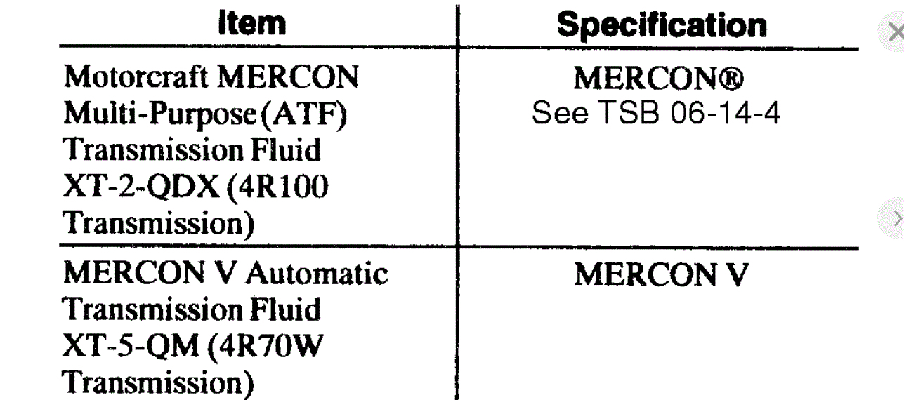

Does transmission and transfer case use same fluid or are they different?
Thanks again.
Mar 24, 2021 at 6:42 AM (Merged)
Okay, I attached the fluid requirements for you below for both the transmission and the transfer case.
Let me know if you have any other questions.

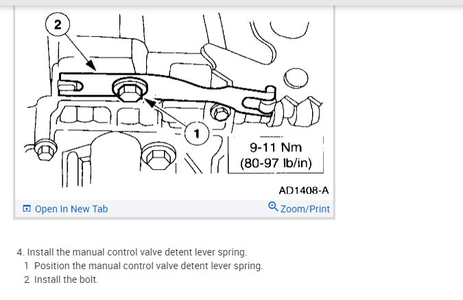

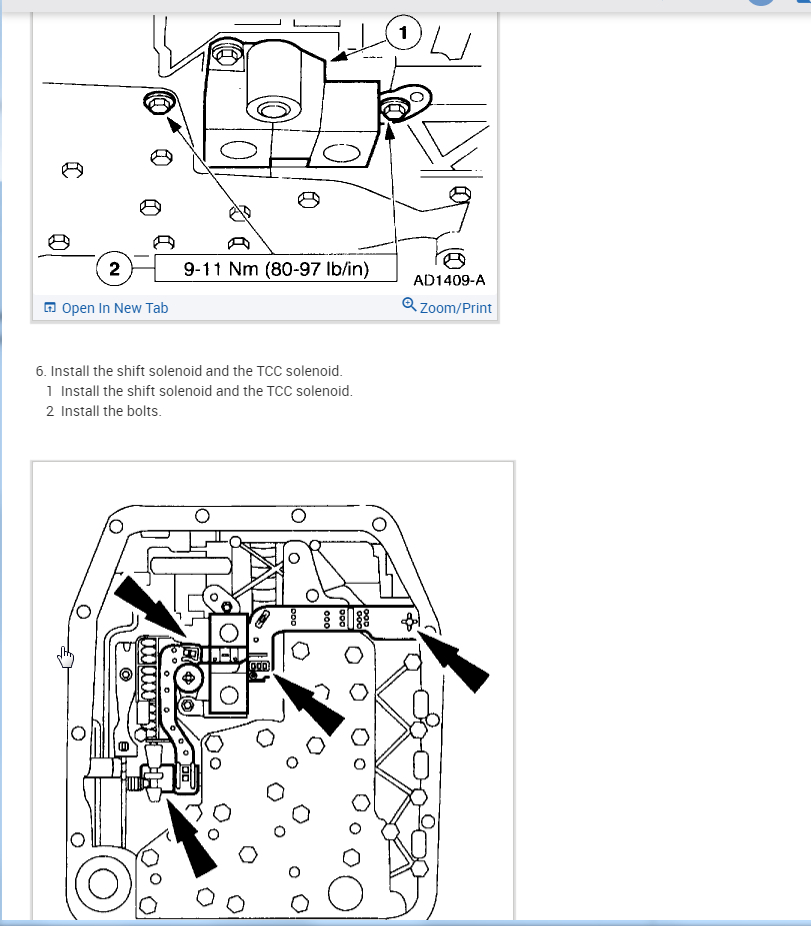

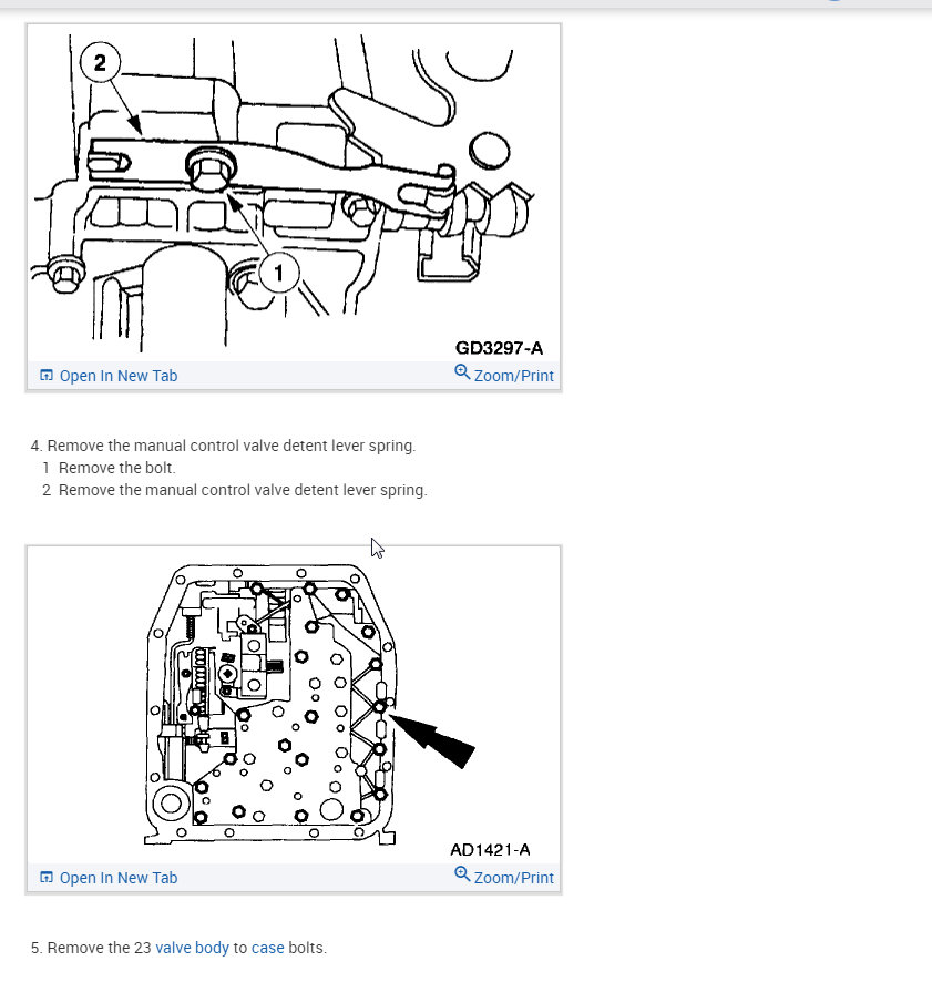

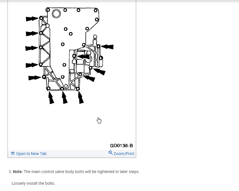

RAYDIOED

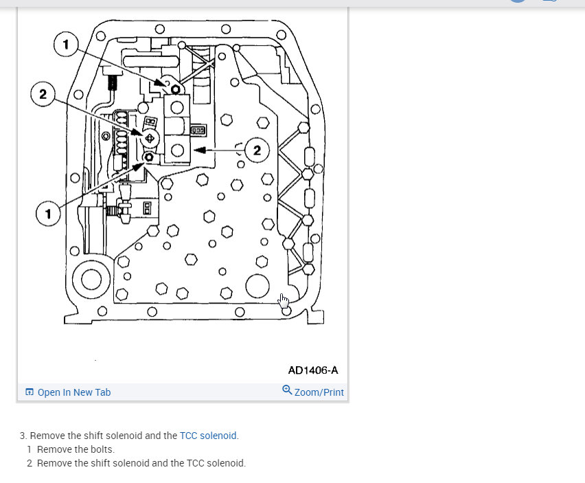

Shifts from 1st to 2nd gears fine. When going into 3rd its like neutral end of any pulling period. Have 1st 2nd and reverse only. No 3rd and overdrive. Don't know about 4x4 portion of it have not tested it.
5.4 engine runs fine. When trouble appeared. On the way home driving 40 mph passed a car and hit passing gear not meaning to, but immediately afterwards it stopped pulling and I parked it and sat there until I got it towed 12 miles at 45 mph all wheels on ground in neutral. Blew front seal at some point leaked lots of fluid not sure when seal blew but was not leaking before this incident. I did slide trans back far enough to replace seal only bushing seemed okay somebody replaced it before I bought truck. Topped fluid off.
Thank you,
Bob

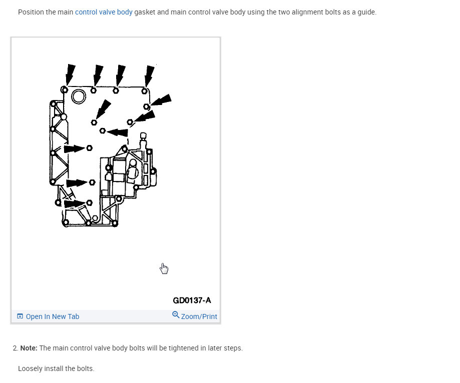

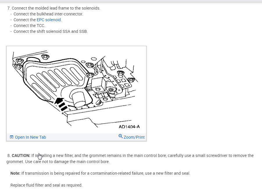

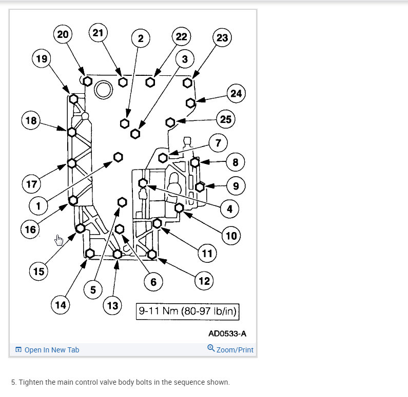

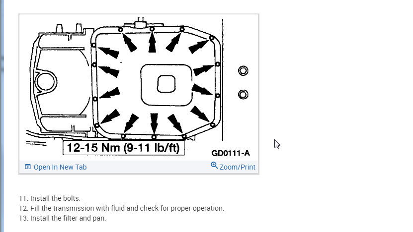

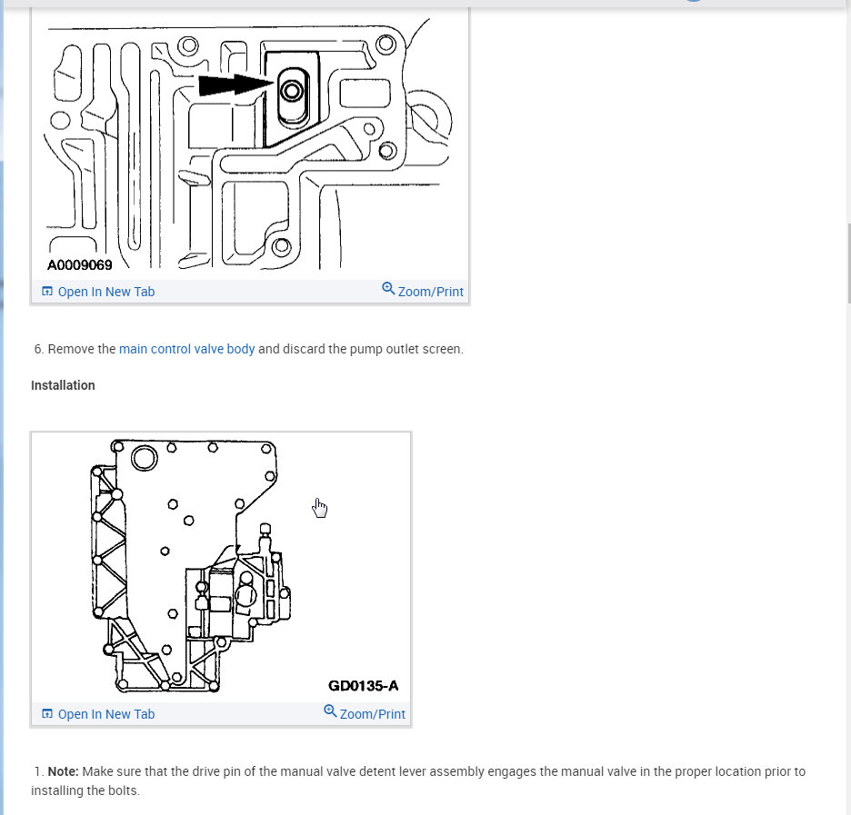

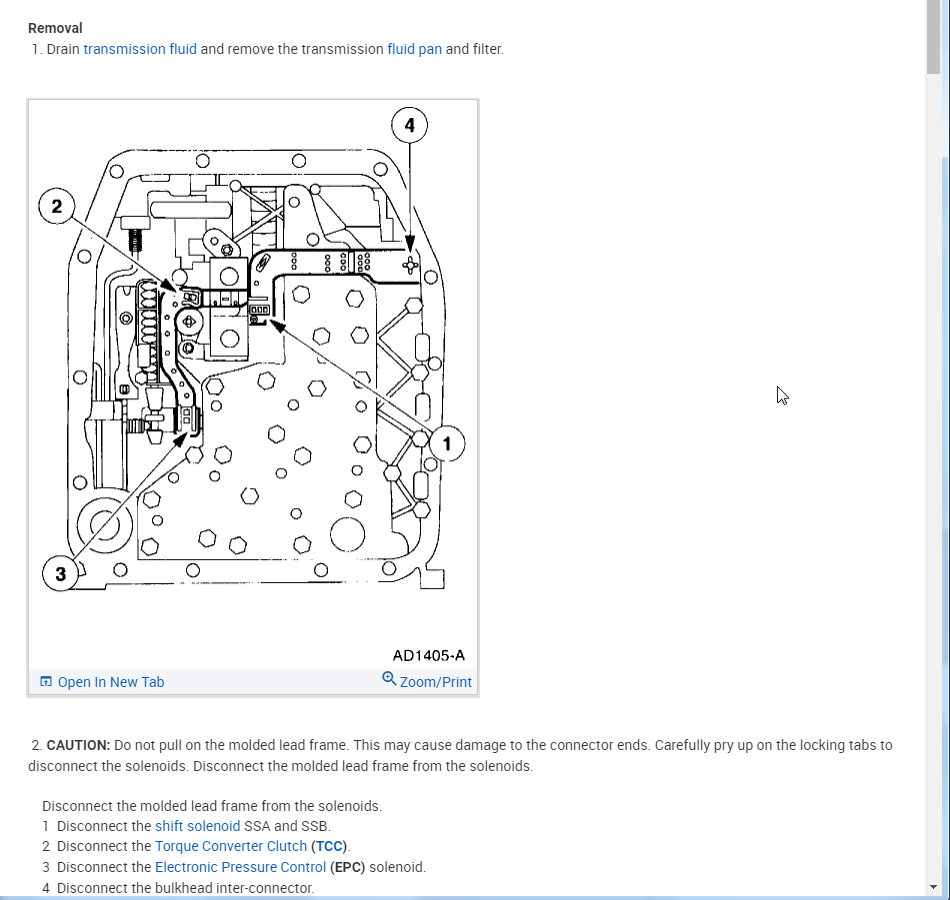

This sounds like an issue in the valve-body. The shift solenoid are inside the valve body that control each shift and a separate solenoid for overdrive.
I attached the process on how to replace this. I would suggest taking the valve body apart and inspecting it but the solenoids are only around $20.00 so I would just replace that and then put the valve body back together.
The solenoids control where the fluid pressure goes to determine what shift will happen. If the solenoid has failed it will not shift. However, your vehicle has one solenoid with two coils inside. So you would need to test each separately but with this being such a common unit, the components are pretty cheap so I would just go ahead and replace it.
Please reach out with questions. Thanks

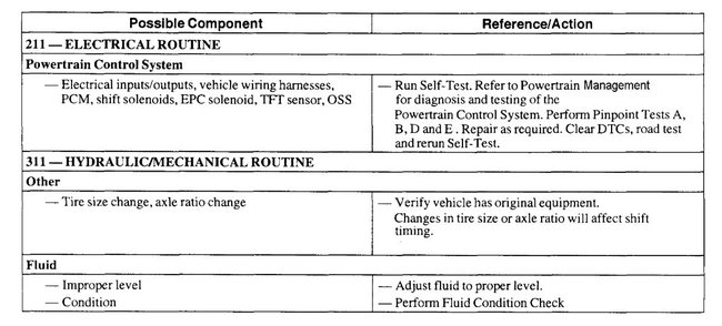

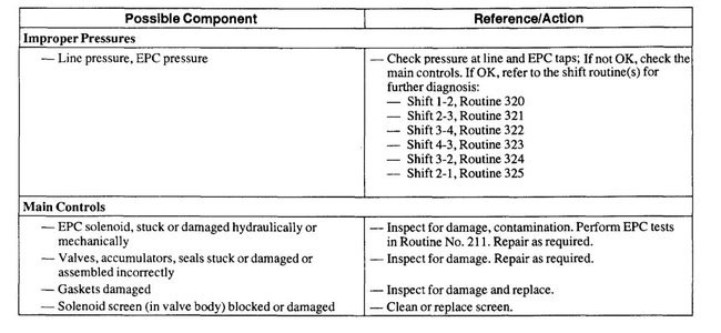

i posted last November about kind of hard shift from 1 to 2. it was an easy fix (accumulator spring). now i have noticed a late shift a few times. i'm going 55 down the road and suddenly i feel the truck shift. not down shift but seems to be going into gear at 55? how do these trucks shift? 4R70W
Mar 24, 2021 at 6:43 AM (Merged)
Good morning,
The shifts are electronically controlled. The main sensor is the throttle position sensor. It sends a signal to the ECM of the throttle position and the shift solenoids are turn on and off based on road speed as well.
I attached a flow chart for shifting issues for you to view.
Are there any codes in the system?
How long since you changed the fluid and filter?
