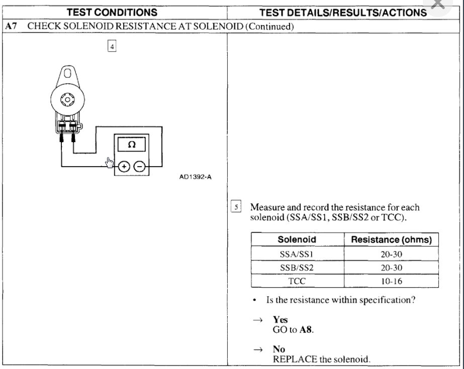

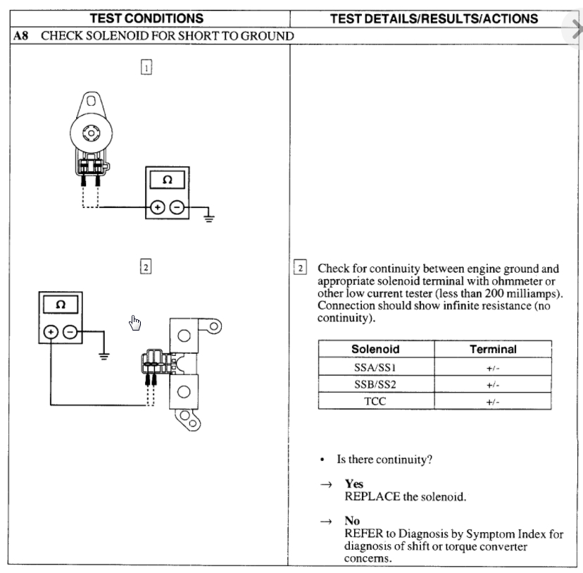

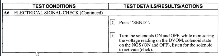

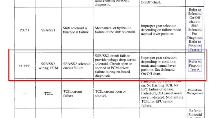

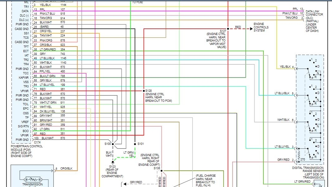

FORDNASCAR98
I have had the automatic transmission solenoids all replaced because of a P1747 code now I’m getting a P0755 code. And won’t shift into 3rd or 4th. Could it be a bad shift solenoid or wire harness? The truck was in Oklahoma and now it’s in Arizona. Could wires be bad from the road salt?
Mar 24, 2021 at 1:45 PM (Merged)
Yes. This could either so the only way to know is to run through this testing. It is unlikely that you got a faulty part but the fact that you have a new code after you replaced it, I would just go ahead and see if they would warranty the solenoid. As long as you bought it from a parts store they should take it back with no issues.
Otherwise we need to go through this testing and find out what the issue is.

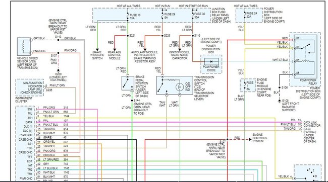

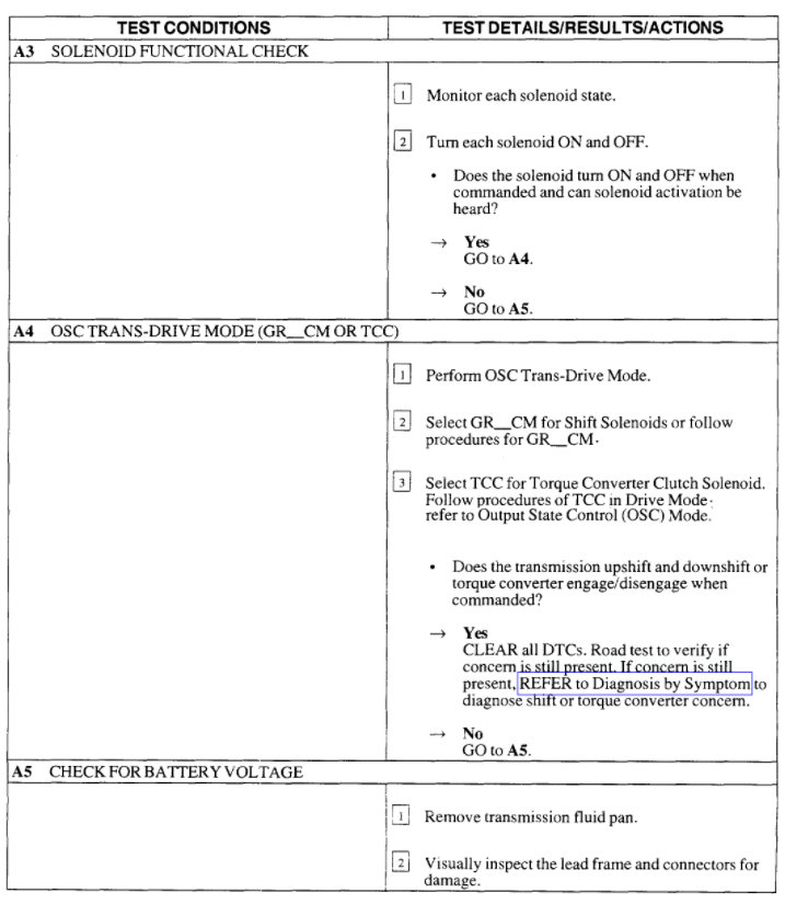

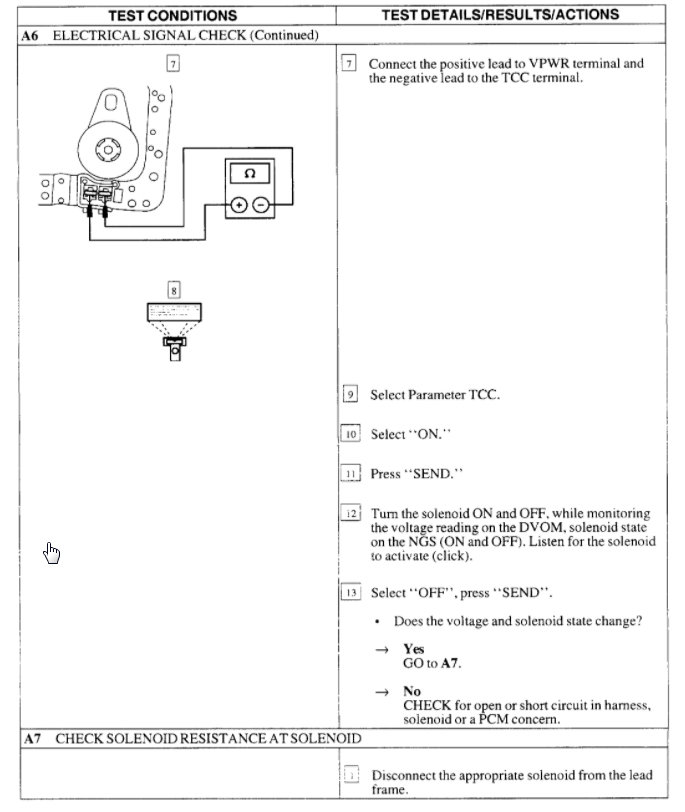

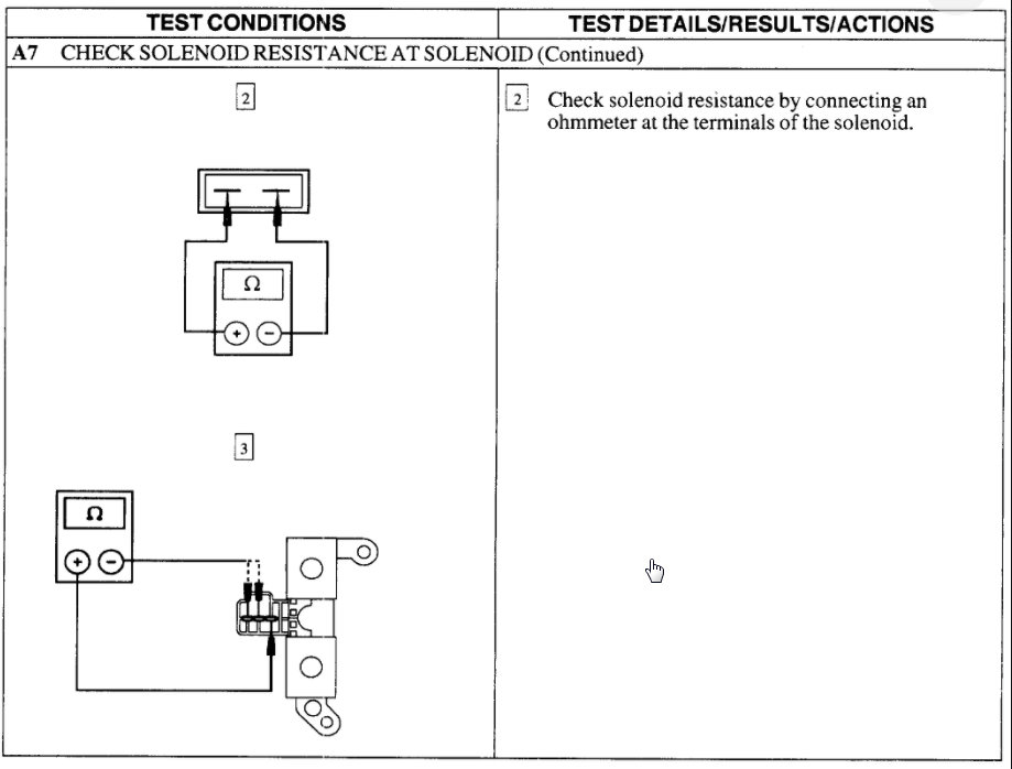

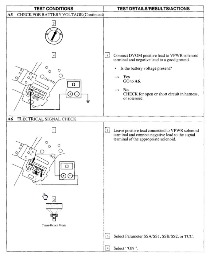

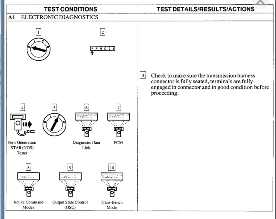

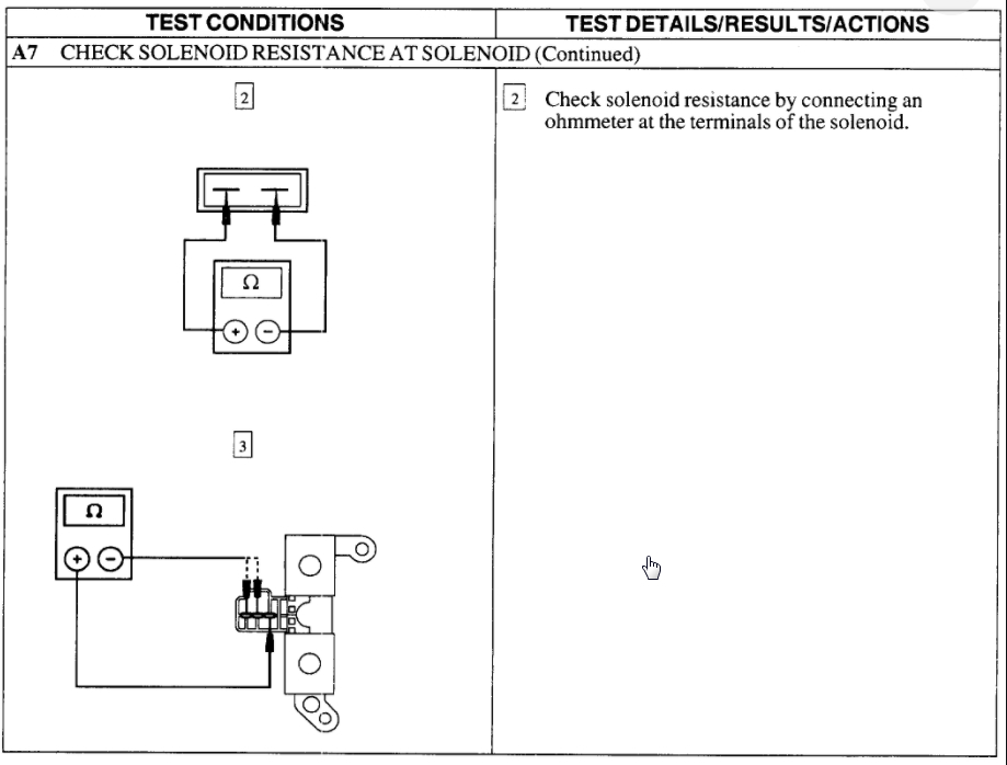

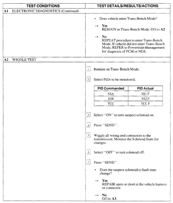

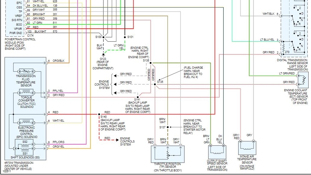

Good evening,
I attached a wiring diagram for you to view.
Verify power to the solenoid in the flow chart that was posted to be sure there is power for it to work.

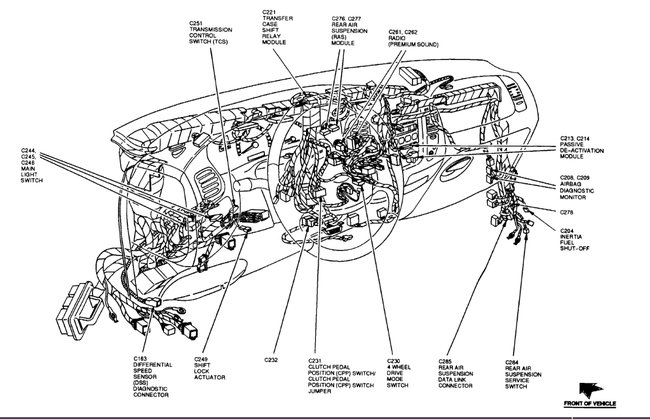

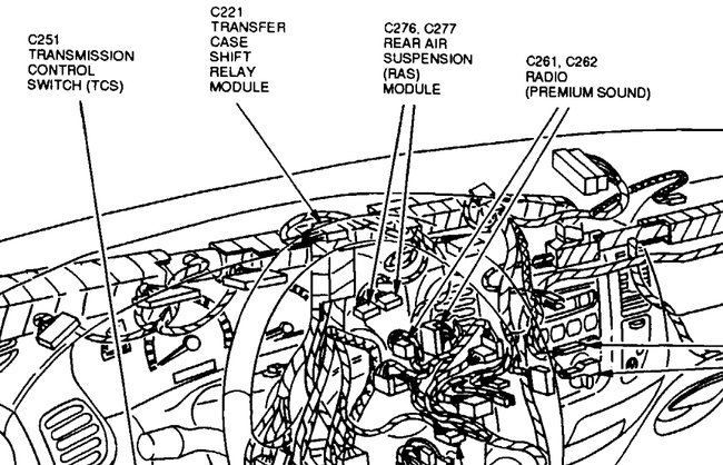

LAURASCHALLER
I just had to replace the heater core in this truck (wow what a job). But at the end of job I wound up with an extra part. The "Transmission Shift Relay". I cannot find where it hooks up. Could you please help? Thanks so much.
DANNY L
  • 5,648 POSTS
Hello, I'm Danny.
The transfer case shift relay module is located behind the center of the instrument panel. I've attached 2 pictures showing its location. The 2nd picture I blew up larger. Hope this helps and thanks for using 2CarPros.

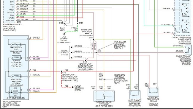

JACK WHITE

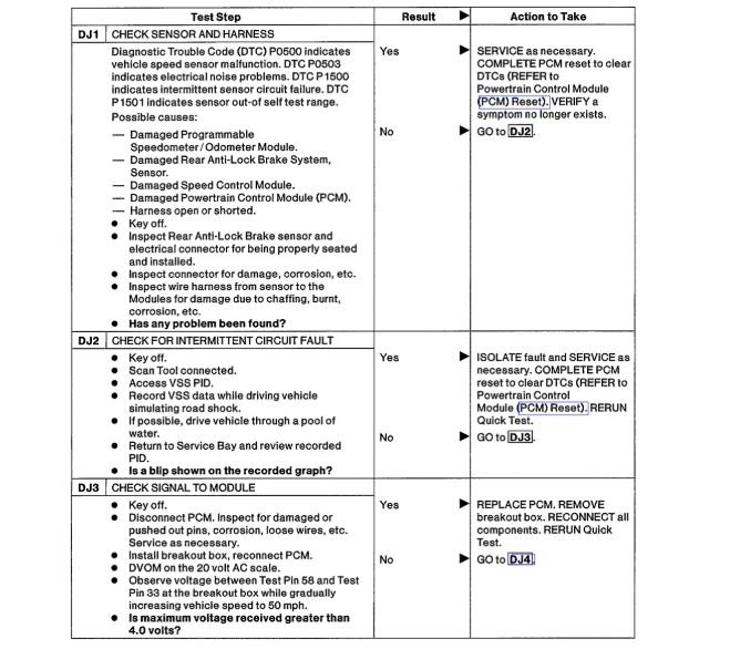

1-2 shift extreme hard (slams) 2-3 refuses (like it kicks out of gear until revved then slams. this happens after warm up. periodically will function fine when cold or for a time . read codes P0500 vehicle spped sensor fault. changed two times to be sure it was not the problem.
Mar 24, 2021 at 1:46 PM (Merged)
Good morning,
I attached the flow chart for the 500 code. It is DJ1.
As far as the shifting, it could be the valve body from dirty fluid.
Did you change the oil/filter in the transmission yet?
