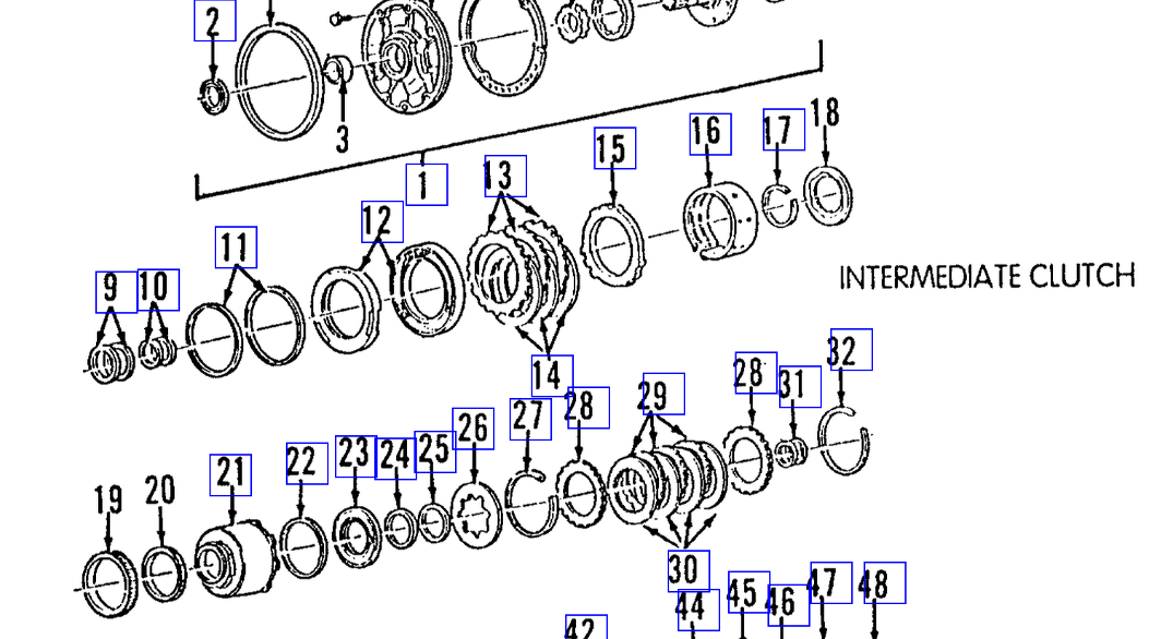

My truck has a 4R70W 4X2 transmission. I just purchased the truck about two weeks ago, after driving it for a week I started noticing that when I stepped on the throttle the RPM's would go up but the truck would not shift into gear and the O/D light would start flashing. Also the the O/D button does not currently work. After testing I received the following trouble codes; KOEO: 111 and KOER: 313 therm-actor air system/air system not bypassed during self test and code # 632 overdrive transmission cancel switch/no action during self engine run test. So I decided to replace the neutral safety switch and the first day it worked great, shifting trough gears and working normal with no high rpm's the truck would just cost after achieving the speed I need it. However, the next two days it would not start up right away after a few cranks it would start and then once started and on the road it would not shift passed second gear and the rpm’s would continue to climb with out the transmission shifting passed second gear. I would have to stop stepping on the throttle in order for rpm's to drop again and avoid doing more damage. I ordered the O/D button, that might be the problem do to the 632 code, but I am doubting that is the main issue. What test can I perform in order to get this issue corrected or find out what really needs to be done? Since I just purchased the truck I am not to familiar with it. I will be installing new spark plugs, wires, flushing coolant, replacing thermostat, changing oil and filter's also replacing serpentine belt and last but not least thinking of doing a complete transmission flush while replacing the transmission solenoids and filter. Maybe also the speed sensor. I know that is going to be a lot of work and money but I want the truck to last me a while.

Good day Roy, I wanted to give an update about my progress, it has been two days since I finished replacing the transmission filter while performing the change of the filter I decided to drain the torque converter and pan. So I replaced the entire transmission fluid about 14qts of Mercon V, now the truck is shifting beautiful and doing everything as it should, however the O/D light is now constantly flashing very annoying, but when driving the truck is shifts smoothed with out any problem at all: its very responsive. I also purchased a new O/D button and replaced it as well but nothing has changed with that annoying flashing O/D light. I will be checking the truck tomorrow with my Ford OBD1 code reader.
Would there be any sensors in the transmission or differential that I could possibly check?

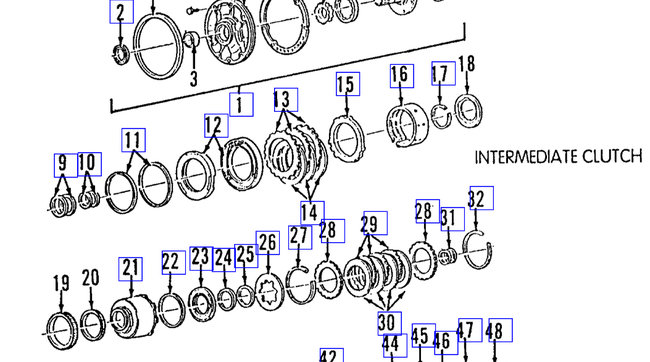

No, the OD light blinking indicates the overdrive clutches or band may be the issue especially if the clutches are slipping. Very common issue with these transmissions.
I attached a diagram for you to view. 13 through 16 is the area behind the front pump that is the overdrive clutches.

I see, will this require some sort of specialty tools to repair or can I do it on my own? It seems as if the unavoidable needs to be done. Dropping the transmission opening up and replacing them, might as well rebuild the entire transmission right?

Yes, that is correct.
You will need a lift and a transmission jack for the removal along with a lot of small tools.
Then you will need a front pump puller as well. It may be a good idea to remove the transmission and take it to someone who can replace the needed parts for you.

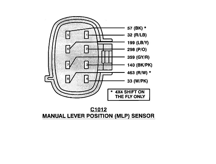

I forgot to mention that during the replacement and flush of the transmission I noticed there was a problem with the wiring harness that connects to the MLP sensor (neutral safety switch), so I bought a new harness part# WPT389 connector by MOTORCRAFT. Would it be possible to get a diagram showing how to replace and rewire it the correct way? I do not want to mix the wires. I tried looking for one on the internet but it shows different ways and I just do not want to get it wrong.

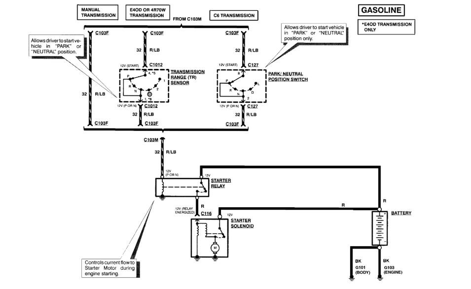

  • 52,797 POSTS
Good evening,
I attached a wire diagram for you to view. It shows the color of the wires for you wiring it.

I have this picture here. I'm just unsure if its the correct way to rewire the MLP connector, does it matter if I use but connectors or should I solder it. Because the truck was doing well after the transmission flush and replacement of the fluid. However now after trying to install this new MLP connector and repair all the broken wires. The truck starts up but when in drive. I cannot hear the truck shift gears again it continues to rev high as if the over drive is engaged and it has brought me back to the previous problem that I have tried to repair.
Wednesday, March 24th, 2021 AT 1:46 PM (Merged)
  • 52,797 POSTS
Do you realize that is the connector for the four wheel drive connector on the transfer case?
You need to be looking at the neutral safety switch on the side of the transmission.
No, solder and shrink wrap the connections.

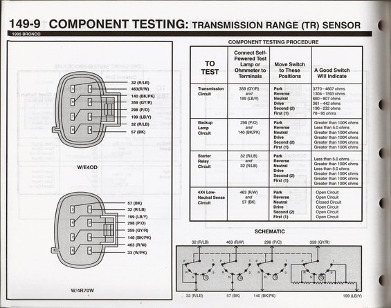

I was able to find this other picture here would this be it?

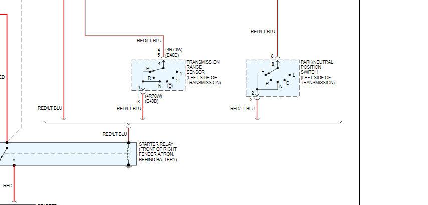

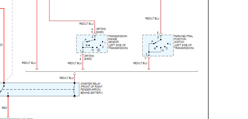

The two wires you need are these.

Do I need to test red and light blue wire in order to find out if there is an issue with it? Because the only two wires I've been messing with are the PIN#5 - 57 (BK)* and the PIN#8 - 463 (R/W)*. I tried swapping the position on both of those due to not knowing where they went but now I know those are not the problem, I'm going to leave those alone and test out PIN#1 - 32 (red and light blue ). I'll check it on the transmission range sensor. I do have them with butt connectors so the best thing for me is do it again but check the red and light blue first then solder and shrink wrap everything once again and do it the right way.
It looks like that image you uploaded shows the red and light blue wire on two different types of transmissions?

That sounds good. Do that test and see.
