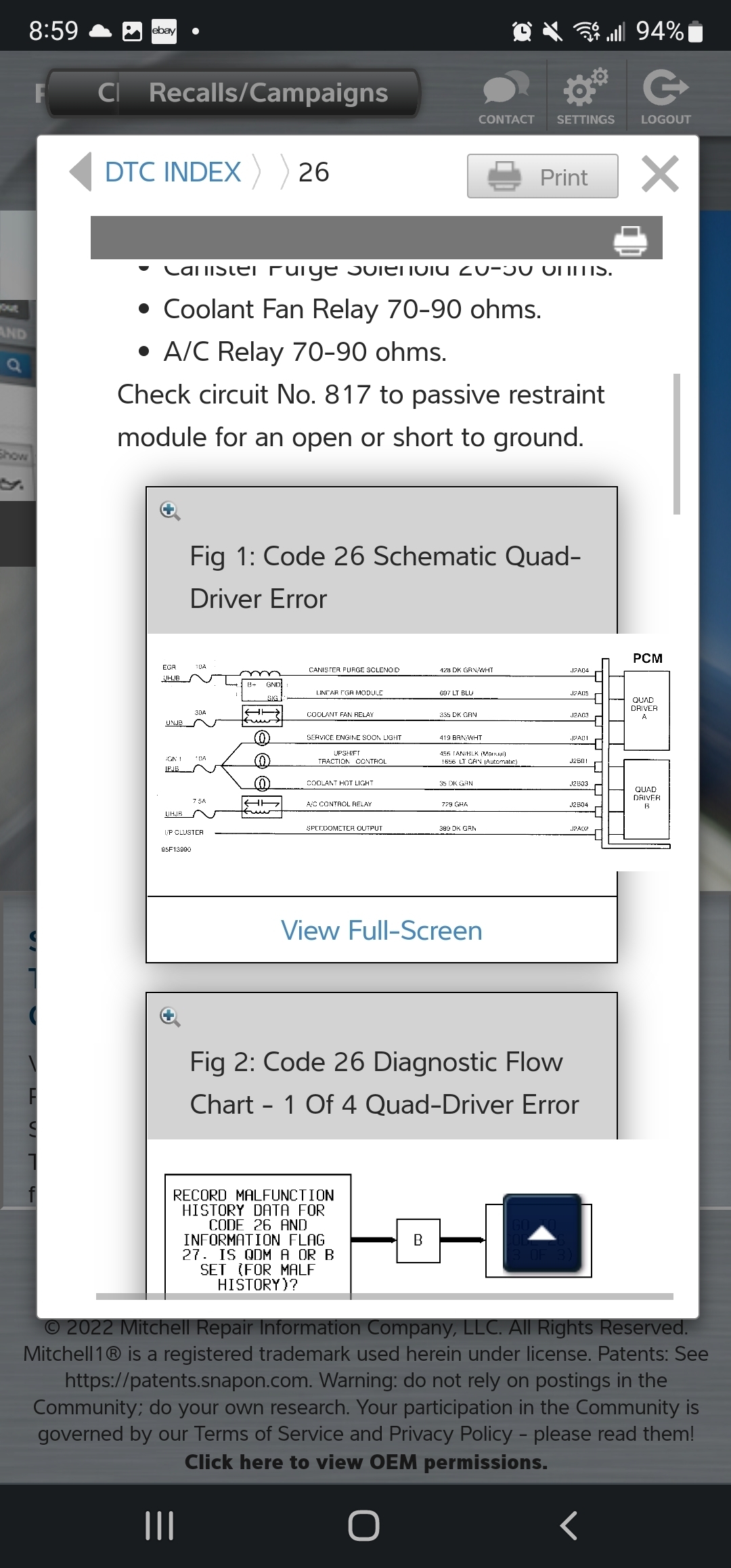

What and where is quad module?
Saturday, November 12th, 2022 AT 6:23 AM
SATURNTECH9
  • 30,869 POSTS
The quad module is part of the PCM and not part of the transmission controls. Also, I remember the early years of working for Saturn people would get a code 26 in the engine control module which is a quad driver fault. People would call into the parts department wanting to buy a quad driver module. When the real problem is just a component on the quad driver circuit.
