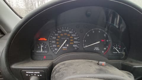

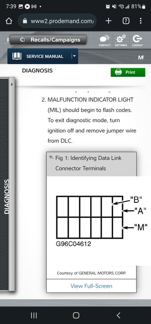

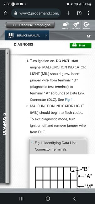

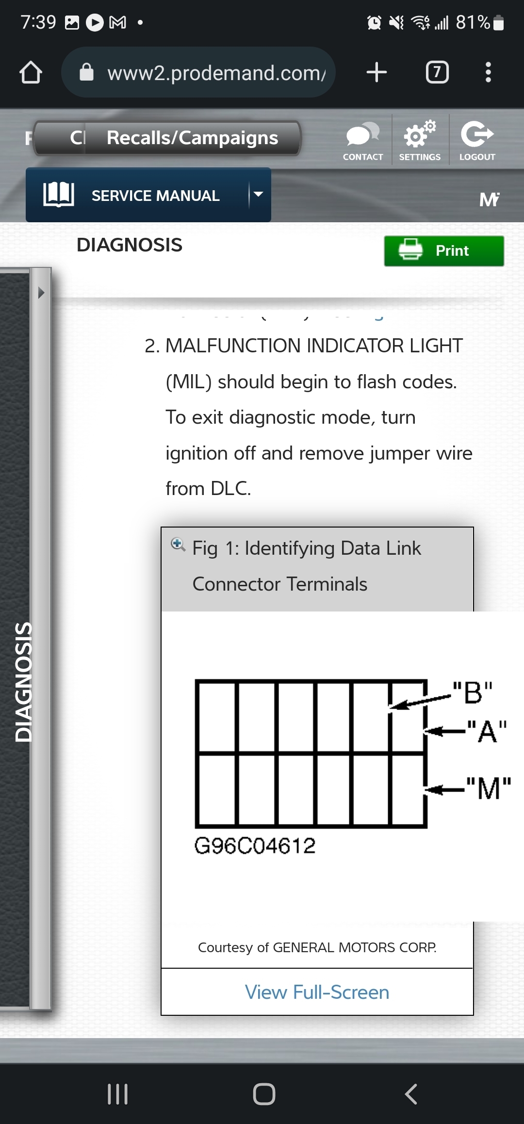

I used paper clip after check engine light flashed once and then two times the temperature light flashed two times and went back to check engine light.
Nov 3, 2022 at 12:36 PM
SATURNTECH9
  • 30,869 POSTS
That's how to check the codes but sounds like you know how to do that. So, did the temperature light flash twice then flash twice again before going back to check engine light flashing? The engine light was displaying a code 12 means you have no codes in the engine computer and the computer is working. Also have you checked the battery voltage at the battery while idling?

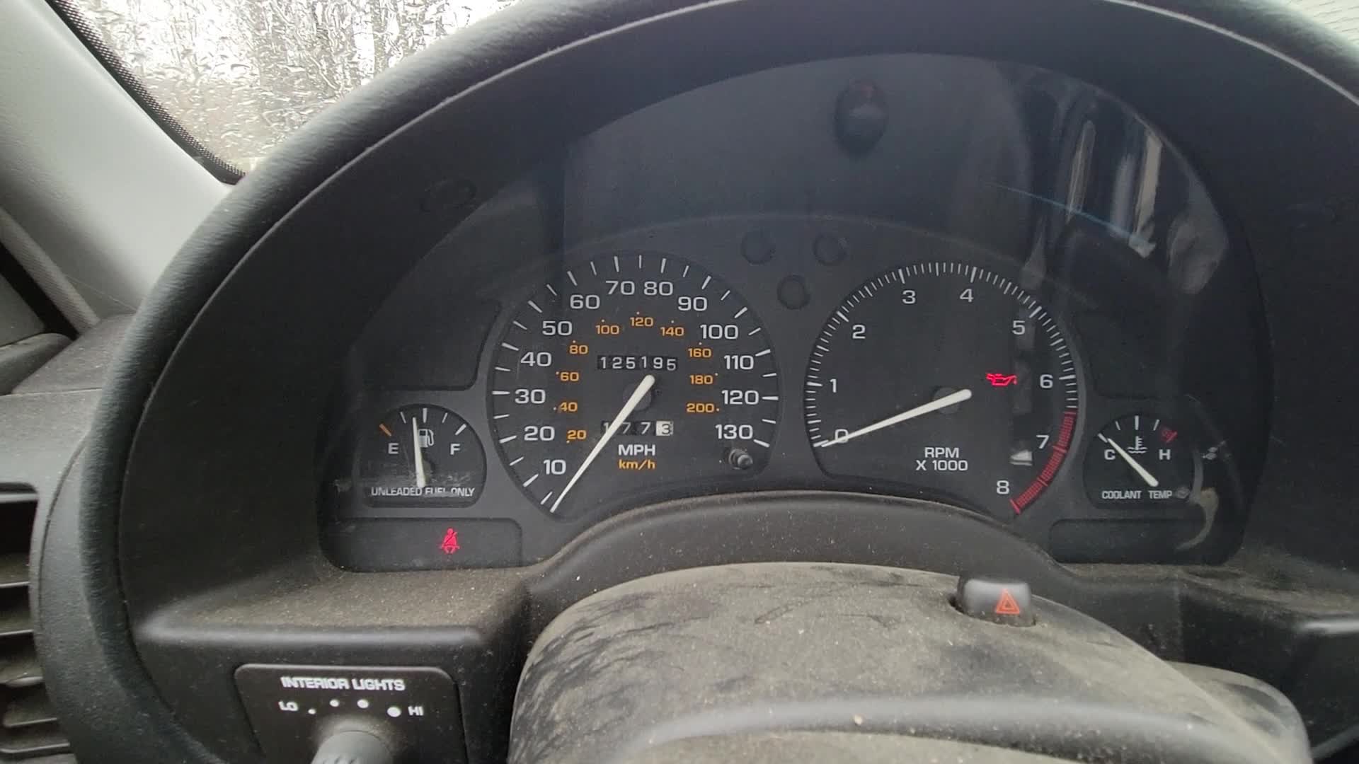

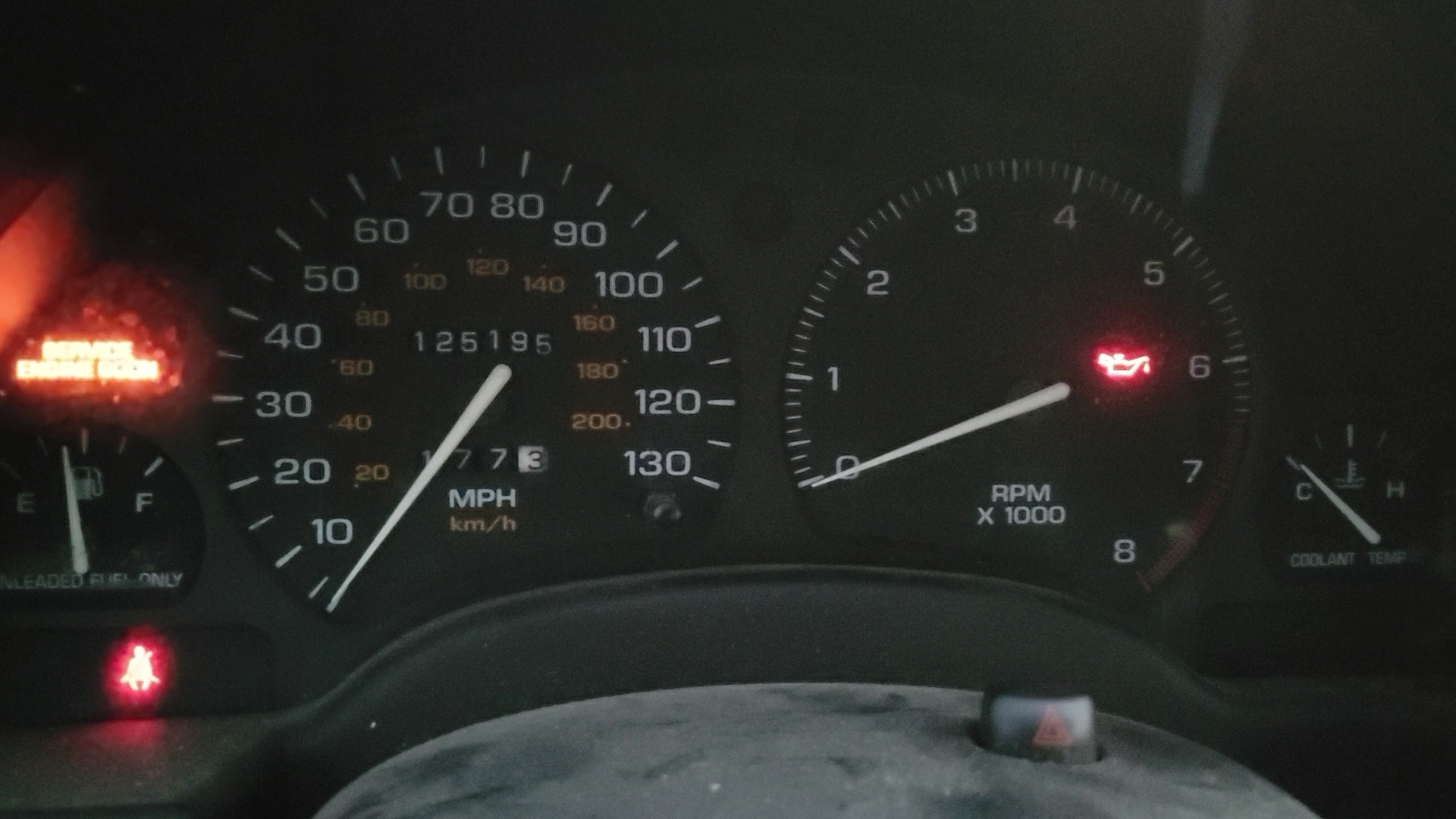

Okay, I'm getting a code 11 check transaxle, but get 2 flashes then 3 flashes from the temperature light?

Finally got it loaded, hope you all can help.
Nov 5, 2022 at 12:10 AM
SATURNTECH9
  • 30,869 POSTS
Looks like I was able to attach the video you sent me.The code 11 if you had a scan tool would say transmission codes present.The transmission code 23 is a no 3rd gear code or 3rd ratio error.That can be caused by a bad 3rd gear clutch piston low line pressure in the transmission a bad 3rd solenoid.Or a electrical problem.As far as testing the solenoid wires and pcm driver is to do a transmission actuator audible test.That requires a advanced by directional scan tool.That has that special function also forgot to mention another possible cause is a bad connector bus plate for the actuators.We could start by checking the actuator with a multimeter?Do you have one of those ?Also have to check it when it's acting up.

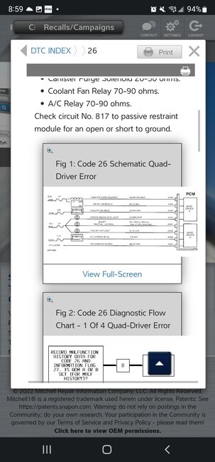

What and where is quad module?
Nov 11, 2022 at 10:23 PM
SATURNTECH9
  • 30,869 POSTS
The quad module is part of the PCM and not part of the transmission controls. Also, I remember the early years of working for Saturn people would get a code 26 in the engine control module which is a quad driver fault. People would call into the parts department wanting to buy a quad driver module. When the real problem is just a component on the quad driver circuit.
