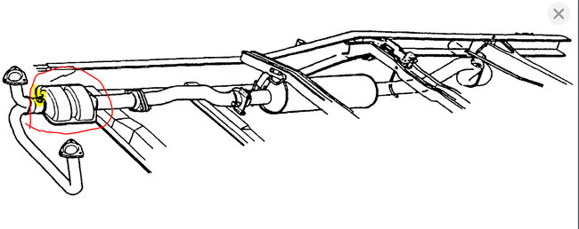

The truck listed above is the 2500 model. Replaced distributor with new Rich Porter unit,plugs,wires,fuel pump,fuel filter,MAP, TPS, IAC, fuel pressure regulator. fuel PSI is 13. this truck has a 350 with 3.42 geared posi and it wont even spin the tires. compression around 150 psi.. need help bad. About to find the tallest cliff and teach it to fly.

Honestly, the fuel pressure is perfect. Are there any noises from the engine? It's not uncommon for the cams to fail on these. It will usually cause a popping through intake, so let me know if that is the case.
Next, anytime there is an issue with power, the first thing I question is if the catalytic converter is plugged. Do me a favor. Take a look through these links. The first one discusses common symptoms related to a bad converter and the second explains how to test one.
As far as the test, if you simply remove an oxygen sensor before the converter, you should notice a difference. If there is an improvement, then the converter is my first suspect.
I attached a pic of the exhaust and circled the converter and highlighted the O2 sensor. Remove that sensor and see if it makes a change.

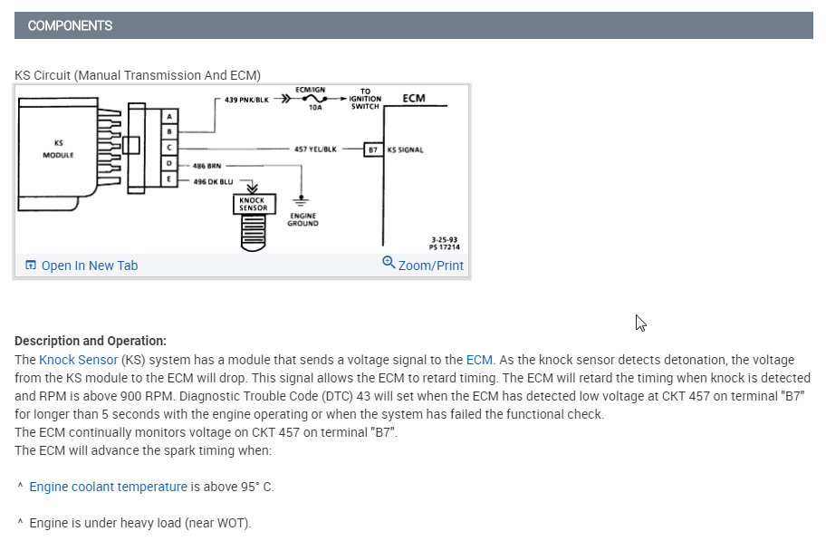

The truck is missing and backfiring, it has no power. Until I disconnect the electronic spark timing bypass. With that plug disconnected the truck runs fine. I have no idea where to go from there. The engine is timed correctly, All I can figure is a module is bad but as far as that goes I am not sure. Any help would be greatly appreciated. Thanks.
