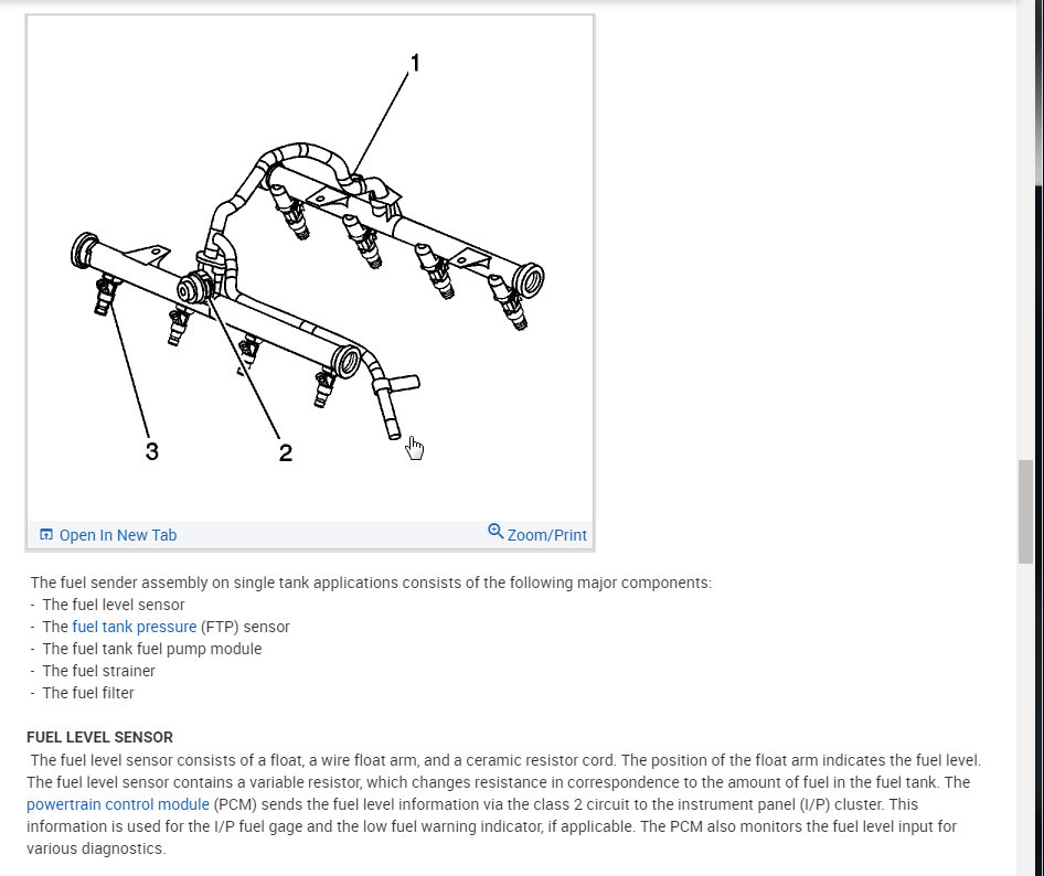

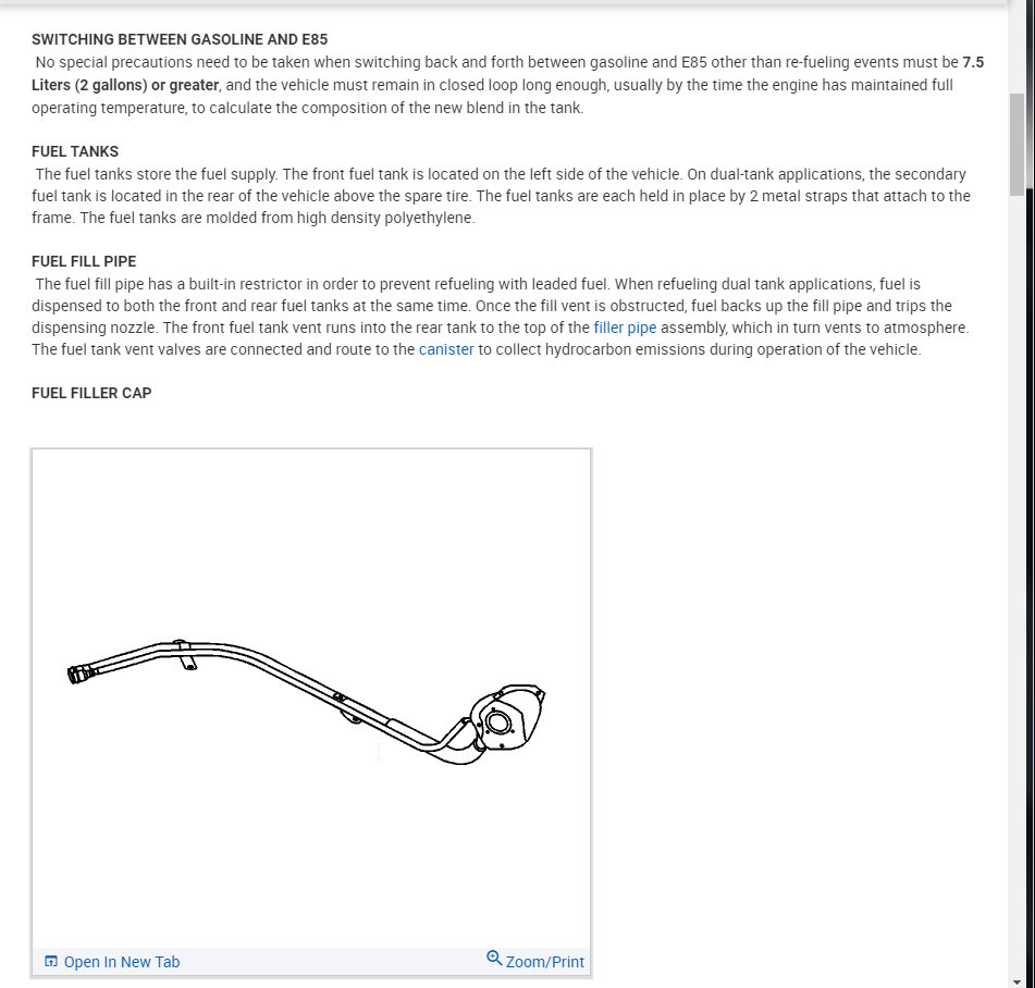

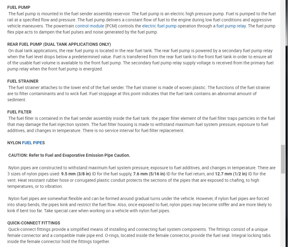

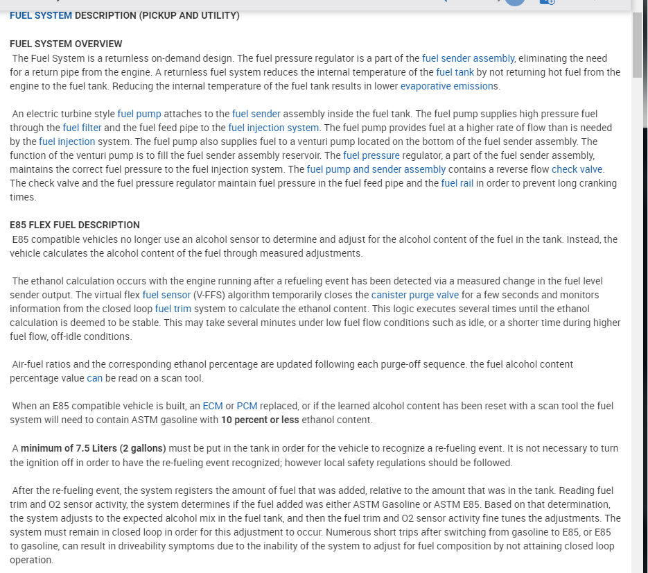

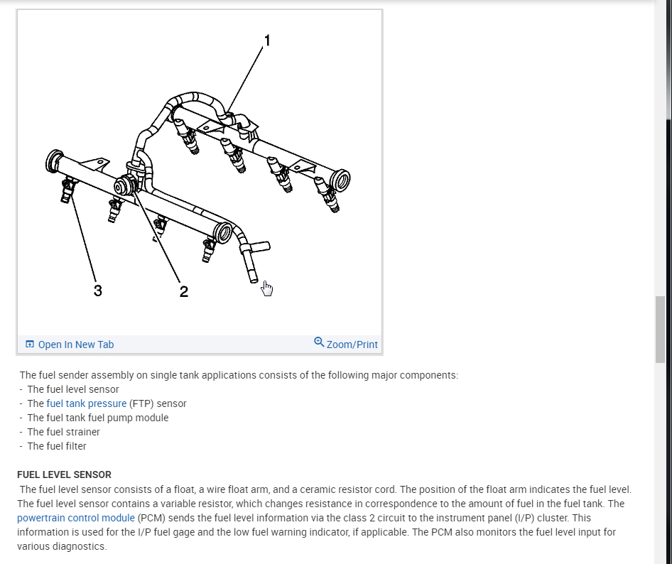

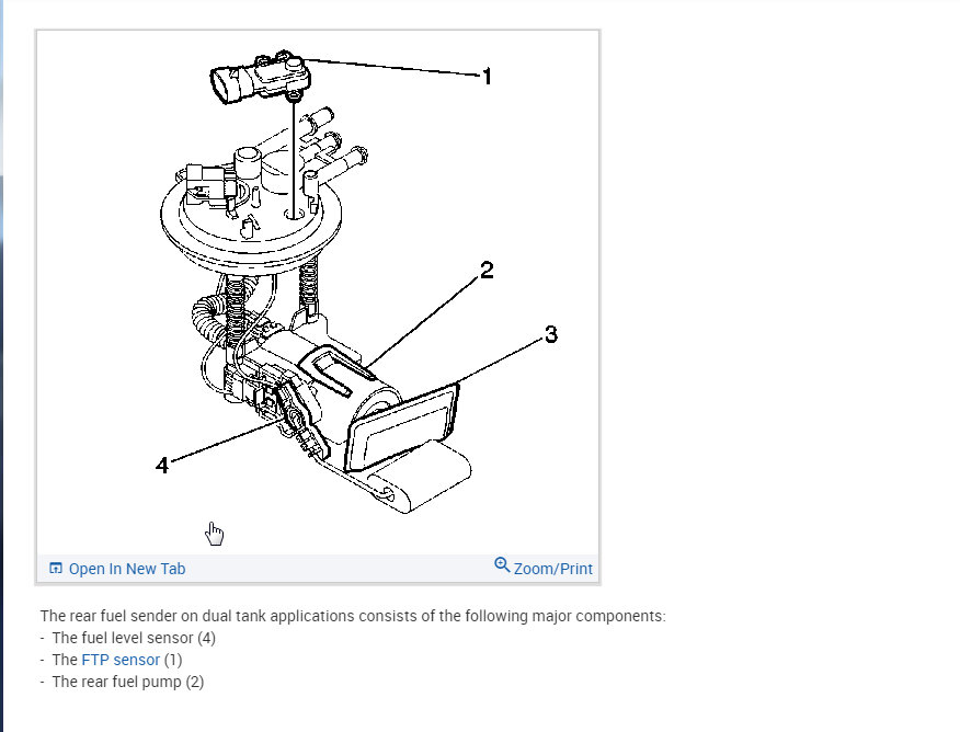

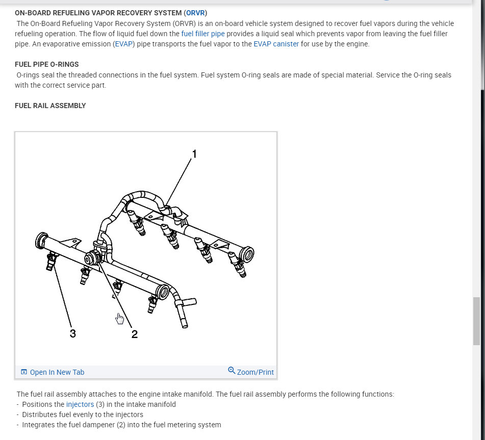

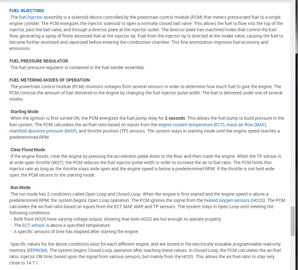

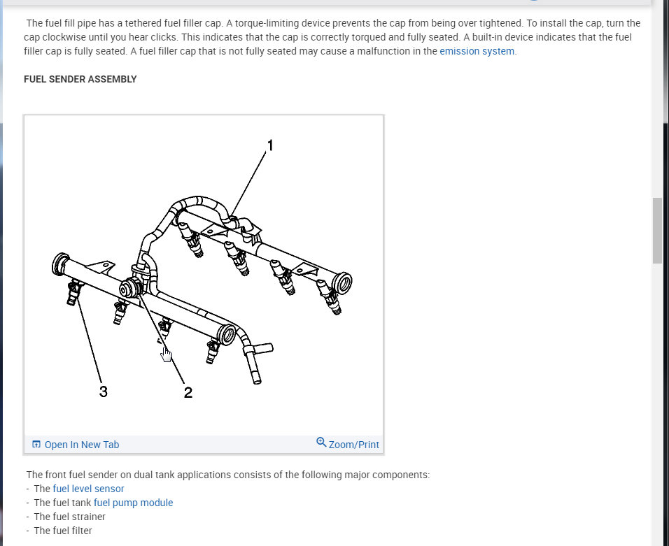

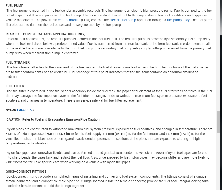

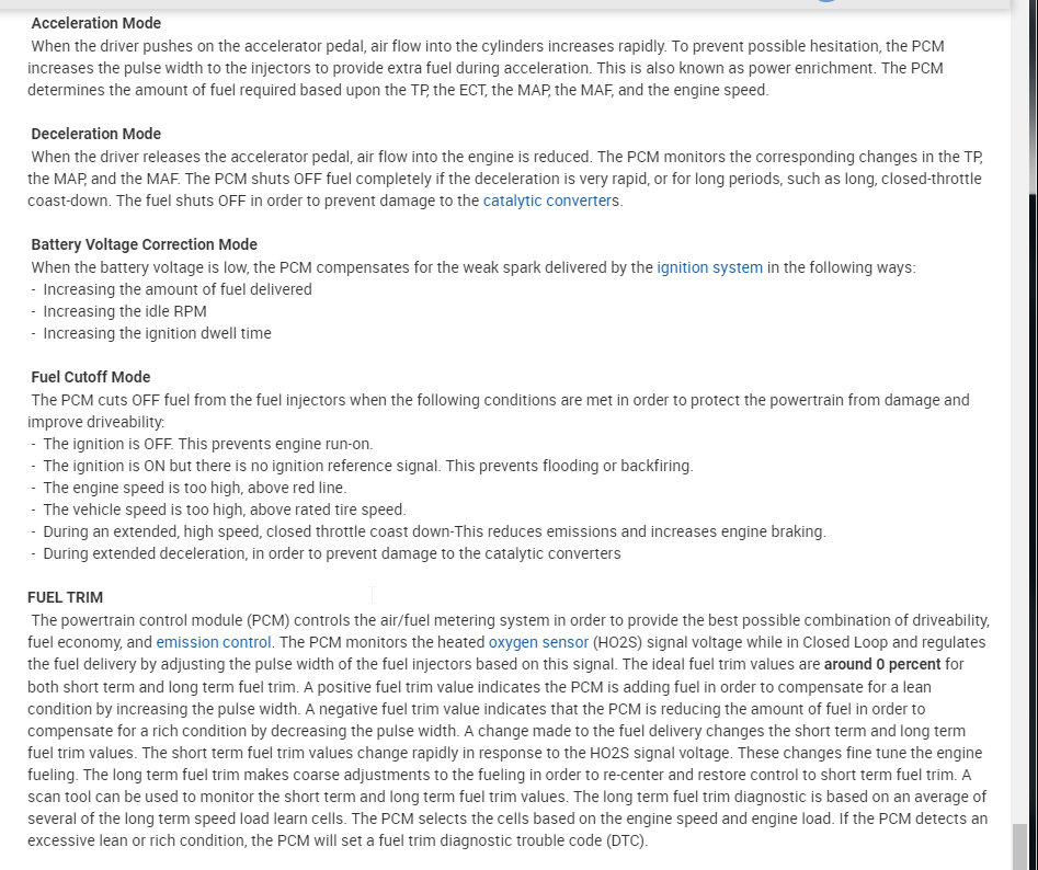

The fuel filter is part of the fuel pump assembly on this vehicle. I attached the detail about the fuel system for your review.

There is no inline fuel filter for this vehicle. Check the diagnostic service codes and the data list it could have a faulty sensor causing a lean condition. Check the quality of the fuel it could be contaminated. Check fuel pressure should be 50-60 with key on. Check intake manifold vacuum should be 17 to 21 psi. if lower than specified check air intake manifold for leaks and exhaust back pressure. I'm attaching service guides below for you to reference.

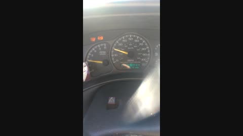

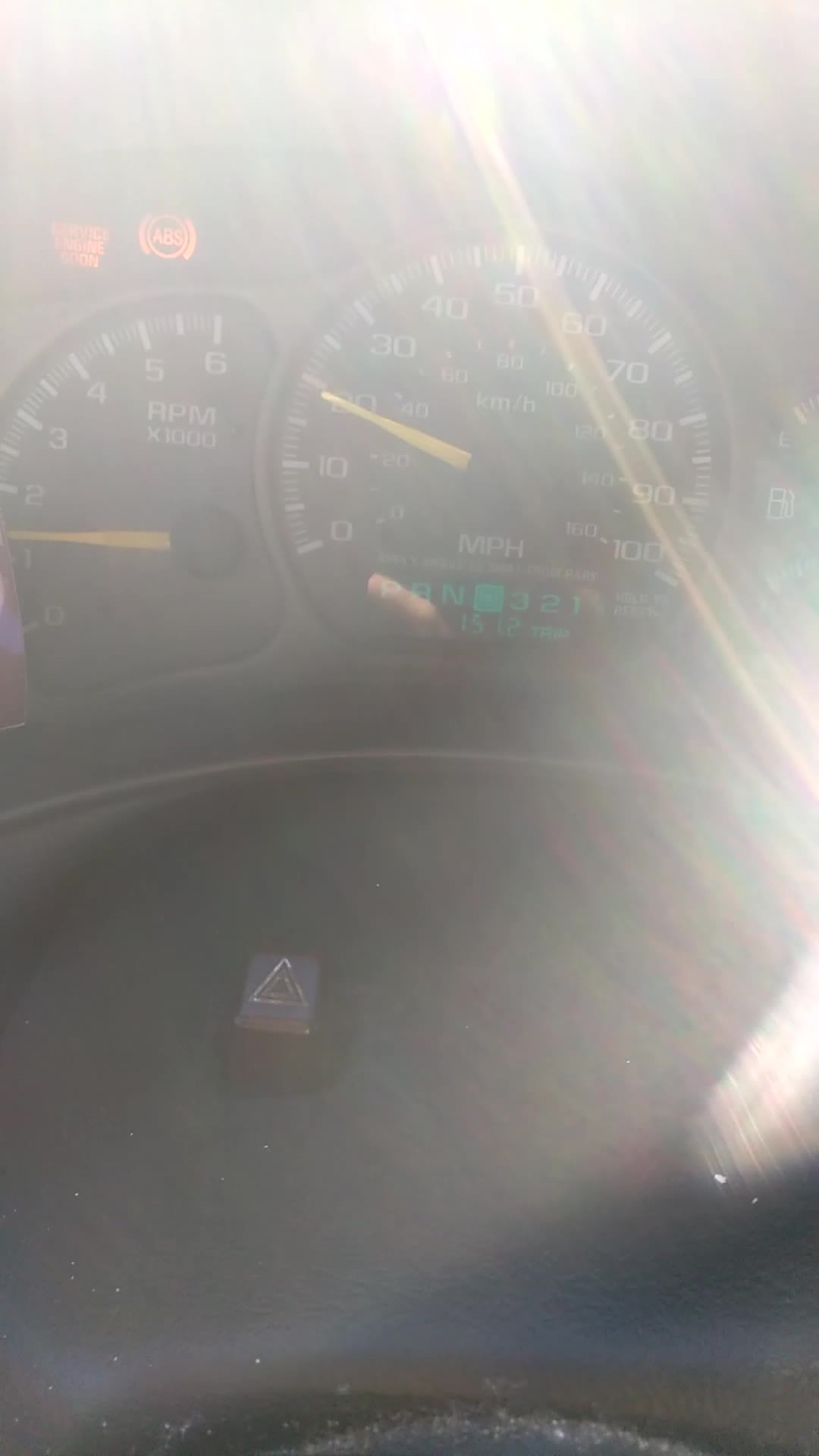

Truck just revs once it hits 3,000 rpm's and will not speed up. Drives fine in first and second gear. We changed the transmission filter but it is still doing it.
Jun 8, 2021 at 11:54 AM (Merged)
SARAH ELIZABETH CHENETTE
Video.
Good afternoon,
It could be a couple of things.
If the catalytic converter is clogged, it will act like this.
The other possibility is low fuel pressure from a bad fuel pump.
The pressure needs to be checked to verify.
The catalytic converter needs to be tested as well. You need a back pressure gauge to verify.

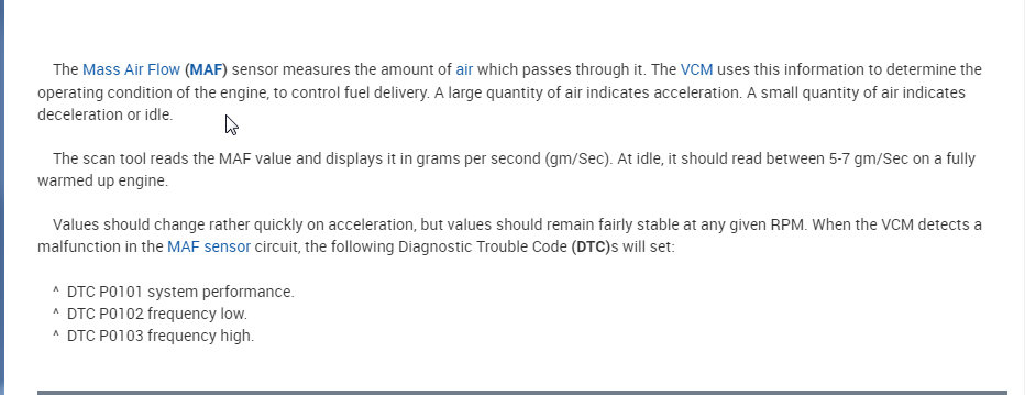

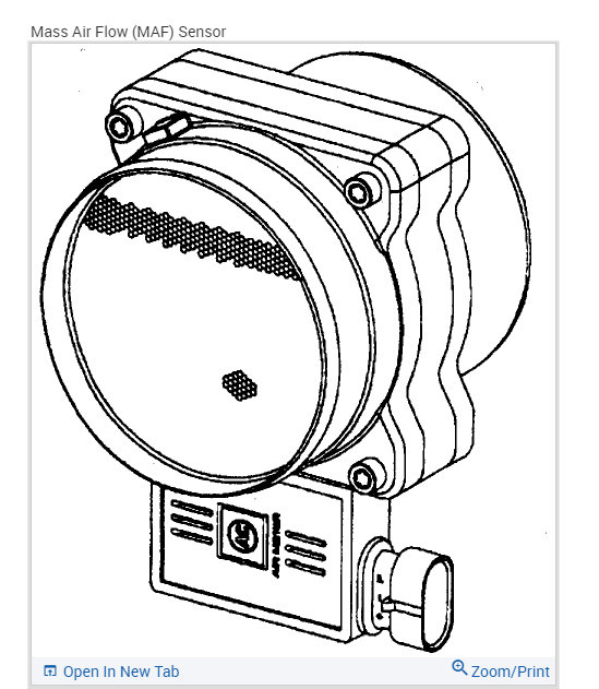

Yes the mass air flow sensor can be dirty causing a problem while not showing any codes.
Here is a guide to show you how to clean it.
https://www.2carpros.com/articles/mass-air-flow-service
sometimes this doesn't work due to the condition of the sensor and you may need to replace it.
https://www.2carpros.com/articles/how-to-replace-a-mass-air-flow-sensor-maf
