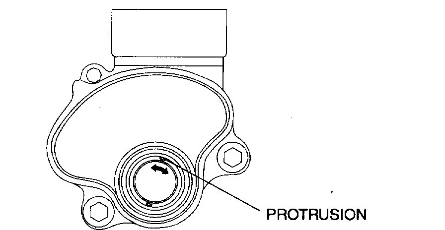

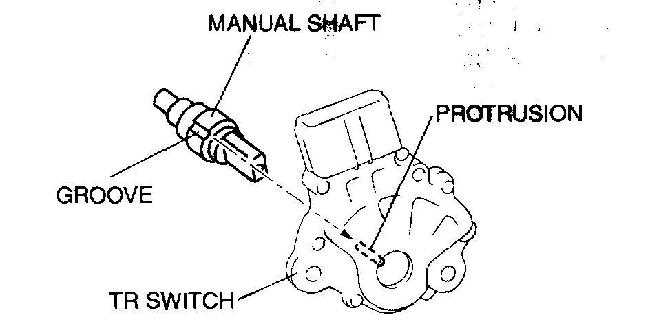

First, this model isn't offered in the US, so my technical information is extremely limited. However, the shift indicator on the dash is powered by what is called a transmission range sensor. This sensor is usually mounted to the side of the transmission and sends a signal of the selected gear to the PCM then the indicator in the vehicle.
Since the transmission valve body was recently repaired, I suspect something was left disconnected or damaged related to the range sensor.

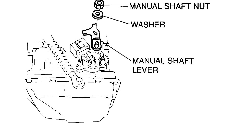

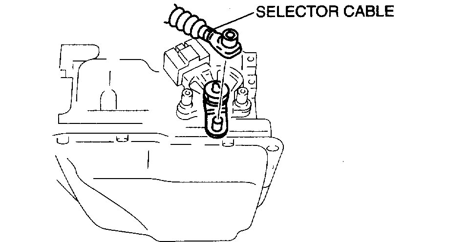

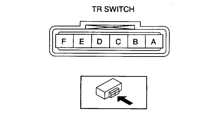

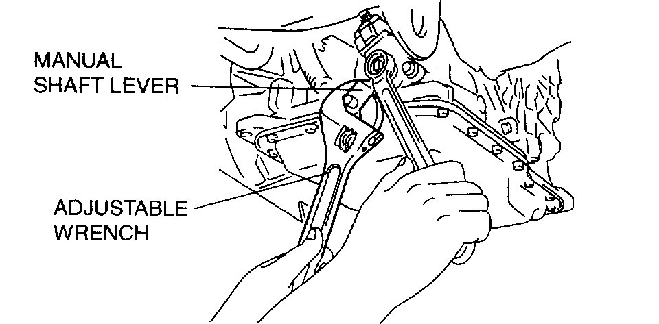

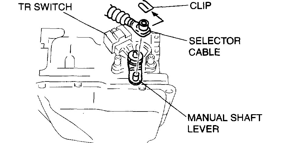

The closest thing I have to this vehicle is a Mazda 3. I will attach the directions for removal and replacement of the transmission range sensor. It should at least be similar enough to help you determine if there is an issue.
Here are the directions. The attached pics correlate with the directions.

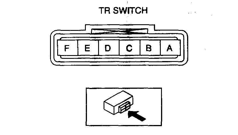

4. Disconnect the TR switch connector.

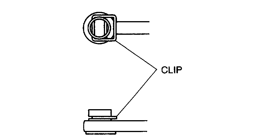

5. Remove the clip and disconnect the selector cable.

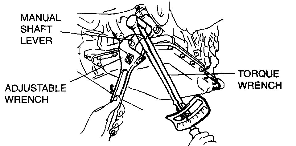

Caution: Do not use an impact wrench. Hold the manual shaft lever when removing the manual shaft nut, or the transaxle may be damaged.
pic 2
6. Set the adjustable wrench as shown in the figure to hold the manual shaft lever.
7. Remove the manual shaft nut and washer.

9. Remove the TR switch.
pic 4

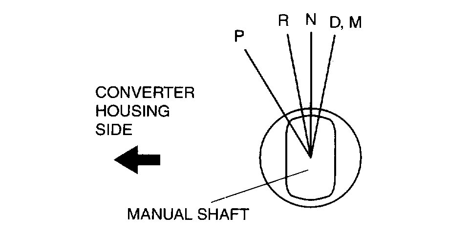

10. Rotate the manual shaft to the converter housing side fully, then return two notches to set the N position.
pic 5
pic 6
11. Turn the protrusion between the TR switch terminals B and C until the resistance becomes 750 ohms.
pic 7
12. Install the TR switch while aligning the protrusion and groove as shown in the figure.
13. Hand-tighten the TR switch mounting bolts.
pic 8
14. Inspect the resistance between the TR switch terminals B and C. If there is any malfunction, readjust the TR switch.
Resistance 750 ohms

17. Set the adjustable wrench as shown in the figure to hold the manual shaft lever, and tighten the manual shaft nut.
Tightening torque 31.4 - 46.1 Nm (3.2 - 4.7 kgf-m, 23.2 - 33.9 ft. lbs.)

18. Install the clip to the selector cable as shown in the figure.
19. Shift the selector lever to P position.
20. Turn the manual shaft lever to P position.
pic 12
21. Connect the selector cable.

Let me know if this helps.

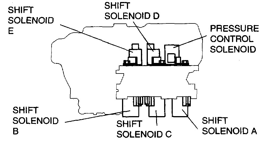

A hard gear engagement can often be caused by line pressure. Was the torque converter replaced at the same time you installed the gear box? I hate to say this, but I have nothing on line pressure specs for this model. If you can get info for this specific vehicle, I would check that. On the model 3, there is pressure control solenoid which controls hydraulic pressure. The pressure control solenoid controls the hydraulic pressure according to the current value. I have no way to even determine if that is the case on your vehicle. Sorry about that. I'm trying.

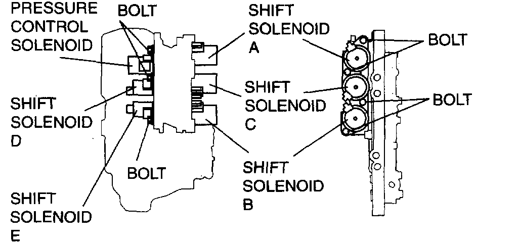

Here are the directions for replacement on the Mazda 3. Let me know if they help. It is on the valve body. See the attached pictures.
2004 Mazda 3 L4-2.0L
Solenoid Valve Removal/Installation
Vehicle Powertrain Management Transmission Control Systems Actuators and Solenoids - Transmission and Drivetrain Actuators and Solenoids - A/T Pressure Regulating Solenoid Service and Repair Procedures Solenoid Valve Removal/Installation

4. Remove the control valve body.
pic 1
5. Remove the solenoid valve (s).
6. Apply ATF to a new O-ring and install it on the solenoid valve.
pic 2
7. Install the solenoid valve in the control valve body.
Tightening torque 7.8 - 10.8 Nm (80 - 110 kgf-cm, 69.5 - 95.4 inch lbs.)
