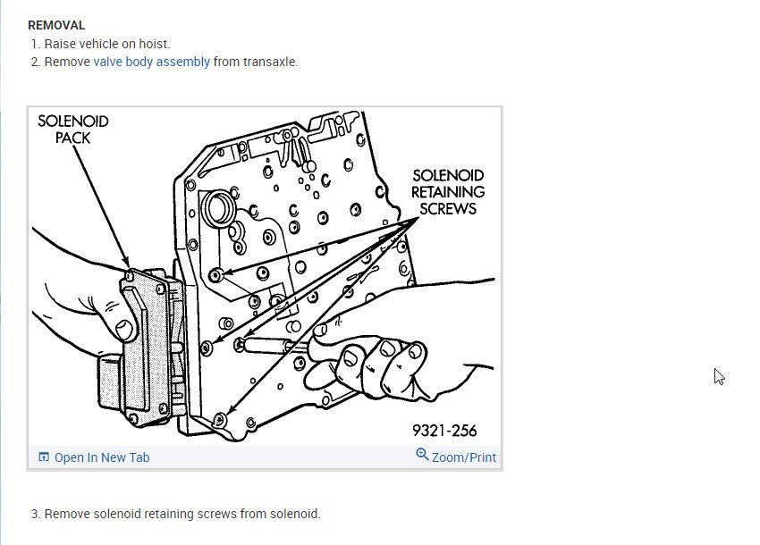

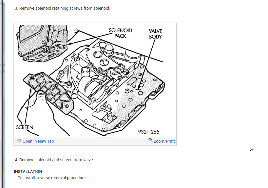

This is called limp mode. Do you have a check engine light on? Either way we need to start with checking for codes.
Once we know what codes are there we can determine what to do. If there are no codes then we need to check the fluid level and condition. If that checks out then we most likely have a shift solenoid issue.
Let us know what you find and we can go from there. Thanks

Okay. So when this issue happens the check engine light does come on? Did they find any codes? I would expect there to be stored codes so did they check?
If not, we need to stop back by and have them scan it. Then this does sound like a solenoid issue but I would want some more proof to go on so let's clarify this and go from there. Thanks
