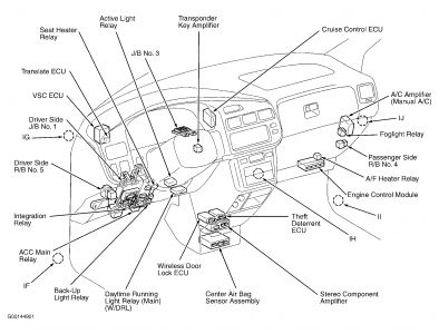

  • 75,988 POSTS
The PCM or ECM is located on right side of dash see pic below
https://images.2carpros.com/forum/automotive_pictures/12900_pcm_32.jpg
May 16, 2010 at 7:53 PM
