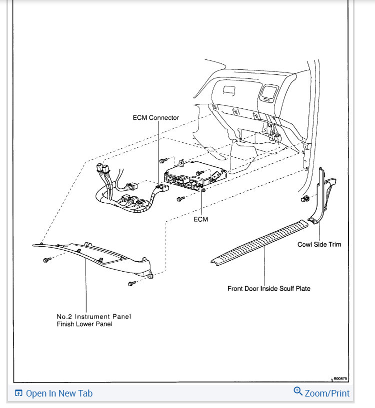

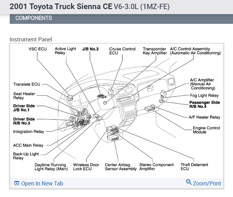

My 2001 Toyota sienna won't stay running without the code reader plugged in. Mechanic said I need a new ECM $350.00 programmed. I ride around with the reader in. A worrisome ride. Been like this for 2 years now. I want to fix it but I don't fully believe the ECM story. Gotta be something simpler. Ground? I'm sure he checked the relay.
Thursday, May 14th, 2020 AT 3:30 AM
KEN L
  • MASTER CERTIFIED MECHANIC
  • 48,323 POSTS
That is a good one. I would replace the ECM please give your VIN number to the rebuilder. The instructions to do so is in the diagrams below. Check out the diagrams (below). Please let us know what happens.
Sunday, May 17th, 2020 AT 10:30 AM
  • 52,797 POSTS
Good morning,
There is no relay and there is no ground. The data link connector run with serial data lines.
This is most likely the ECM itself that is bad.
Are there any codes set?
Sunday, May 17th, 2020 AT 11:54 AM
