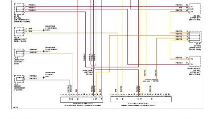

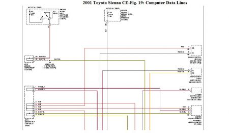

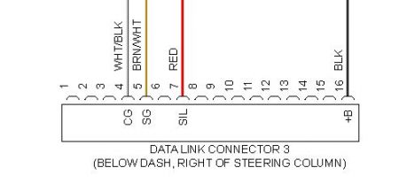

https://images.2carpros.com/forum/automotive_pictures/61395_data_link_2_1.jpg
https://images.2carpros.com/forum/automotive_pictures/61395_data_link_1_2.jpg
I hope that this is clear enough, i had to sent is as two and blow it it up as the original was far to small to read easel. mark (mhpautos)
Jun 11, 2010 at 2:40 PM
SZALKUSKT
  • 274 POSTS
Thank you for the wiring diagram! I copied it and tried to blow it up but was not readable. can you send it a different way or put it in a webshot or photobucket link so I can view it? There are only five wires on the back of the OBDII test connection port. Black, red, Pink with black tracer, brown and i believe white........A readable diagram will help.

MHPAUTOS
  • 31,937 POSTS
Mitchell 1 (where this diagram comes from) will not allow me to copy this pic, and so far any capture i try still give me the fuzzy pic, i will ask a comp tech what to do, as this is a bit out of my computer skills , i have never had this problem before so please bear with me on this please, i am working on it.
mark.
Jun 13, 2010 at 4:21 PM
MHPAUTOS
  • 31,937 POSTS

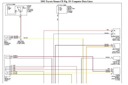

https://images.2carpros.com/forum/automotive_pictures/61395_snap_2_1.jpg
https://images.2carpros.com/forum/automotive_pictures/61395_data_link_1_3.jpg
The original is way to small and it looses quality even blowing it up a little. Is this any better for you? mark.
Jun 13, 2010 at 4:53 PM
SZALKUSKT
  • 274 POSTS
well i cannot view it at all when i try to blow it up a little. i just save it to my desktop and open it and blow it up then it gets blurry even opening a little slightly
Jun 13, 2010 at 9:33 PM
SZALKUSKT
  • 274 POSTS
i got the diagrams from the link you sent now I have some questions. On the data link connecector behind the dash to the right of the steering column on the wiring diagram four of the connector pins are labled: (TC) pink/black, (SIL) red, (CG) white/black, (Bat) black. What do these labels mean? (SIL) is the red wire on the diagram and it shoes it going to the ECM. The pink/black wire (TC) also goes to the ECM. Now the question is why does my van run when I connect thr OBD tester to the van? Initially also the new computer I stuck in there worked for 1/2-1 second then stopped.

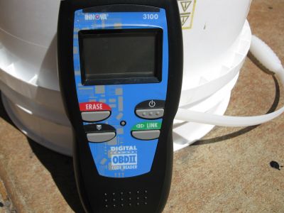

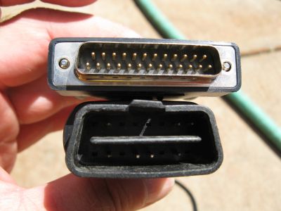

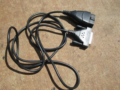

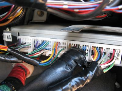

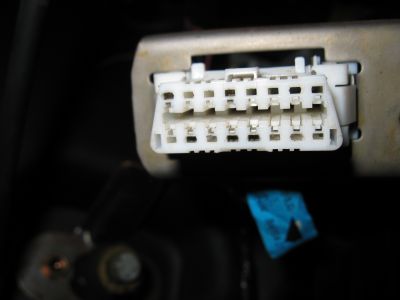

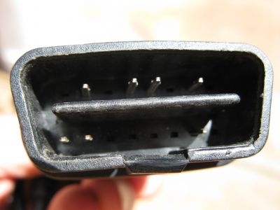

I have gone back over all the posts, and this stands out....
I pulled the scan tool itself and left the cord on and the van continued to run with just the cord plugged in. Cord gets warm a little. Once I pull the cord it dies out.
what type off scanner are you using? with the cord still attached is it still able to run) which wires to which pins feel warm? what is the connection like to look at? is it just a loon with a plug to fit both ends? is there a interface that you also have plugged in? there must be some sort of circuit associated with this "cord" as if it is, it will just be individual wires between to plugs and this will do nothing,
sorry about all the weird questions but i am really grasping at straws just now to come up with some form of attack to sort this out.
Mark (mhpautos)
Jun 19, 2010 at 11:54 PM
SZALKUSKT
  • 274 POSTS
i am using an INNOVA 3100 tester. I will take pictures of the connections. the cord, the tester etc. Thanks I understand cars, so don't worry about so many questions. I am an airplane mechanic and a car mechanic. i also went to universal tech institute in 1991
Jun 20, 2010 at 8:36 AM
SZALKUSKT
  • 274 POSTS
https://images.2carpros.com/forum/automotive_pictures/287950_Picture_1468_1.jpg
https://images.2carpros.com/forum/automotive_pictures/287950_Picture_1471_1.jpg
https://images.2carpros.com/forum/automotive_pictures/287950_Picture_1470_1.jpg
https://images.2carpros.com/forum/automotive_pictures/287950_Picture_1457_1.jpg
Jun 20, 2010 at 8:45 AM

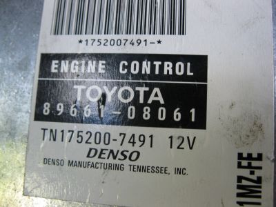

SZALKUSKT
  • 274 POSTS
https://images.2carpros.com/forum/automotive_pictures/287950_Picture_1473_1.jpg
https://images.2carpros.com/forum/automotive_pictures/287950_Picture_1477_1.jpg
https://images.2carpros.com/forum/automotive_pictures/287950_Picture_1472_1.jpg
Jun 20, 2010 at 8:50 AM
MHPAUTOS
  • 31,937 POSTS
With your back ground, then i am sure that you can understand my own frustration with this, have you considered the last set of questions i sent?

I think that there is a circuit associated with the cord because if there was no circuit the cord would not do anything
Jun 20, 2010 at 8:00 PM
MHPAUTOS
  • 31,937 POSTS
A continuity test of the adaptor loom would show up, if you get 0 ohms resistance down each wire, that should tell you, would you agree?
Mark (mhpautos)
Jun 20, 2010 at 8:05 PM
SZALKUSKT
  • 274 POSTS
which loom are you referring to? I should read out the van's data link connection or the black OBDII tester cable? The black tester cable to see how the circuit of the cable is set up? We know it is the cable that is sending power through/or grounding a circuit to make the van run.
Jun 21, 2010 at 4:54 AM
MHPAUTOS
  • 31,937 POSTS
The OBD scanner cable, i cant see how that is creating a circuit.
Jun 21, 2010 at 9:50 AM
SZALKUSKT
  • 274 POSTS
the main problem is that with the cable plugged in it is making the van run so it is allowing a pin to cross over to another pin. So I should run the continuity test on the OBD tester cord to see what it is doing when it is plugged in.
Jun 21, 2010 at 10:20 AM
MHPAUTOS
  • 31,937 POSTS
Yes, so i would be checking that cable independently first,
also just to let you know, in a few days i will be away for about 1 week, so i may not be able to reply as i wont have any access to a network where i am going.
mark

I jumpered the data link connection on the van. it is the 2 together in the middle on the bottom row. I jumped it with some wire and it got very very hot. the van started and ran. this should help us now. What do you guys think now?
https://images.2carpros.com/forum/automotive_pictures/287950_Picture_1478_1.jpg
Jun 21, 2010 at 8:10 PM
MHPAUTOS
  • 31,937 POSTS
This is the schematic of the data link connector, what is the colour of the 2 wires you have bridged out?
https://images.2carpros.com/forum/automotive_pictures/61395_Capture_38.jpg
mark
Jun 21, 2010 at 8:37 PM
SZALKUSKT
  • 274 POSTS
white/black & brown
