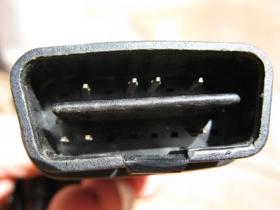

Am trying to find out what the pins on the data link that you bridged go to, this is driving me insane trying to get this sorted...lol

what is cg and sg?
Jun 22, 2010 at 8:58 PM
MHPAUTOS
  • 31,937 POSTS
I have no idea , and there is no indication in Mitchell 1 either, this is what i am trying to find out.

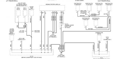

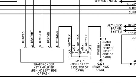

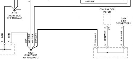

Definitly Ohm them out to ground.I cant seem to find the Brown/white wire in theschematic I have (Mitchell) but the White/black goes to a ground behind the right side of the dash and it shares that ground loop with the "Transponder Key Amplifier" So if this gound circuit is bad, it may not be seeing the key in the ignition which would expalin why it wont run

Both wires should be good grounds, like the white/black.I found the other in the ground dist wiring diagram.looks like you may have a bad ground that is being substituted by the jumper when it is plugged in

Did you check the ECM grounds on the diagram I posted?If it runs with that grounded and the ground circuit has that much resistance for the ECM it cant ground on its own.The white/black has good continuity to ground,I dont think its the problem, the other should have the same but doesnt. The key may not need a chip, just sees a key going in so it knows it isnt being hot-wired

It is hard to read the schematic, i will try more. Is it possible to send a better one or hand draw something?I cannot see what you are talking about, but we are getting very closer now!!! So, the one wire has higher resistance than the other , does to ground? Is that the bad circuit because it has so much resistance 8.1 vice .5 ? when you read the diagram what do you think I should do next? So maybe the key in the ign. reader is on my van for sure? Is every 2001 sienna built with a key amplifier that reads the key in the ign.?
Jun 28, 2010 at 4:50 AM
2CARPRO JACK
  • 11,533 POSTS
There is a main ground on the right side of the firewall that the ECM uses as well as the data connector.Im sure they all have a key reader, it has been used for a long time, since the chipped keys turned out to be kind of unreliable

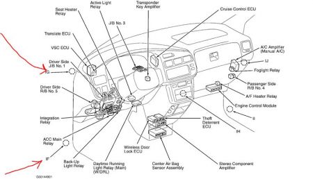

Check the earths as indicated, this pic may help locate them, it is the best that Mitchel 1 has.

what are the 2 red arrows pointing to? The connections are labeled what numbers? I noticed a connection under the hood near the air cleaner box which is bolted to the side of the van (inner fender) and grounded.

The arrow is indicating the vehicle earth points, there is no indication in Mitchell 1 as to where the exact earth point is, short of purchasing a factory manual i can't pin point the earth points any closer than this, a trained tech will see this diagram and have the ability to look at the car first hand and locate the earths looking at the loom, i can't be your eyes for this part, earths are normally a group of terminals if you follow the loom it will be apparent, when located you have the colour codes to start doing what jack has suggested.

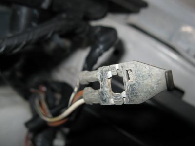

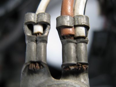

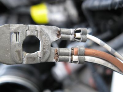

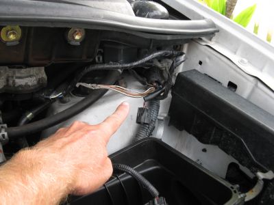

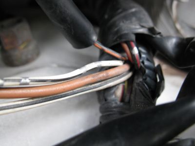

i found the ground(earth). It is the upper right corner by the air cleaner box. I unbolted the wire from the fender and read from the data link connector to the terminal where the three wires meet and the brown one seems to have continuity but high resistance. here are some photos to help us out............

any ideas what to do with the brown wire?
Jul 2, 2010 at 5:21 AM
2CARPRO JACK
  • 11,533 POSTS
Judging by the diagram I posted before, teh brown is to the key amp and the wire from the data link connector is brown/white.Im know it is a few bucks, but you may want to consider getting a Mitchell1 sub for a day and printing out all the wiring diagrams so you can see all of what we are dealing with as far as grounds go.I dont see anything beyond a bad firewall connection/bad wire that would make that ckt have such high resistance
Jul 2, 2010 at 3:37 PM
SZALKUSKT
  • 274 POSTS
Why is the data link brown/white wire making continuity to the brown wire? I guess i will have to uncover all the wiring from the data link caonnector to the firewall ground then and see why it has high resistance. maybe the key amplifier is bad causing high resistance. Where is the key amplifier located?

Key readers or amplifiers are normally next to the key barrel, see pic i posted with the arrows, it shows the key amp in the steering column near where the key would be.

Well, I took the brown and white wire on the back of the data link connection and soldered a same size if not slightley larger wire to it and grounded it out permanently. the van starts up and runs perfectly and the new spliced in wire does not get hot at all or too warm so that I cannot touch it at all. So by me grounding that brown/white wire the van is fine. I looked at my ignition switch and the mitchell manual and according to where the mitchel manual says that the key transponder is my van does not have one. I double checked and iit does not have a key transponder. So, what did I do by grounding out the brown/white wire? that is the question now. I still want to know

I would say that if you have replaced that earth wire and all is OK, it is not so much a matter of making the earth sound, i would say that in the loom the earth wire and a power supply or signal wire have breached causing the high resistance and all the problems, the new sound earth should be proof enough that this is the case, i would terminate the faulty wire at the chassis earth and just run a new permanent earth.
Mark
Jul 5, 2010 at 2:08 PM
SZALKUSKT
  • 274 POSTS
i dont know what you mean by terminate the chassis earth. all i did was solder in a brown wire to the back of the data link connector and ground it because the loom is buried behind the dash.
