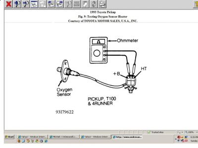

ok, i got out the ohm meter, but where do i find the +B and HT things? i looked at the diagnostics box under the hood and there is a +B but no HT. is there somewhere else i have to stick the probes?
Sep 5, 2019 at 5:14 AM (Merged)
JAMES W.
  • 2,394 POSTS
You want to test the O2 sensor accross the terminal where the sensor lead plugs into the wiring harness. Keeping in mind, if the sensor is much above or below 68 degrees it will change the ohm readings. I'll pull a schematic and attach it to this post.
JAMES W.
  • 2,394 POSTS
O2 test pins.
https://images.2carpros.com/forum/automotive_pictures/248092_93toyotapickup_1.jpg
93YOTAPROJECT
i tested the o2 sensor. andi got 3.92, that was at the outside temperature which is aroud 70-75 degrees. so tomarrow im going to go up to discount parts store and check a new one. hopefully this is the problem. i'll get back to you with what i find out.

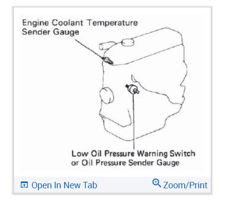

  • 55,333 POSTS
I have seen the engine coolant temperature sensor causing this issue it shorts out at times causing the engine to have issues. Here is a guide to show you the steps to change it and the location of the sensor on your car below:
https://www.2carpros.com/articles/coolant-temperature-sensor-cts-replacement

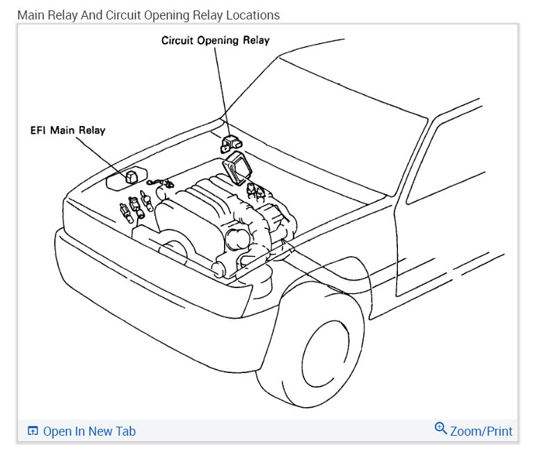

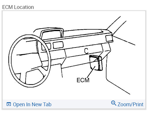

  • 55,333 POSTS
If the gauge is working the sender can be okay, does the EFI and circuit open relay work? Here is the location and a guide to test them:
https://www.2carpros.com/articles/how-to-check-an-electrical-relay-and-wiring-control-circuit.
If they check out I would get a used ECM and install it.
