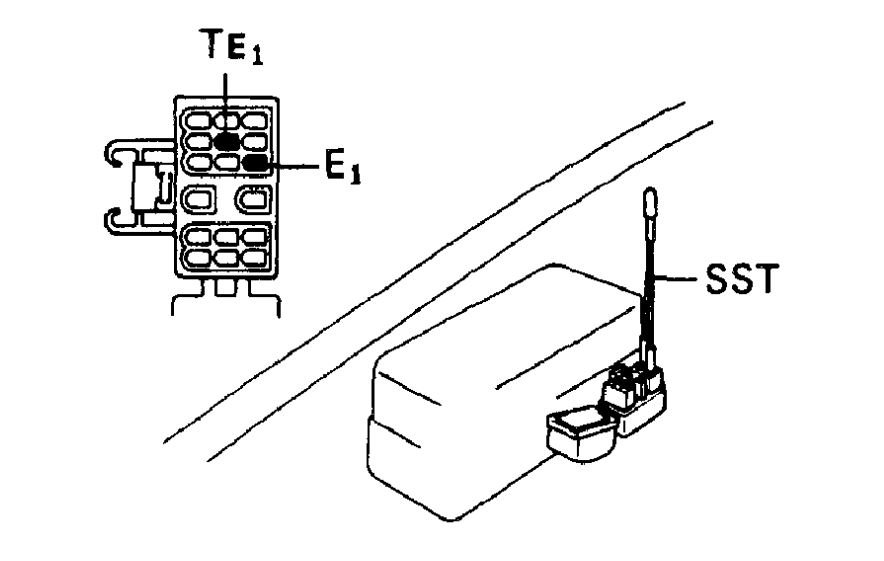

1st you need a repair manual-then find the diagnostic check connector and jumper TE-1 to E1 this will flash the code/s that's been stored in the brain Computer and comeback with it. THis guide can help us get the codes

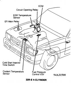

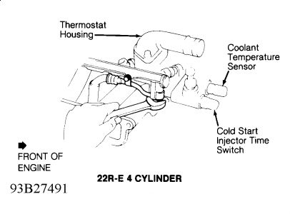

On my 1994 22 re pickup the check engine light is on and 80% of the time it has not power, bad fuel mileage and runs rich and will shut off. I pulled the code and comes up water temp sensor.The temp gauge is working normal so it must be the water temp sensor for the efi. The question is where is it located at and would be helpfully if you had a picture of it. THANKS

Hows this
https://images.2carpros.com/forum/automotive_pictures/198357_Graphic_373.jpg
https://images.2carpros.com/forum/automotive_pictures/198357_Grafic_3_99.jpg

When I short circuit from T1 to E1 the check engine light blinks continuously. Any suggestions?
Nov 15, 2020 at 8:40 AM (Merged)
  • 75,992 POSTS
Is it blinking continously without pausing for a sec?
Check for power at the batt pin on the computer might not be there.

Check engine light comes on after 1-2 minutes after cranking. jumped te1-e1 and check engine light wont flash a code. I have put plugs, wires, cap, rotor, fuel filter, changed fuel injectors, fuel pressure regulator, fuel pump relay, ignition coil, temperature sensor, AFM sensor, TPS, fuel pump, and EGR valve. I didn't mind changing all those on a 25 year old truck, but would like to just be able to remedy this situation. Thanks for any help
Nov 15, 2020 at 8:41 AM (Merged)
Good morning,
Does the check engine light come on when the key is turned on?
I attached the code chart for you below and the procedure. If you followed the chart as described and it will not show codes, then I would think you have a bad ECM.

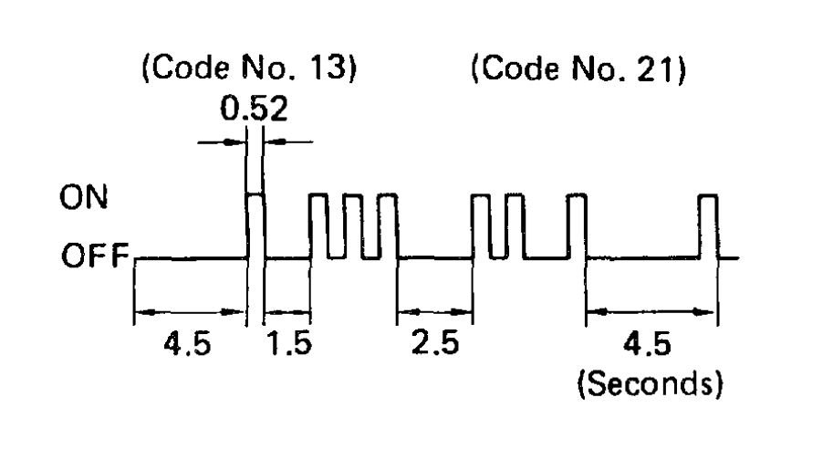

DIAGNOSTIC TROUBLE CODES OUTPUT
To obtain an output of diagnostic trouble codes, proceed as follows:
1. Initial conditions
a. Battery voltage 11 volts or more.
b. Throttle valve fully closed (throttle position sensor IDL points closed).
c. Transmission in neutral range.
d. Accessories switched OFF.
e. Engine at normal operating temperature.
2. Turn the ignition switch ON. Do not start the engine.
3. Using SST, connect terminals TE1 and E1 of the DLC 1.
SST: 09843-18020
HINT: The DLC 1 is located near the No.2 relay block.

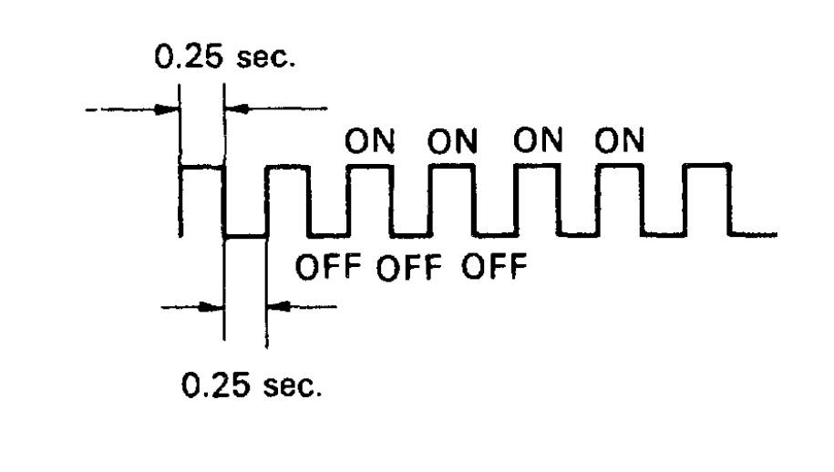

4. Read the diagnostic trouble code as indicated by the number of flashes of the Malfunction Indicator Lamp.
a. Normal System Operation
The lamp will blink 2 times per second.
b. Malfunction Code Indication
The lamp will blink a number of times equal to the malfunction code with pauses as follows:
1. Between the first digit and second digit. 1.5 seconds.
2. Between code and code, 2.5 seconds.
3. Between all malfunction codes, 4.5 seconds. The diagnostic trouble code series will be repeated as long as the DLC 1 terminals TE1 and E1 are connected.
HINT: In the event of a number of trouble codes. indication will begin from the small value and continue to the larger in order.
