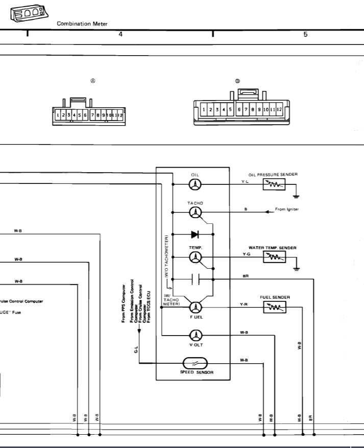

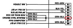

I just bought the part to replace my speedometer. The old/broken part was found, however there is no visible wires showing and it appears they have been cut back to prevent from tangling or getting wrapped up in something. I have been looking for a speedometer wiring diagram with no success. Anybody have suggestions? I looked up the repair manual, and didn't find much there.

https://www.2carpros.com/forum/automotive_pictures/261618_Noname_1135.jpg
https://www.2carpros.com/forum/automotive_pictures/261618_Noname2_326.jpg

I need a wiring diagram and the one previously posted is not large enough to read. Can anybody find a bigger diagram that is visable, or refer me to a website to obtain one myself? Thanks!

Due to the age of the vehicle, there are not too many good quality wiring schematics available.
I have attached the speedometer wiring diagram below.
