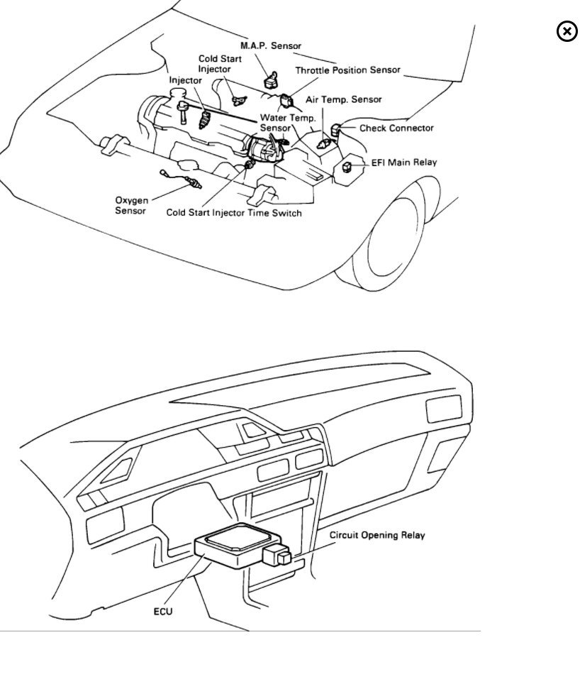

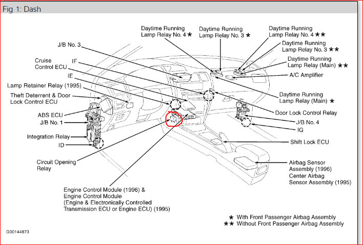

My fuel pump is not getting power so I need to locate the relay. I have looked online for the solution and I have yet to find one.

On your vehicle it is known as the Circuit Opening Relay. I have attached a picture showing its location and circled it in red. It is located below left center of dash, next to engine control module. I have also attached a link showing you how to test a relay. Hope this helps and feel free to ask any questions if needed. Thanks for using 2CarPros.

Need to know where fuel pump relay is please

The fuel pump relay is called a EFI relay on this car and it is located near front fender well on the drivers side. Here is a diagram (below) if its location. Please let us know if you need anything else to get the problem fixed.
