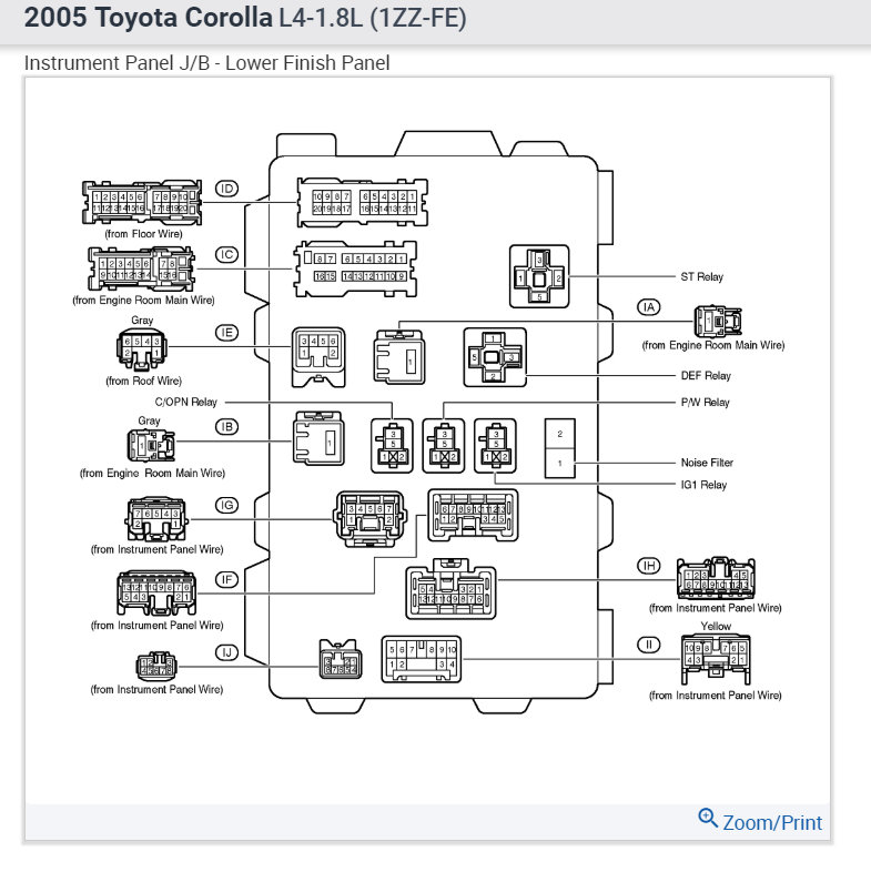

Where is the fuel pump relay located?
Sep 2, 2009 at 9:52 AM
MMPRINCE4000
  • 8,548 POSTS

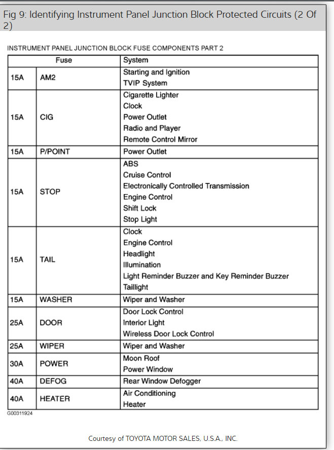

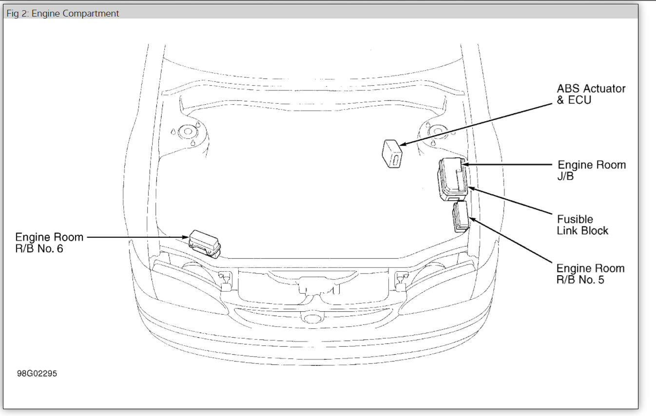

This relay is called the C/open relay located in the fuse box under the hood. Here is a guide to help you test it with the locations of the relay below:

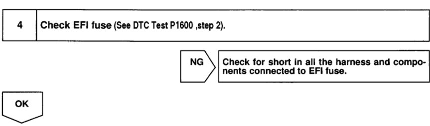

Was the smashed fuse panel replaced? If not it may be your problem. Check your EFI fuse 1 and 2 and EFI relay as well as open relay in dash.

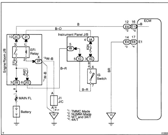

It is the c/open relay which I did not put it all down, the EFI relay supplies power to the c/o relay which supplies power to pump. The EFI relay is under hood and the other in dash. Just switch with a like relay to see if it makes pump work. But I really think with the cracked fuse box one of the connectors is not making good contact and pump does not work.

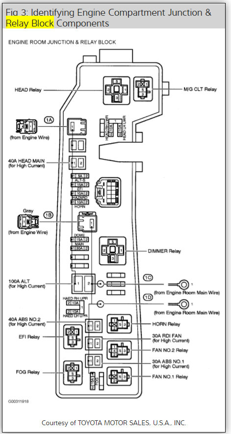

Here is a guide to help test the fuel pump relay (EFI relay is the fuel pump relay) with the location is the diagrams below.

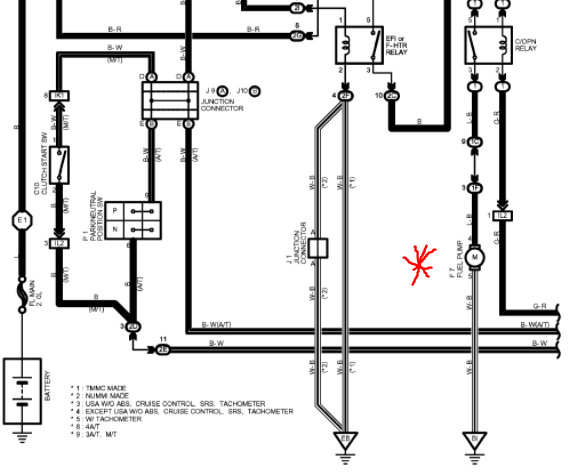

Checked control side power it's there and load side power it's there; with relay it will not prime the fuel pump turning key to on position. When jumper wire is between the two control terminals the car starts fine.
used test light to check parasitic draw negative battery post to negative cable, what test light did was lit dimly 2 second flash disappeared. did same for the positive side flashed light is gone. is this a direct short signal somewhere or a defective open circuit relay?
Mar 2, 2021 at 9:32 AM (Merged)
DANNY L
  • 5,648 POSTS
Hello, I'm Danny.
From what it sounds like from what you found while testing it sounds like you have an open in the actual relay.Have you swapped out the relay with a known good or new one? Here is a tutorial showing how to test a relay:

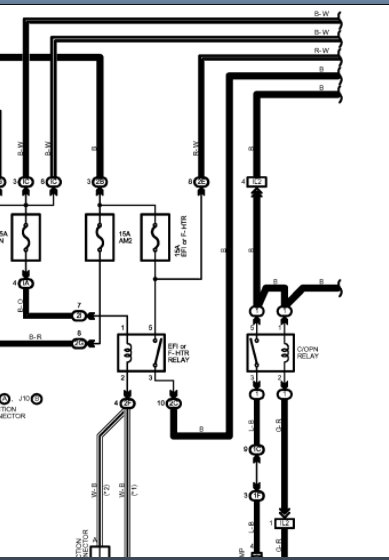

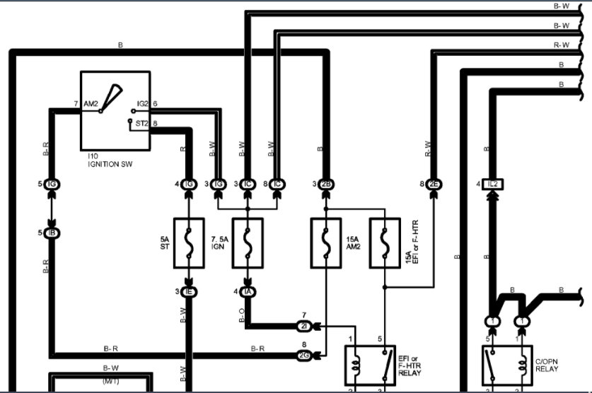

I've attached a fuel pump and relay wiring diagram for you below. I've cut the picture into 2 pieces so you can view larger.Hope this helps and thanks for using 2CarPros.
ALPHASENTORY GALAXY
  • 41 POSTS
Hello Danny,
Tried swapping open-circuit relays 5 i had on my box they all worked with the jumper wire between the load side power.
Re-checked power on load side it was on. The control side power came when key was on position.
Then test-light to battery positive tested for ground side, the load side ground lit the test light.
The control side ground did not light up the test light.
No ground on control side. Is this computer transistor that blow out?
Then check the red green wire at the computer while connected with key in position no power dead even while cranking it feeds control side of relay. Check adjacent black; red; white; yellow no power.
Checked fuse panel under dash all fuses okay 2 ign one feeds EFI relay checked black wire no power all fuses okay.
How do I check a transistor with test light on computer side? If car starts when jumper wire is in place does it mean the computer is find and that i have to use a short finder or an amp probes on the harness which I do not have?
Confused I still have not confirmed the correct open circuit relay computer when it see air coming in through air flap it sends power to fuel pump.

Control ground side does not light up when test light is on battery positive. Could this be a ground that is not contacting? The computer itself is floating from its housing without being grounded or it has a ground that is very loose is the cause.
DANNY L
  • 5,648 POSTS
Hello again.

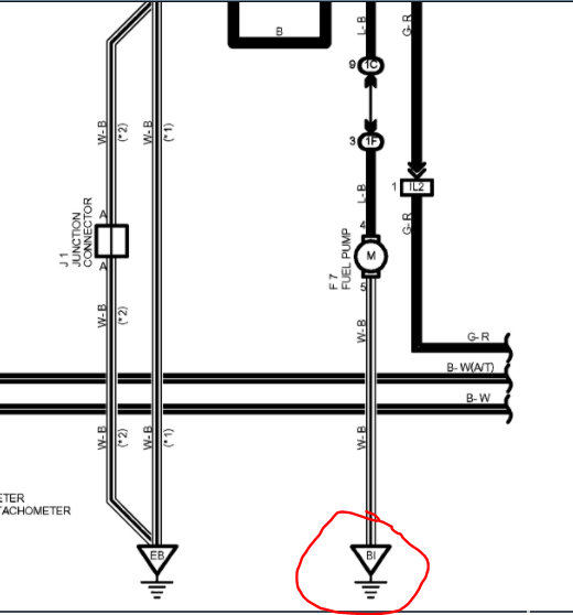

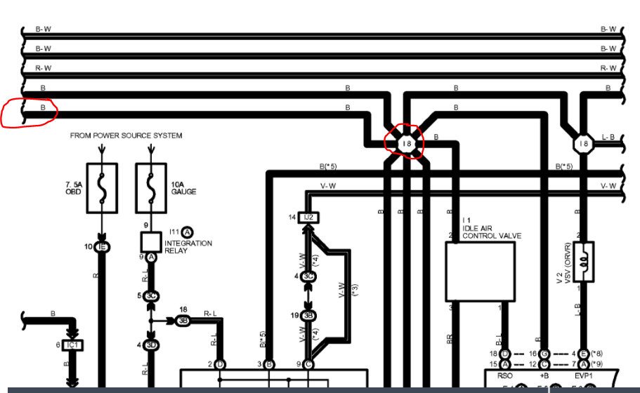

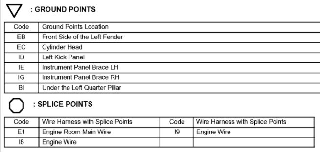

Yes, it does sound like you are having a ground issue. I've attached additional wiring diagrams below showing the ground circuit for the fuel pump. I've circled in red the ground path.Let me know if you have any further questions on this issue and keep me updated.Check for continuity in the ground wires using a DVOM - digital volt ohm meter and all ground points for corrosion,breakage,looseness, meting,or poor conductivity etc.Hope this helps and thanks again for using 2CarPros.
Danny-

Got the car started with key; found bias voltage of 12.56 volts on the ground side of the control of fuel relay.
I did not check ECM transistor that grounds the current using a second test light to other test light to ground terminal with key starting to see if it is blinking on off. I had forgotten to do this test checking transistor in ECM ground side of control side of fuel relay.
I did not check connectors nor the harnesses for poor contacts and burnt wires or shorted don't know how to use amp probe for tracking down shorts.
Did resistance from ECM terminal to relay ground side of control side terminal there was a very high resistance reading of almost 2000 mm-volts.
How I started the car created a ground side wire connecting it to the ground of battery terminal through the dash and wrapped it to the ground control side with relay plug in; it started up and the fuel pump was heard pumping fuel but there was no 2 second prime is this normal for this car?
Respectfully, Alpha/galaxcy

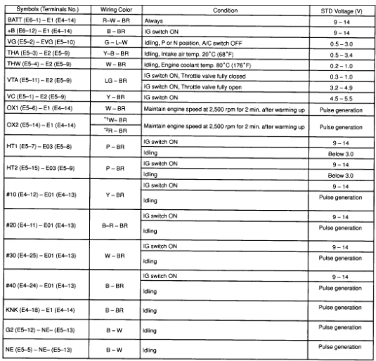

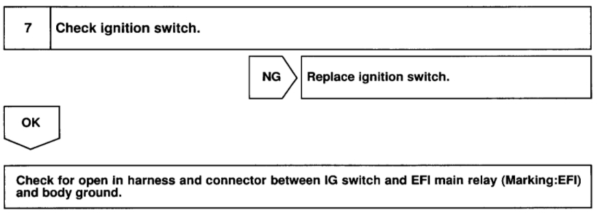

Mar 2, 2021 at 9:33 AM (Merged)

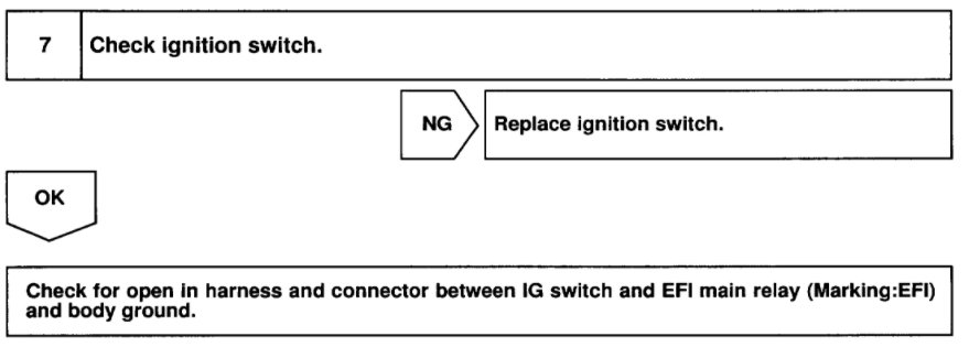

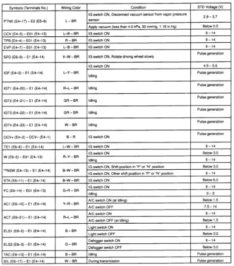

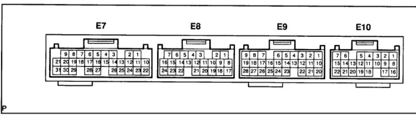

DANNY L
  • 5,648 POSTS
Hello again.

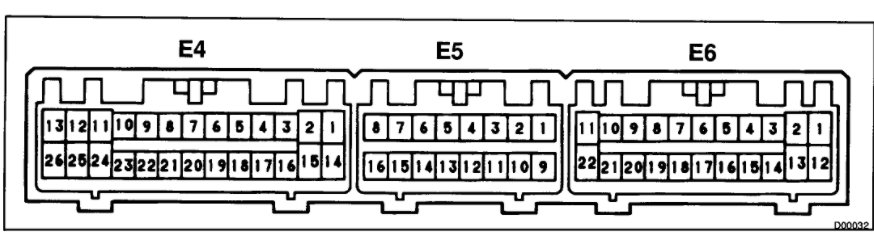

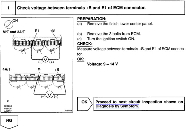

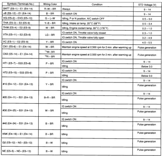

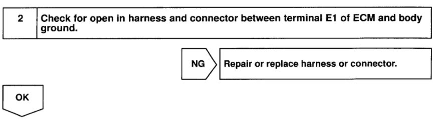

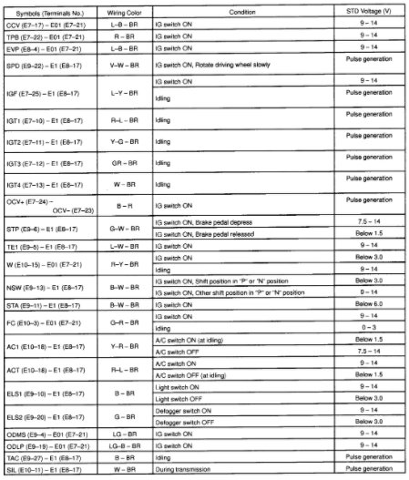

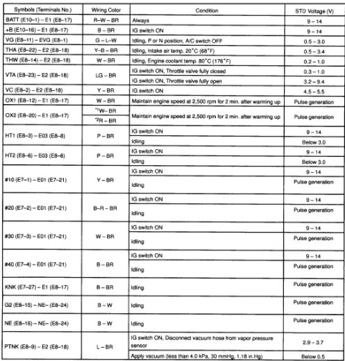

This is what I found for information on testing the ECM. I've attached picture steps below. Hope this helps and keep us updated as to what you find. Thanks again for using 2CarPros.
Danny-

HEARDTROD

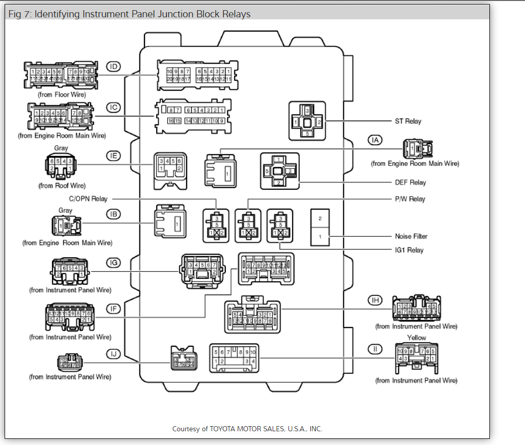

Where is the fuel pump relay located please?
MMPRINCE4000
  • 8,548 POSTS

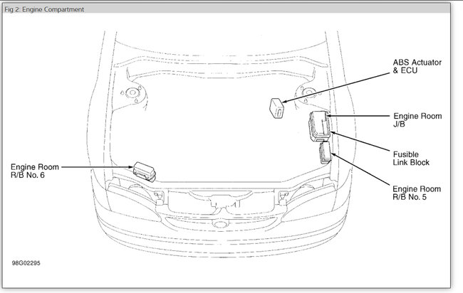

It is inside the engine compartment it is call an circuit open relay, I have included the location in the diagrams below with a guide to help test it.
Have a friend turn the ignition. on while you put your finger on top of the relay, you should feel a "click", if not the relay may be bad.
You can go to a junkyard and usually get a used one for $10 or less.
You should also check fuel pressure with a mechanical gauge, to verify the relay is bad (you would get no pressure if the relay is the culprit). Check out the diagrams (Below). Please let us know if you need anything else to get the problem fixed.

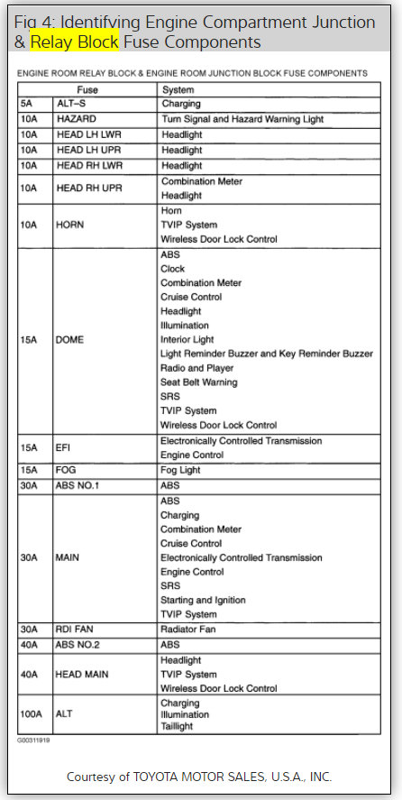

ROD SMITH
where are the fuel pump relay location.
BLUELIGHTNIN6
  • 16,542 POSTS
your vehicle uses an EFI relay instead of fuel pump relay. it is located on junction box number two (on left side of engine compartment).

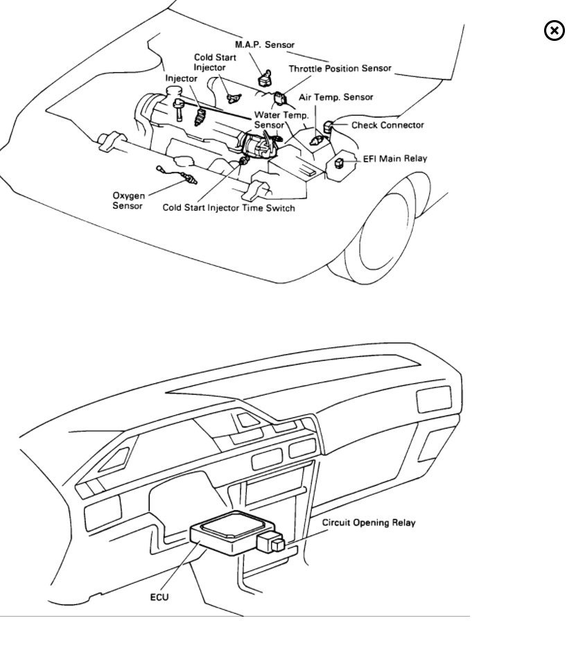

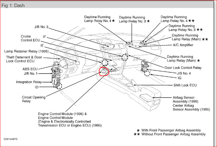

KBOB5ERT
My fuel pump is not getting power so I need to locate the relay. I have looked online for the solution and I have yet to find one.
Mar 2, 2021 at 9:38 AM (Merged)
DANNY L
  • 5,648 POSTS
Hello, I am Danny.

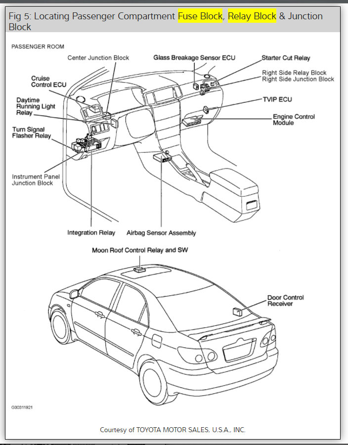

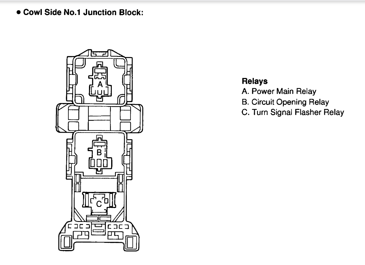

On your vehicle it is known as the Circuit Opening Relay. I have attached a picture showing its location and circled it in red. It is located below left center of dash, next to engine control module. I have also attached a link showing you how to test a relay. Hope this helps and feel free to ask any questions if needed. Thanks for using 2CarPros.
Danny-

  • 54,837 POSTS
The fuel pump relay is called a EFI relay on this car and it is located near front fender well on the drivers side. Here is a diagram (below) if its location. Please let us know if you need anything else to get the problem fixed.
