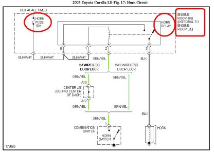

I am missing the manual for my car, can you tell me which one is the fuse for the horn. Thanks

It is a little small, but you should be able to see the red boxes for the fuse and relay.
Here is a slightly larger one.
If you can't see it, email me and I will send you the jpg file direct.
