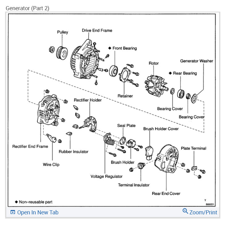

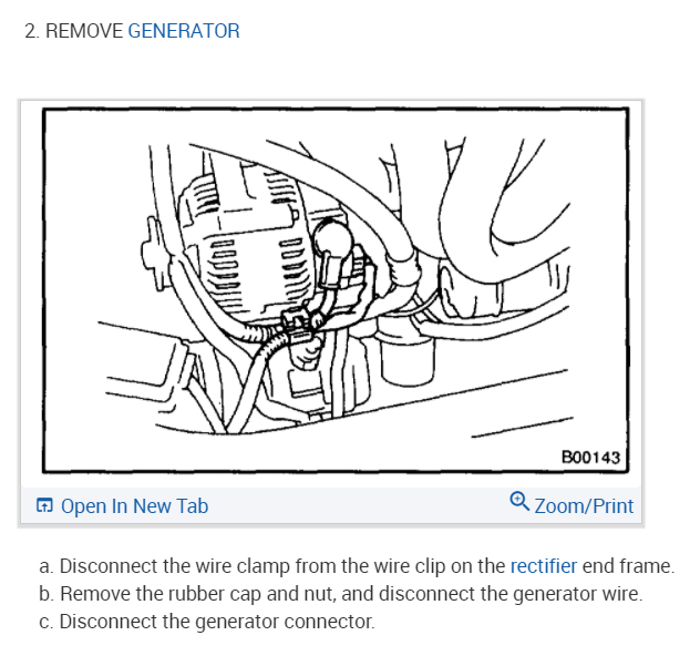

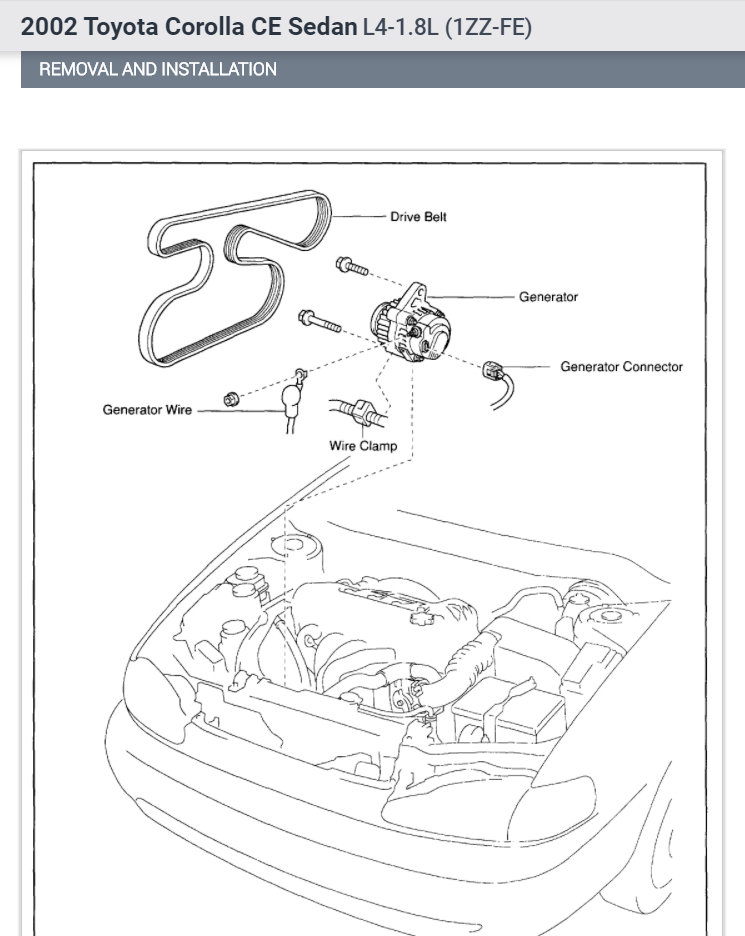

Here is a guide to help help walk you through the repair with instructions in the diagrams below to show you how to do the job on your car.
https://www.2carpros.com/articles/how-to-replace-an-alternator

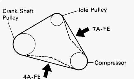

MERLIN2021
  • 17,250 POSTS
It sounds like you are missing at least the belt that goes to the bottom pulley, or the crankshaft pulley, if this one is missing, non of the others will turn, so you will not charge the battery, turn the power steering pump, or the water pump, fix the belts bfore you drive it again, if you keep overheating this motor, you will have a major engine repair to worry about.

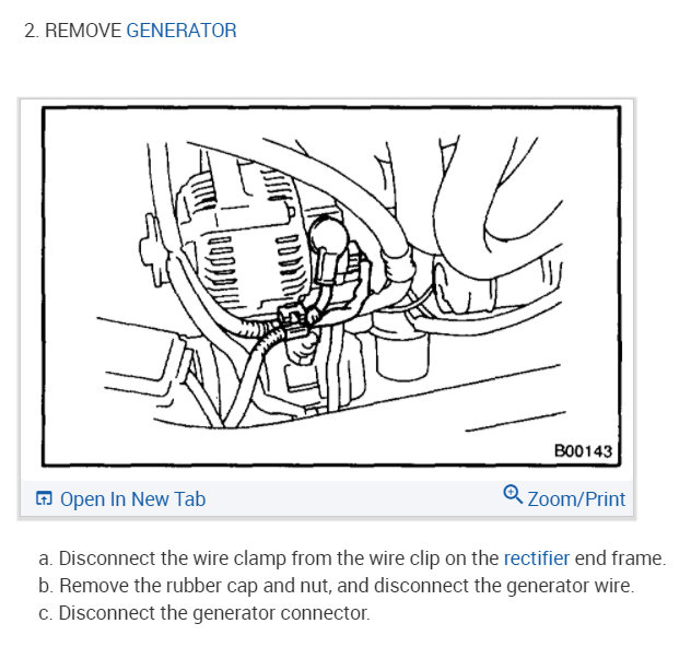

Disconnect the battery cable
remove serpentine belt
disconnect alternator wire harness connector
remove battery nut and wire from the back of the alternator
remove mounting bolts remove alternator
good luck

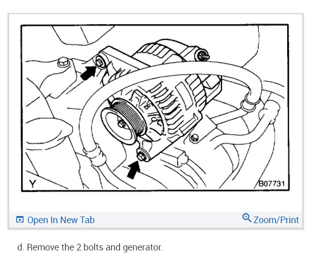

BLUELIGHTNIN6
  • 16,542 POSTS

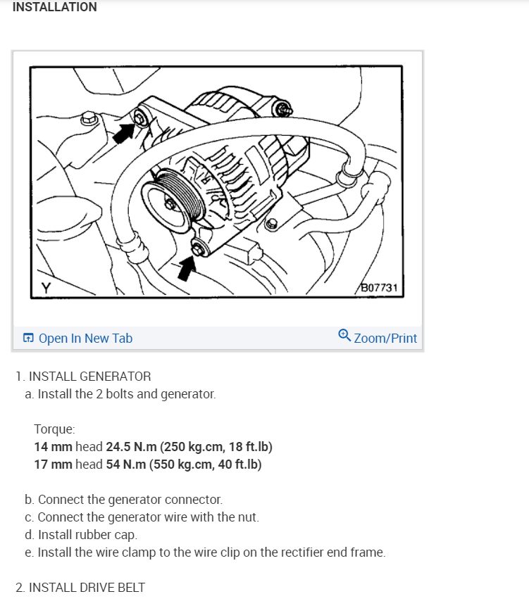

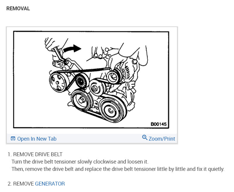

Disconnect the negative battery cable. Disconnect the electrical wiring from the alternator. Loosen the adjusting lock bolt (lower bolt) and pivot (upper) bolt. Remove the drive belt. It may be necessary to remove other belts for access.
https://images.2carpros.com/forum/automotive_pictures/261618_0900c1528006ef4a_1.jpg
Remove the lower bolt first, support the alternator and remove the upper pivot bolt. Remove the alternator from the car. Installation is the reverse of the removal procedure. When reinstalling, remember to leave the bolts finger tight so that the belt may be adjusted to the correct tension. Make sure that the electrical plugs and connectors are properly seated and secure in their mounts. Adjust belt tension and tighten all necessary hardware. Tighten the pivot bolt to 45 ft. lbs. (61 Nm) and the lock bolt to 14 ft. lbs. (19 Nm). Reconnect the negative battery cable. Reset any digital equipment such as radio memory and the clock if necessary.
