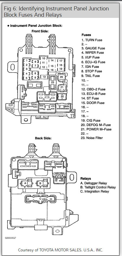

Parking lights and brake lights stay on. The only way I have gotten them to turn off is by removing the 15A fuse on the fuse panel to the left of the steering wheel. I have tried everything from all of the other message boards. I removed the DRL relay which does not turn them off, I unplugged every relay under the hood and under the dash on the driver side and none of them turned these lights off. The only thing that works is removing that fuse. The only other solution I have seen posted is that the ground wires are not functioning properly. Please advise.

I removed the 15A "tail" fuse. And to clarify it is not the brake lights that stay on it is the tail lights and front parking lights that stay on. And yeah I did unplug the brake switch with no results. I just realized that it may be the switch that controls the parking lights, but I do not know for sure.

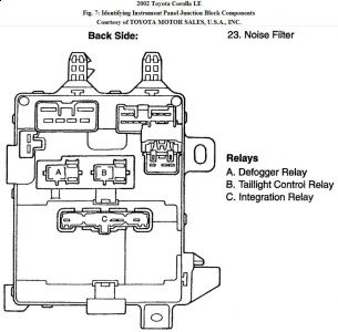

At the rear of the fuse box where you pulled the fuse, there is a taillight relay. It could be sticking and causing the taillights to stay on intermittently. Try swapping the taillight relay to see if it resolves the problem.
https://images.2carpros.com/forum/automotive_pictures/192750_FuseDash02CorollaFig07b_1.jpg
To test if it is the light switch, unplug the light switch connector under the steering column and light would go off if it is the cause.

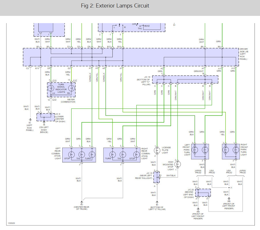

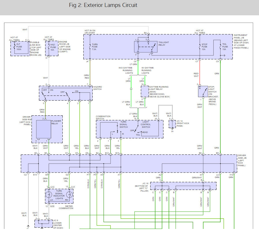

I am having same issue with all parking lights stuck on front and back. I have changed the driving lights module the two relays backside of interior fuse box,headlights relay engine compartment fuse box, and multi-function switch on column, nothing has worked. Any other ideas? Only way to turn them off is pull 15amp fuse for them.
Thanks for any help!

Are you sure you got the right relay does the light go off when you remove the relay? Here is a wiring diagram so you can see how the system works and the location of the relay.
