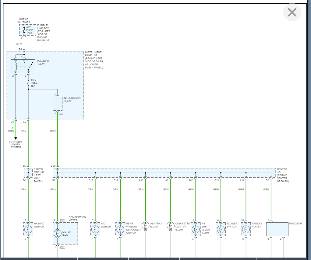

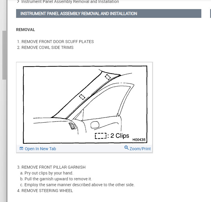

Hi I have a 2000 Toyota corolla LE, the speedometer light and gas gauge light went out, but all other gauges are working fine, would this be just an issue with a fuse?
Sunday, November 30th, 2008 AT 5:51 PM

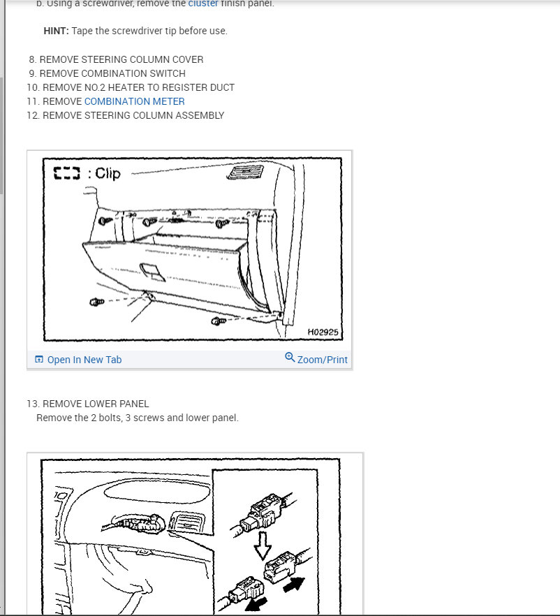

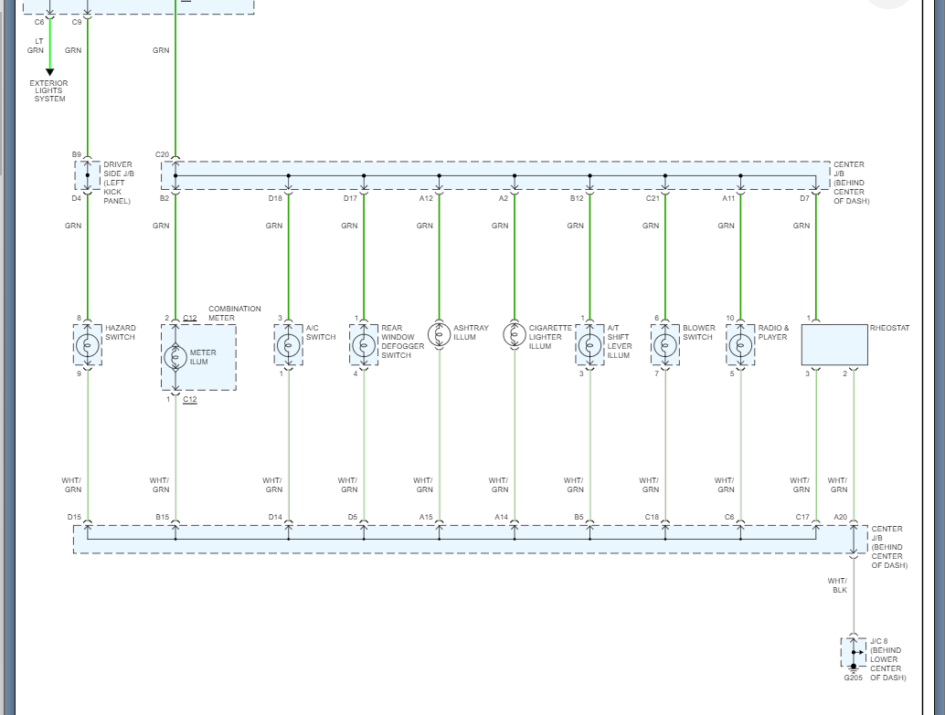

Unfortunately, I suspect we have a cluster issue. Basically, the cluster lights are run off the same fuse as the other interior lights and you only have a couple of the cluster lights not working then that is where the issue is.
I attached the wiring diagram below that will show this.

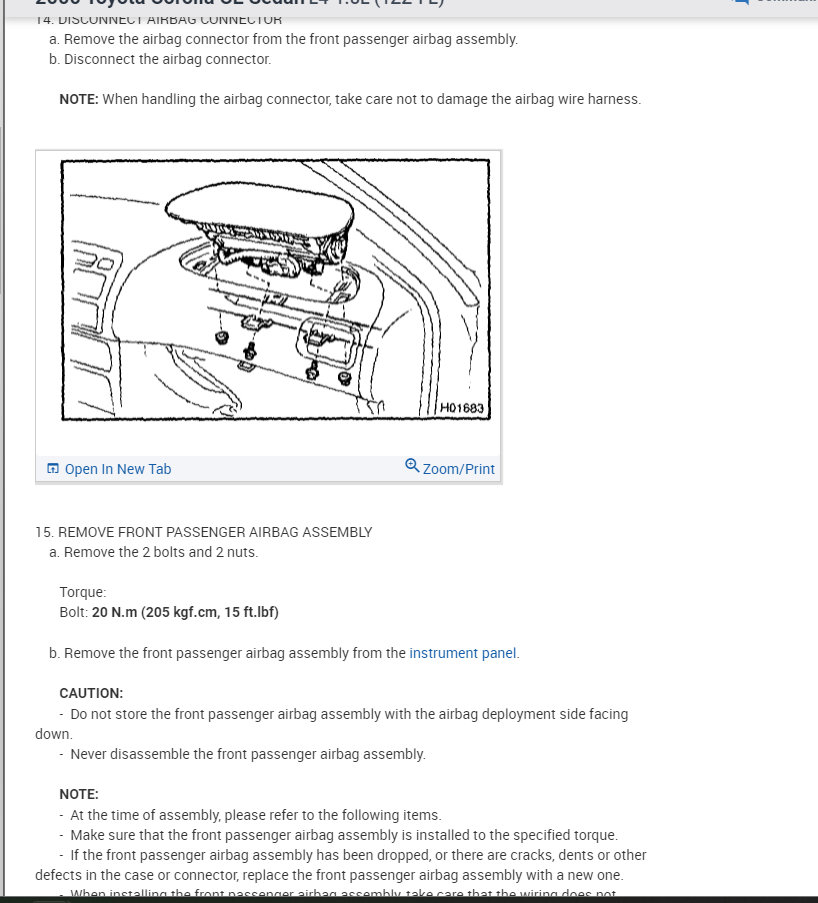

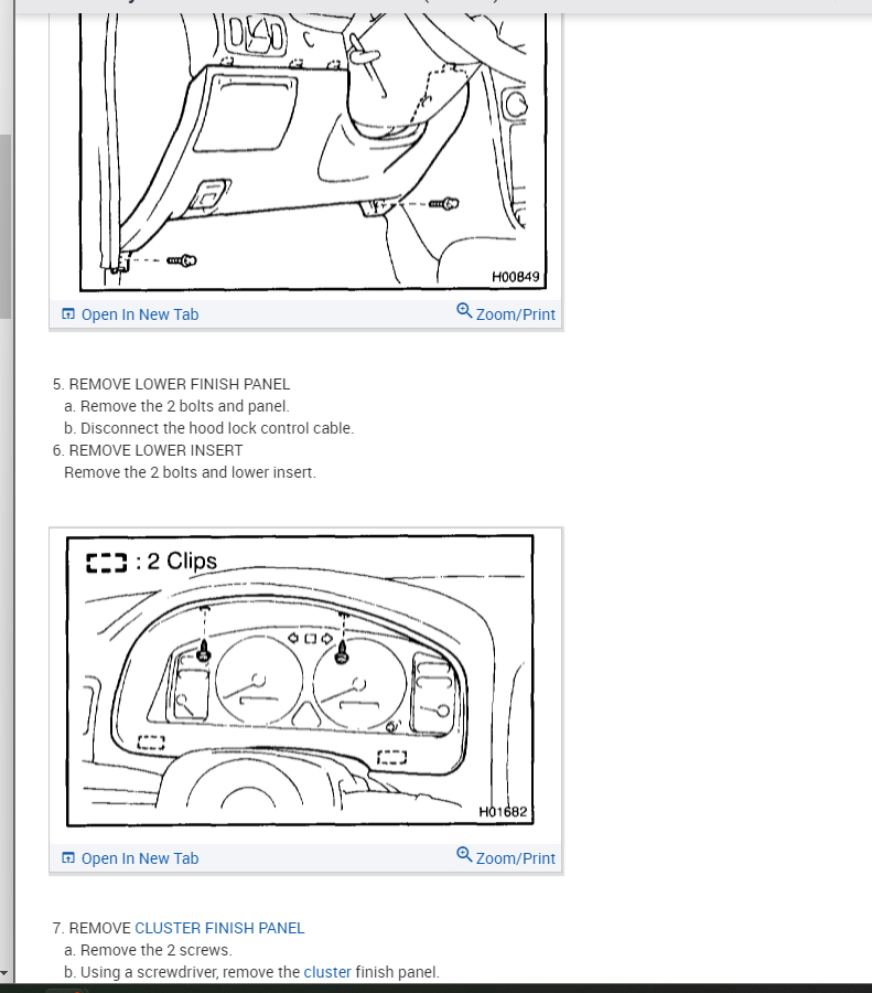

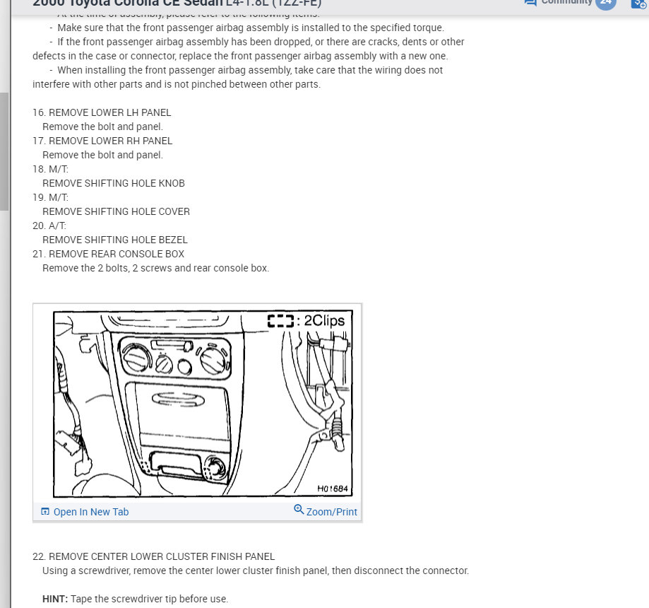

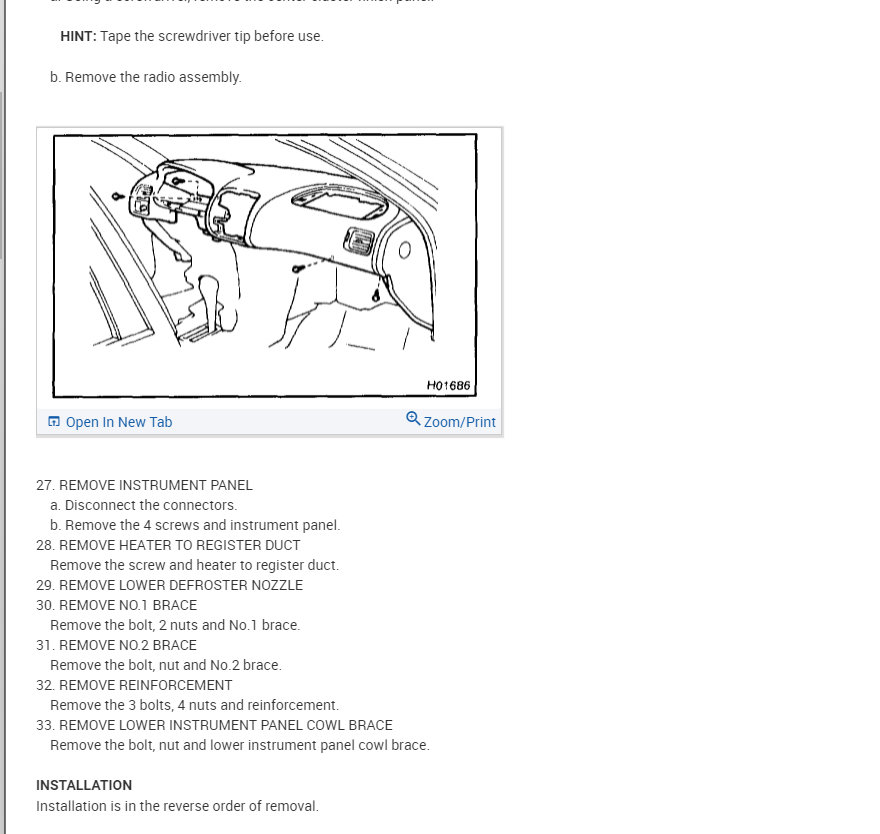

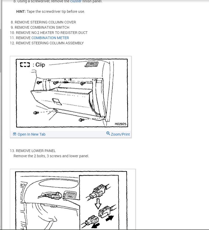

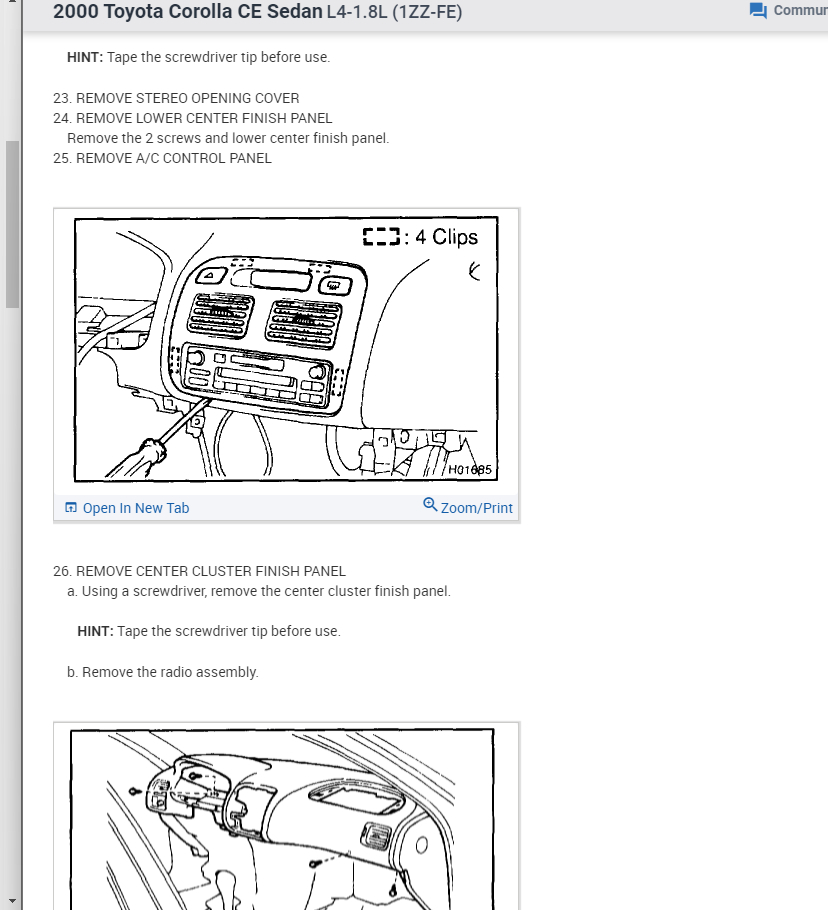

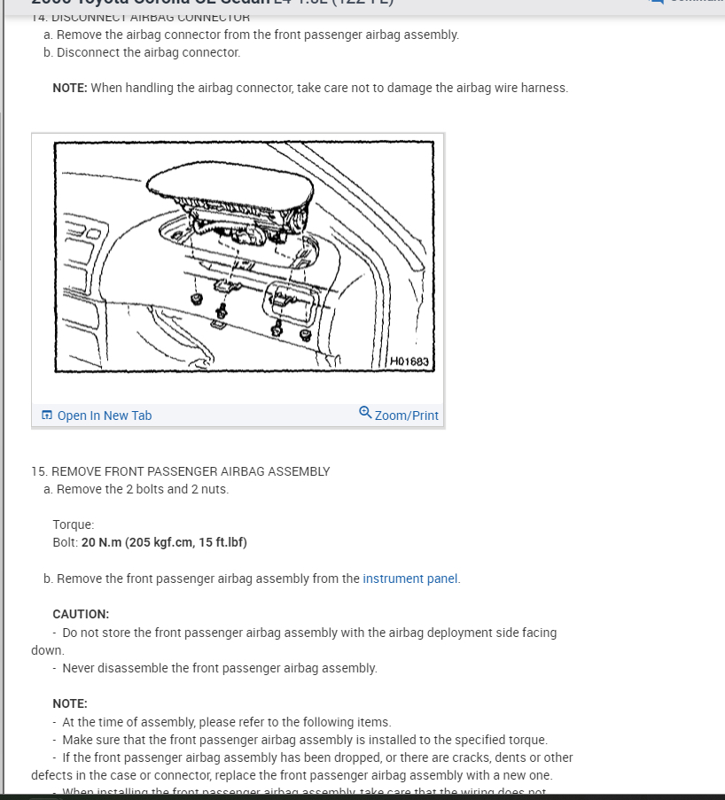

Plus, I attached the process on how to replace the cluster because I suspect we are going to have to remove it and just make sure there are no issues with the bulbs and then replace it if none are found.
Please let us know what you find, and we can go from there. Thanks
